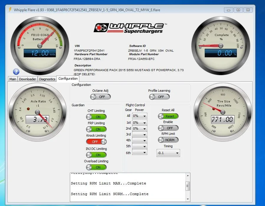

I am not sure which setting you are referring to but here is a screen shot of my flare tool when hooked to the car. I did question why the timing block is -.1. Is that normal? I didn't change it at all.

I can guarantee air fuel is not correct reading. Tailpipe sniffer is almost worthless, it's rarely accurate, especially with cats.
Power in general is down, not sure what gear and how many pulls you made as power is best on 2nd and 3rd pulls.
Octane is critical, Shell, Chevron, Sunoco.....
Always turn knock limiting off in flight control.
Did somebody flip the octane switch to on? A few do that but it's surely not needed, especially with 93.

The timing looks to not be an issue as the Rpm limiting per gear is not enabled.

@whipplesc should knock limiting always be off or are you referring to just on the dyno? I have not looked at my settings in a bit but just wanted to get clarification.

Should pick up a good bit if dynoed in 5th.. I drive with knock limiting turned off just because I have 93 in my area but I also watch for knock on my gauge just to be safe

We state to dyno in 4th gear on all vehicles, 5th gear normally results in 190mph which is not safe and will be full into cat saver mode because of the longer pull, therefore reducing power to keep cats safe.
Power will climb to redline.
