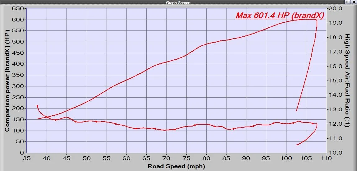

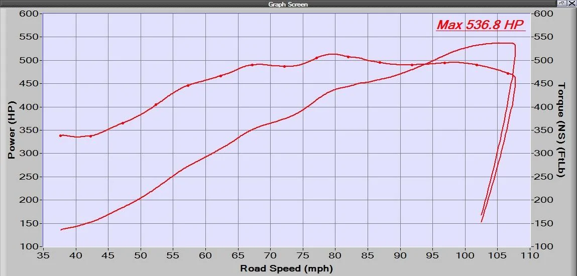

Hello Everyone,
I just wanted to share my dyno sheet from today, overall I am pretty happy with the number. As for mods all I have done is the Procharger Stage II kit with their tune (slightly modified tune) and a MBRP street catback exhaust.
For my tune I have to give props to DiabloMatt on this forum for remotely modifying the stock Procharger tune and opening it up a bit. For those of you who have a Diablo tuner from Procharger Matt is your guy to do a remote custom tune.
The dyno I was on was a Dyno Dynamics brand and I am told it is nicknamed the 'Heart Breaker' dyno because it comes in about 12% lower than a Dynojet. The software for the dyno had a "Dynojet setting" and that is what the second graph is showing, the HP numbers I should get on a dynojet. So overall the couple of safe tweaks DiabloMatt made added roughly 50 peak HP while not affecting the safety of the tune. I'm glad to see the kit is putting down the numbers it advertised.

well done mate. Yes, we use the Dyno Dynamics here in Australia, you are right, you will find the car will do the same MPH over the 1/4 with cars showing 10-20% more rwhp on other US dyno's, the real dyno is the black 400m one.

Looks about right .. My p1 with a smaller pulley and custom tune was 604/561 .. A6 car dynojet dyno ..
