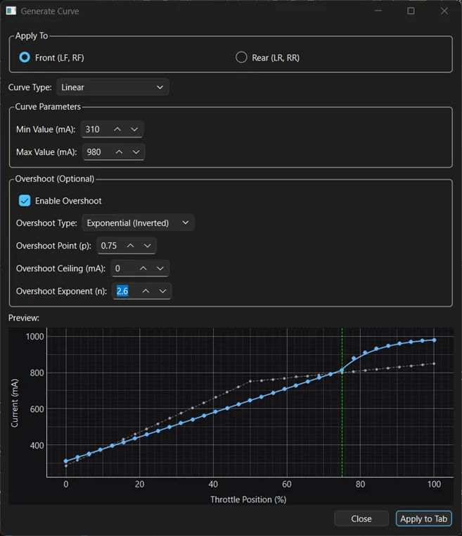

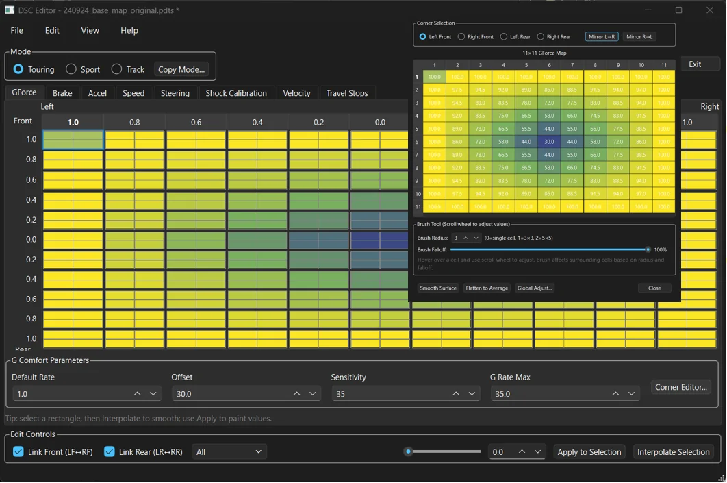

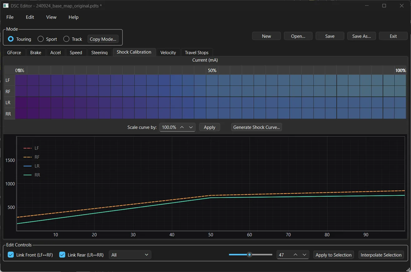

I'm going to put this in this forum because I'm thinking this is where it will be most useful. I've spent more than a year of my spare time working on reverse engineering the DSC .pdts binary file format and writing a better editor for it using Python and a more modern GUI. I'm pretty happy with the result and actually find it useful versus the junk VB program that DSC provides. With my program you can actually edit the numbers in the cells, (imagine that!!!), have color spectrum for the values in the tables instead of grayscale, and charts that plot the curves for any of the 2D tables. I added a "corner editor" for the G-G table that lets you work on just one corner at a time, then copy the settings L->R or vice versa. The shock calibration tab has a curve generator that you can develop a linear, exponential, S-curve, or inverted exponential percentage vs. mA curve easily w/o having to enter hundreds of individual points.
You can copy the settings from one mode to another, either for the current tab or all tabs. You can easily switch between modes in any tab.

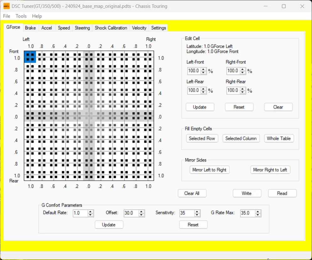

For reference, this is what the G-G tab looks like in the original program:
The really fun part is to change one thing on the table, you have to pick the cell, change the values in the scroll boxes in the upper right, then hit Update, then pick the next one. That's the same for every friggn input in the entire program, and it drove me crazy. At one point I got pretty good at the Fill Empty Cells feature which does a linear interpolation on all cells that have a value of 0.0 in them, but it didn't take me too long to figure out I don't want linear curves in the settings. Anyhow, sorry, no ABS. Maybe next year.
