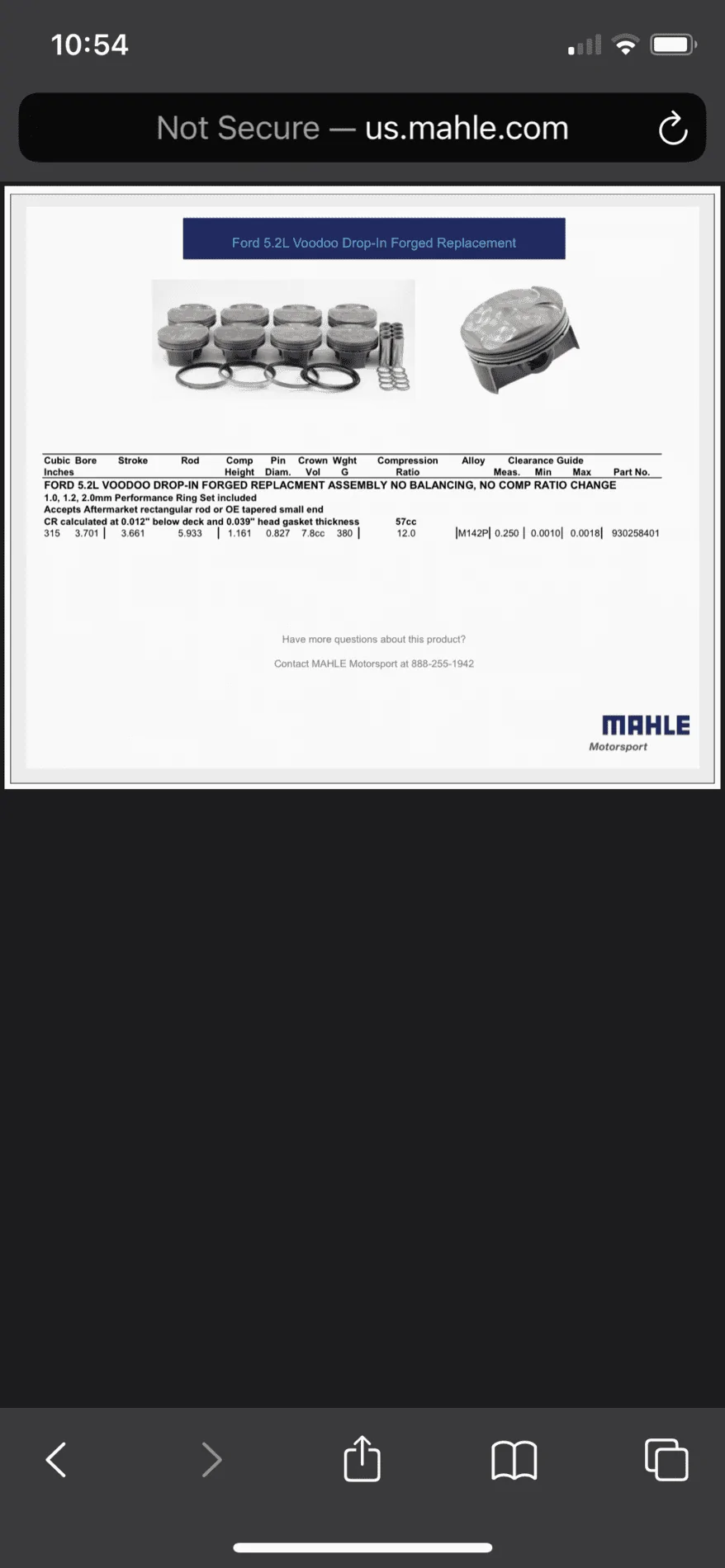

I noticed Mahle just released a drop in piston for the Voodoo. I was wondering if anyone has had experience with these and boost? I’d like to do a twin turbo setup on my ‘18 (gen1 voodoo) and i’m looking to make it as reliable as possible considering a rebuild is in the $20k ball park. Would this help strengthen the motor? If they only make a drop in piston, does that mean they aren’t worried about rods? Is there anything else in the motor I could upgrade for boost without having to rebalance the motor? Maybe valve springs, drop in pistons, and the obvious opg/cs?
