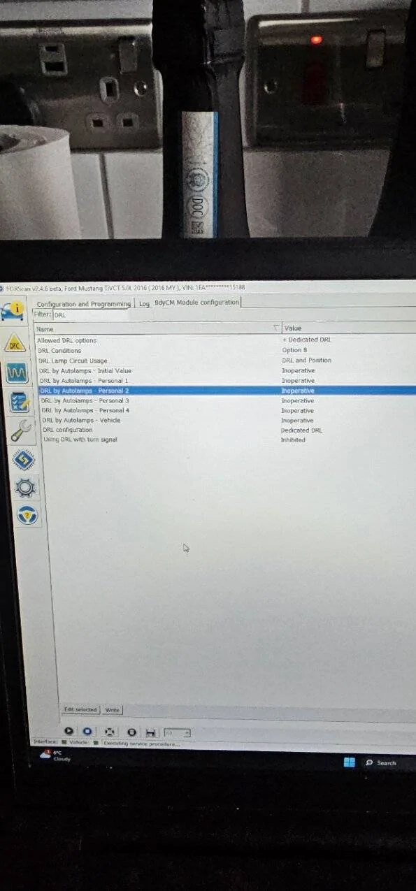

Hi Rod,
My Mustang is a 2016 UK Version so it did not have the tri-bar LED, so i bought a set of US headlights with the LED Board inside etc etc. ive connected it up
the ballest are 35W now and now the UK 25W so abit brighter :-)
Green from TRI_BAR Led goes the old DRL from the Fog lamp
Yellow Goes the the Side lights (parkLights)
all come on as they shuold apart from when i start the engine up.
ive since found out the the the System has a detect on if it dectects a higher pull on the system them will go off.
the system is different to the US version of the car
so thats what in thinking. there must be somthing in forscan to may be program it.
if anyone know how to prgram it in Forscan that would be a great help
other than that ile need to test it again but remove it from the DRL FOG connecter will keep you posted on that
