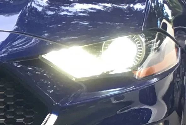

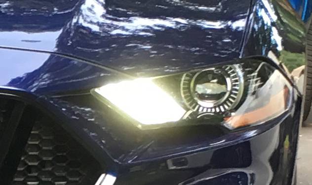

As I said above, the tri-bars are not the DRLs and are always on.
The DRLs are the center of the main lights. The DRL On/Off function in the menu only applies if you have the headlight switch in one of the On or Auto modes, are in gear with an automatic, or have released the parking brake in a manual.
  • If you leave the headlight switch in Off, the DRLs are always off, regardless of the Info Menu setting.
  • If an AT is in Park, the DRLs are off, regardless of the Info Menu setting.
  • If an MT has the parking brake is set, the DRLs are off, regardless of the Info Menu setting.
It's the stupidest implementation of DRL control that I have ever seen, but, hey. I didn't design the effing thing, I just drive the bastard.
DRL Off:
DRL On:
