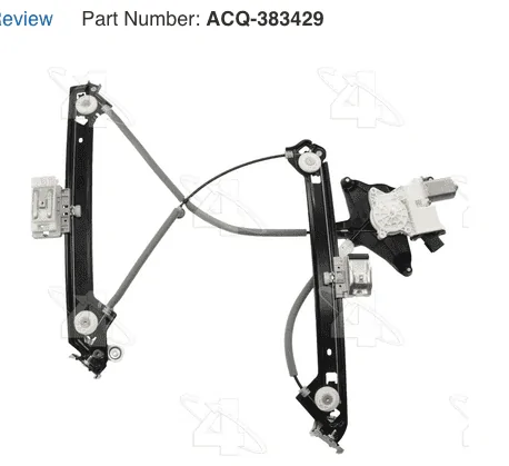

I don't think they could have changed just the motor, today's power window. Is a complete assembly as seen here.
Without knowing for sure you could be getting some spoon-fed BS.
Common part, simple to change

I see. I’m wondering if they maybe didn’t tighten one of the bolts correctly or something on those tracks and it’s maybe gotten loose with driving. Guess I won’t know until I take it apart.
