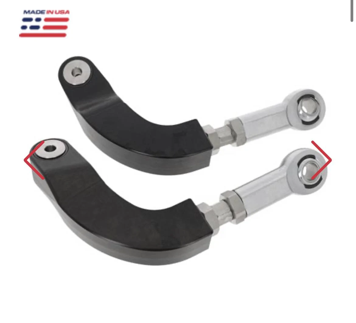

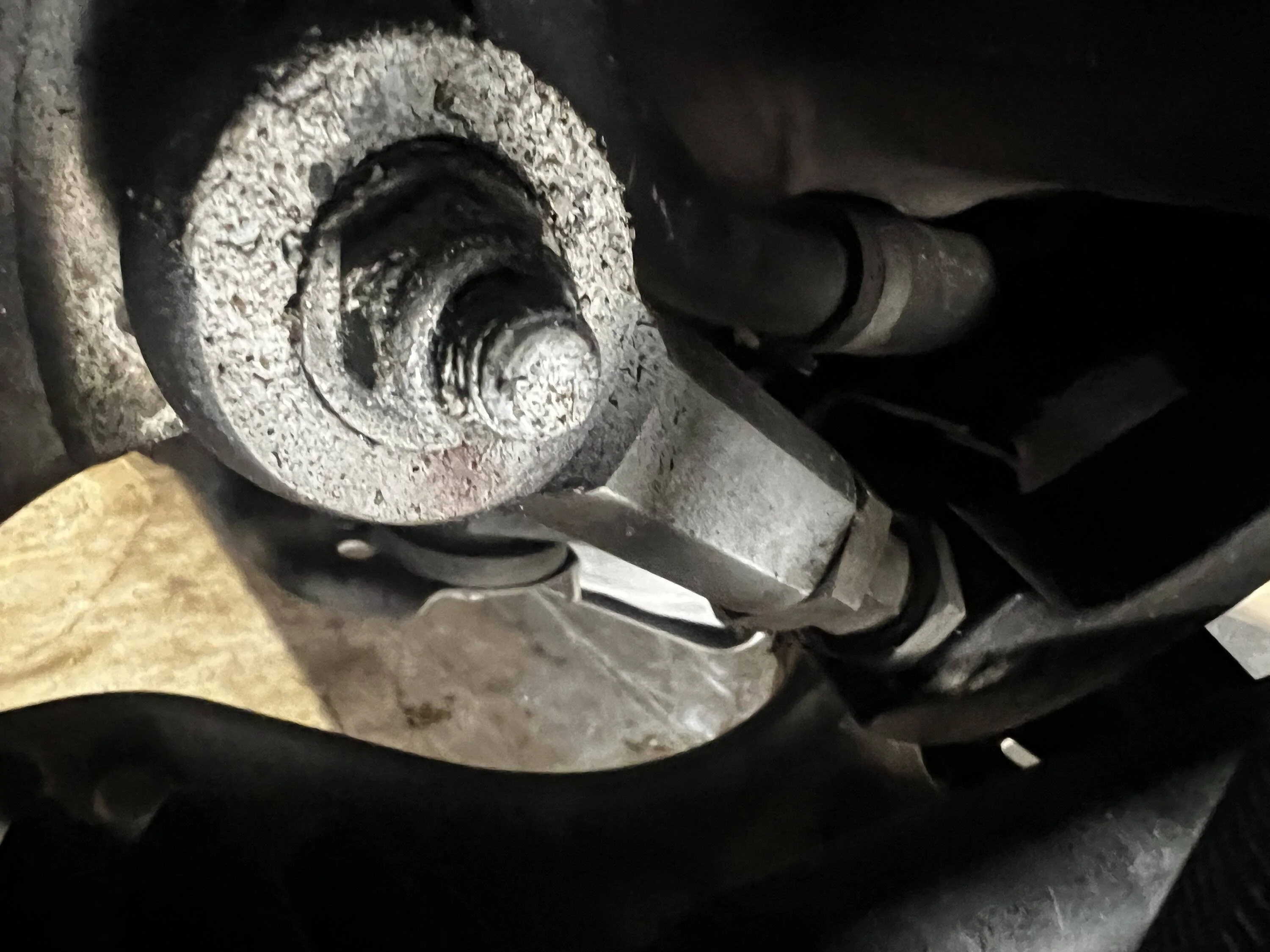

Hey so I’ve been running UPR Rear camber arms for a while now on my car and I’ve been getting a loud knocking noise over time, check the camber arms and the heims joints or super worn out, I’ve been putting grease on them to get by and i don’t drive the car much, can anyone guide me into getting new heims for this particular part? Such as the threads on the female end and the sizes? I’m not sure if i can just order just that so any pointers would be awesome.

I'd probably order the replacement straight from them.

Been through the same thing with my BMRs, replaced the heim joints once already and 2 months later they are starting to make noise again, so I am waiting for my Pedders arms to arrive and trying those out.

make sure you check that the camber arm to chassis bolt is tight. it’s supposed to be 86lb feet. its difficult to reach with a torque wrench. my stock arms knocked when i didnt torque them down tight enough

Yeah i tightened them more and helped get rid of the knock slightly.
