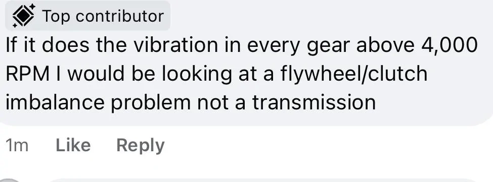

Please list off as much as you may know that might be causing this vibration:
Vibration in shifter/trans.
Can’t shift past 4k rpm in any gear. It’s so bad.
The vibration is so bad, that when I try to shift, it’s so misaligned that I can’t find the tunnel to shift into the next gear.
Someone in a FB group said this

Possible carrier bearing.

The dealer removed the driveshaft a few months ago when installing my new clutch. But Thank you for this. I’ll look into it. I never had any issues with driveshafts so I didn’t even consider that it could be the problem
