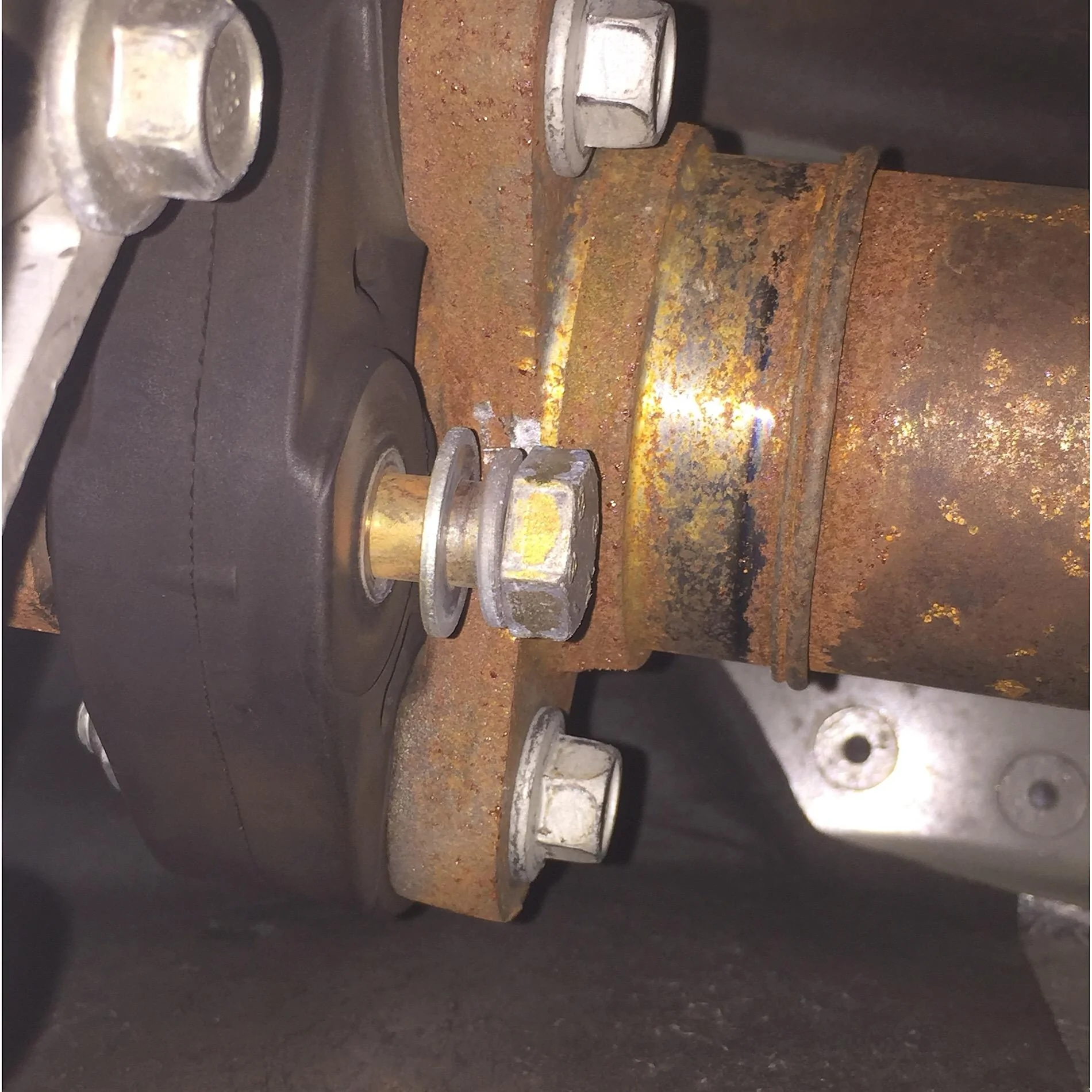

Has anyone changed out just their flex disc to an aluminum one using the OEM driveshaft.
Also has anyone ever snapped one of the bolts that mounts the flex disc to the trans output shaft.

Is that guibo damaged? It looks like it has tears in the surface area (looking at pic, face of guibo).

I see what you are talking about in the pic, at first glance from underneath it didn’t appear it was so I went and looked again and it isn’t torn. What you are seeing are the dimples on either side of the bolt hole.

How did the bolt break, where you putting the stock DS back in or removing it to install an aftermarket?
As for a metal guibo replacement, I don’t think anyone makes one for the S550. I think the reason it is rubber is to absorb NVH and also if in a bad collision it’s design may allow it to break away.

I did a hard pull from a slow roll in 2nd gear, felt like the shifter moved more than normal and I heard a noise, right after that I started getting a vibration under any load and deceleration.
I know the aftermarket shafts have a billet aluminum one, I’m fine with the rubber one and was also curious about a poly one but haven’t seem to find anything. The Giubo isn’t or doesn’t appear to be damaged so I think I’m good there. I just hung up with ford and ordered all new bolts.

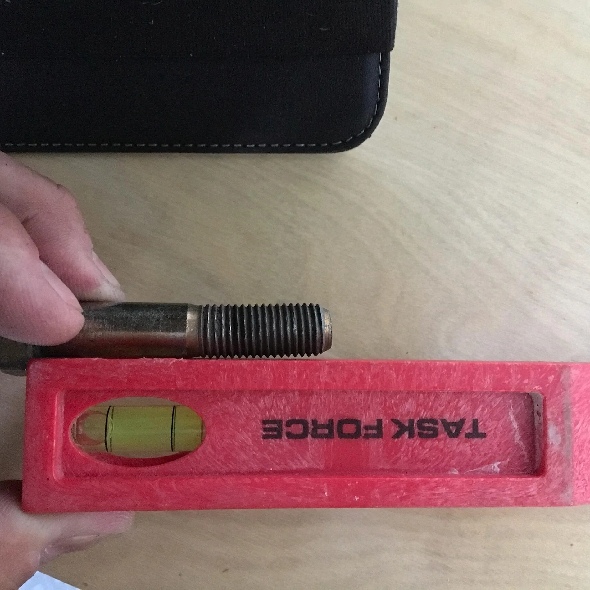

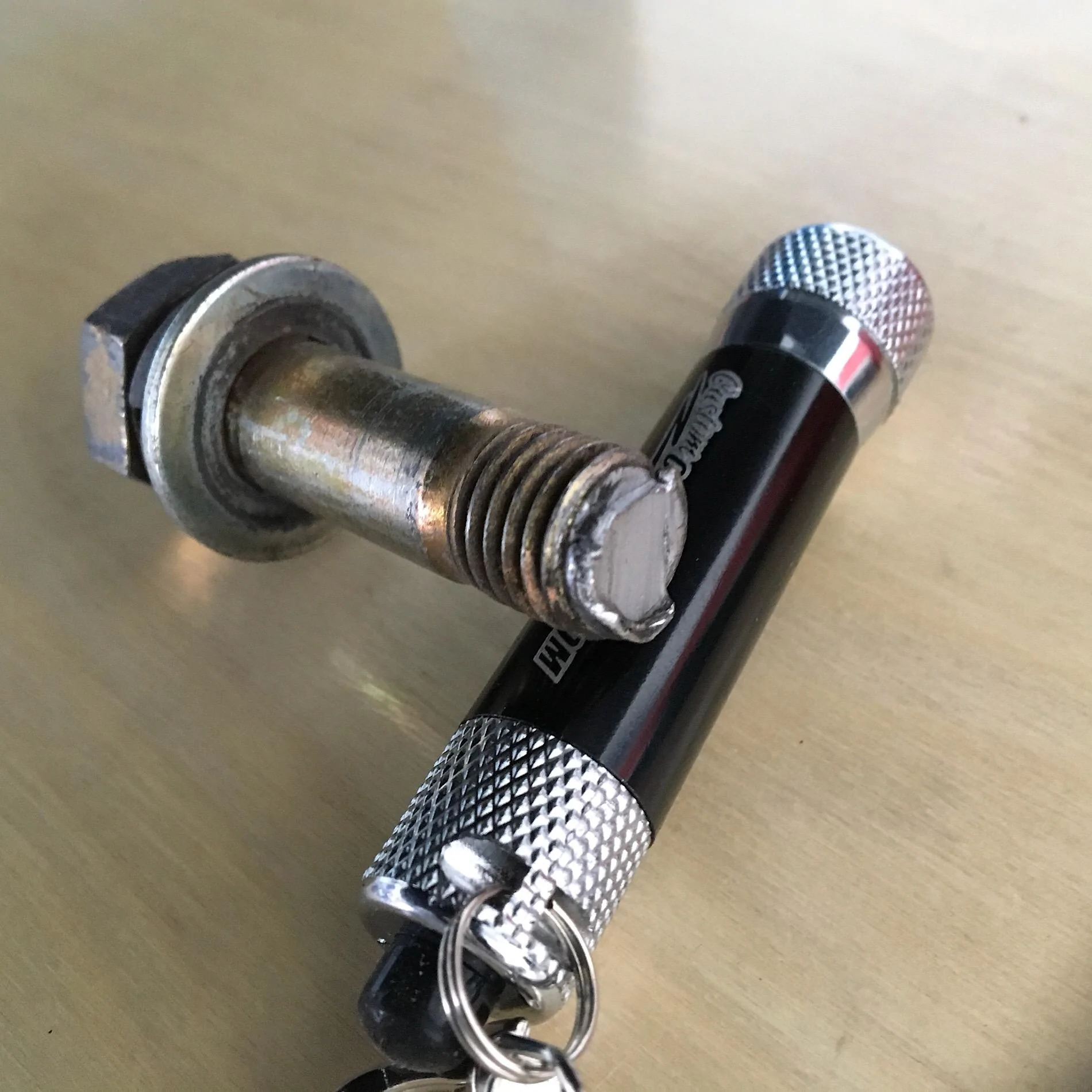

Just to be clear, all the bolts go through spacers in the Giubo, none of them are threaded into the Giubo. The grade 8 yellow zinc bolts (one that broke) thread into the trans output shaft. The grade 9.8/10 bolts go through the drive shaft flange, through the spacers in the Giubo and have nuts that tighten against the other end of the Giubo.
So the other 2 grade 8 yellow zinc bolts were fairly loose and one of the last 2 were bent as seen in the photo. The 3 grade 9.8/10 bolt and nuts were tight AF.
