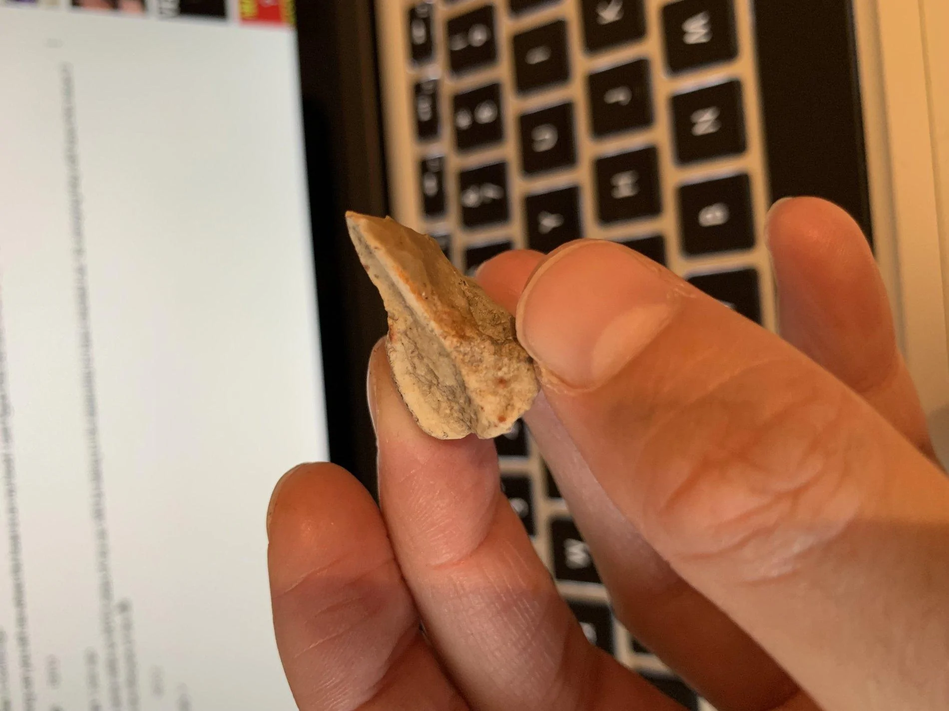

Driving me madder by the day, I spent some time tonight with a torch in the passenger footwell, frantically poking around, no joy. Literally 2 minutes on youtube, and I found a USA owner who has posted the exact same noise () Turns out his issue was one of the plastic push pins holding the side skirts in place, so down I went to investigate...not easy to see where the pins go in, but I didn't need to because I found THIS LITTLE FUCKER poking out of the side skirt! Sort of inside it if that makes sense. God knows how it got in there, because I had to pull the plastic down to get it out...
Anyway, fairly confident that's it based on the noise location. Interesting that it sounded like it was coming from inside despite being outside. Will confirm after my morning commute :)

Rattle has definitely gone!
