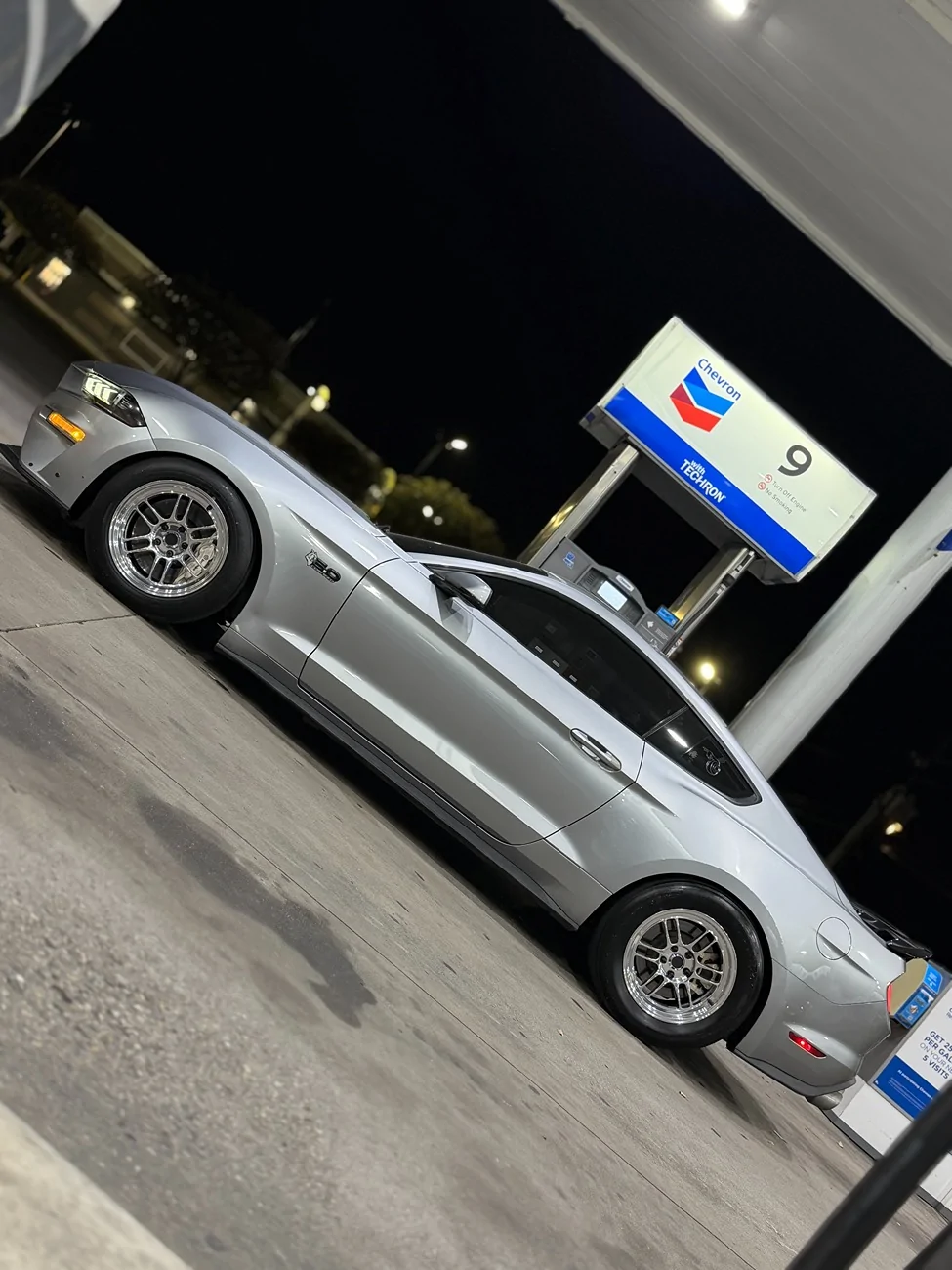

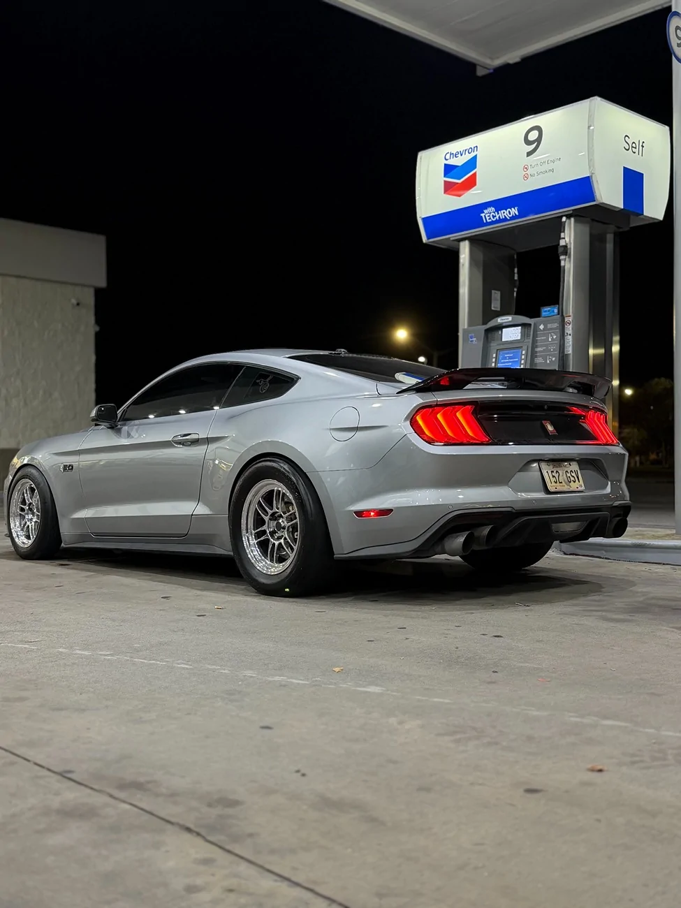

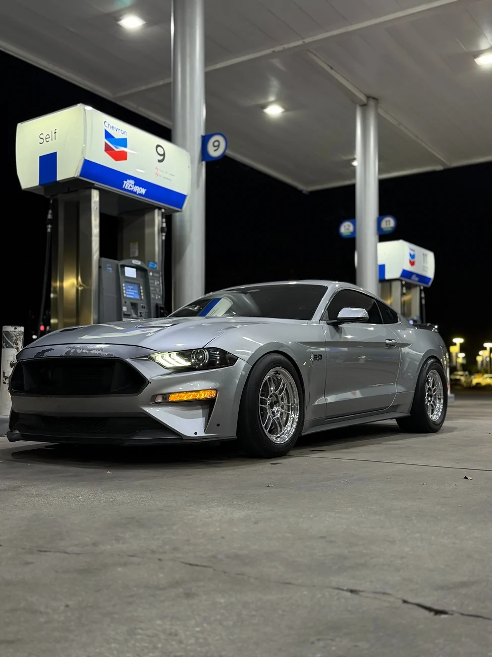

been running 17s all around on my car with all my wheel setups. This is my latest
