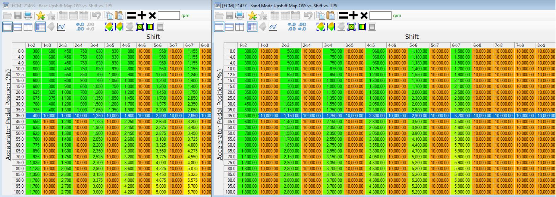

FYI this is base vs drag shift points. Drag gets rid of skip shift, doesn't allow shifts above 7th unless at WOT, and modestly increases part throttle shift points.

This does not seem to be an issue, it's just the way drag mode is designed. As the name implies, it's for racing in a straight line accelerating from 1 through the gears or on the highway thus keeping you in the highest gear possible at all times. It's not really meant for you to be driving around normally.
