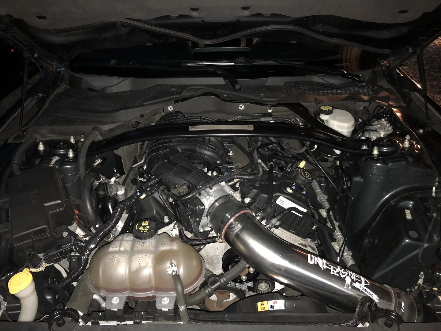

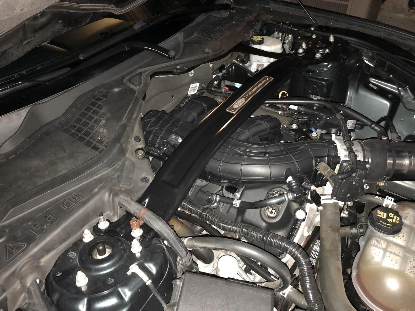

Got my Strut Tower brace installed tonight along with my new MPT 93PRX (an upgrade to my previous 87PRX)
motor mounts or spacers? looks nice I have the same one, not installed yet. u do the cowl brace too? I did install that.
Motor Mounts! I do not like the idea of using spacers for the strut tower brace.
And I do also have the K Brace!

Looks like both motor mounts and cowl brace to me.
How hard is it to install motor mounts?
Actually very easy considering what they are. Both mounts can be accessed from above. So 2 jack stands, a floor jack to jack up the motor one side at a time, and a long 3/8" extension are all that's needed to install. Took me about an hour to install both.
