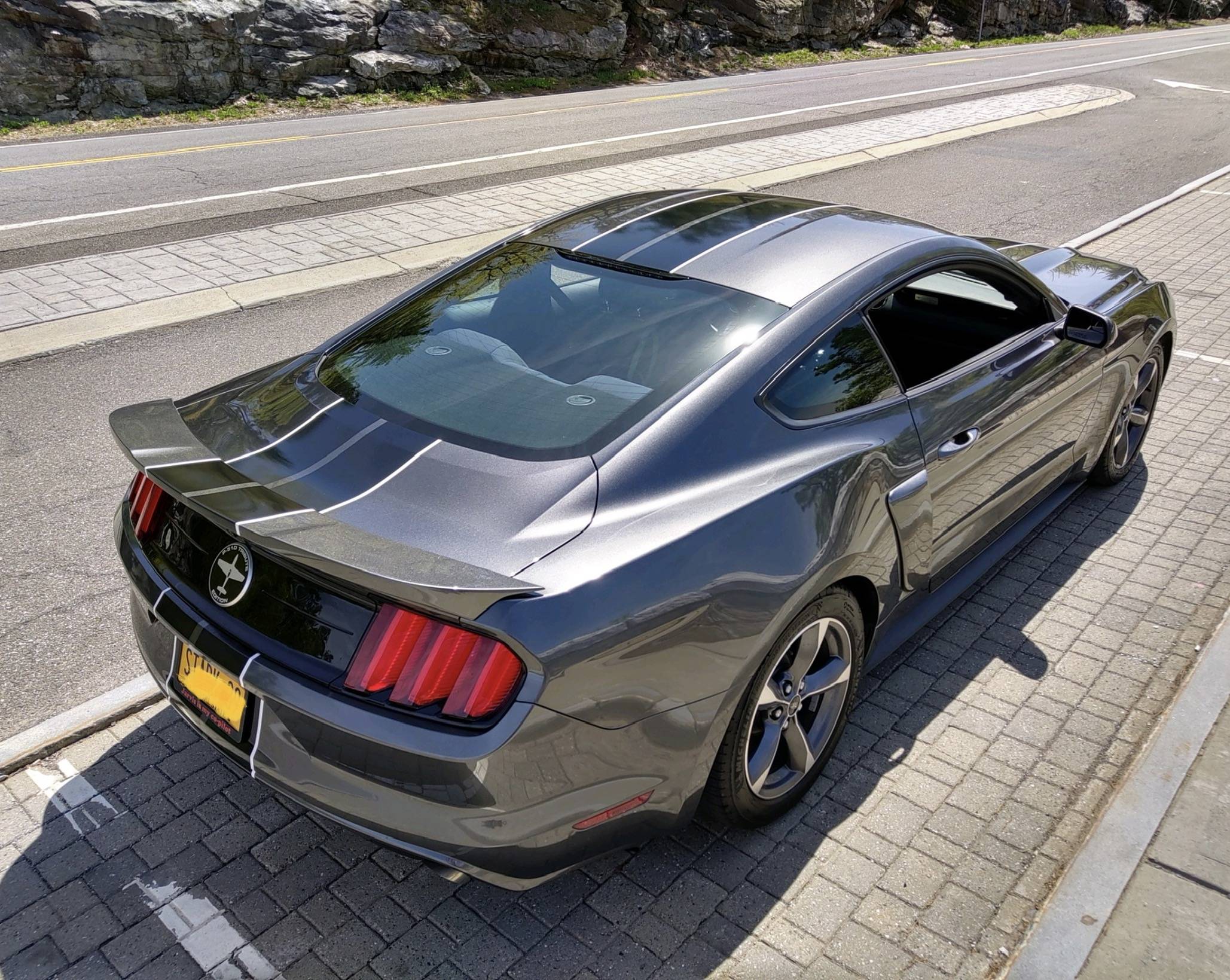

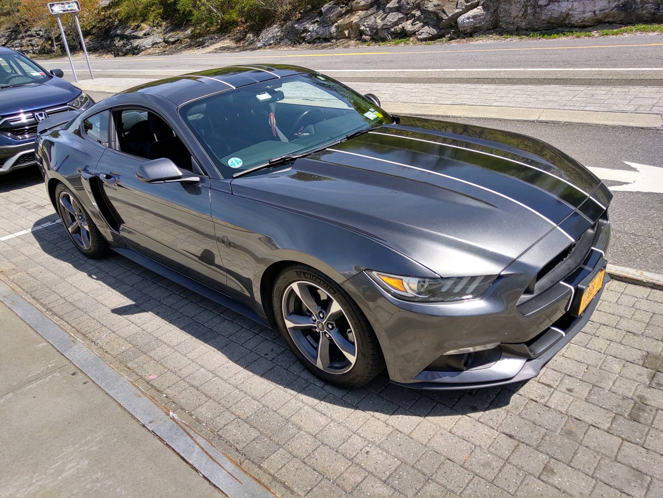

How much HP can we expect to see Normally Aspirated in our V6’s? Including mods such as a tune, exhaust, headers, CAI, CF Driveshaft, and running 93 octane? I’m curious as these are the mods lm thinking of doing on my 15 V6
