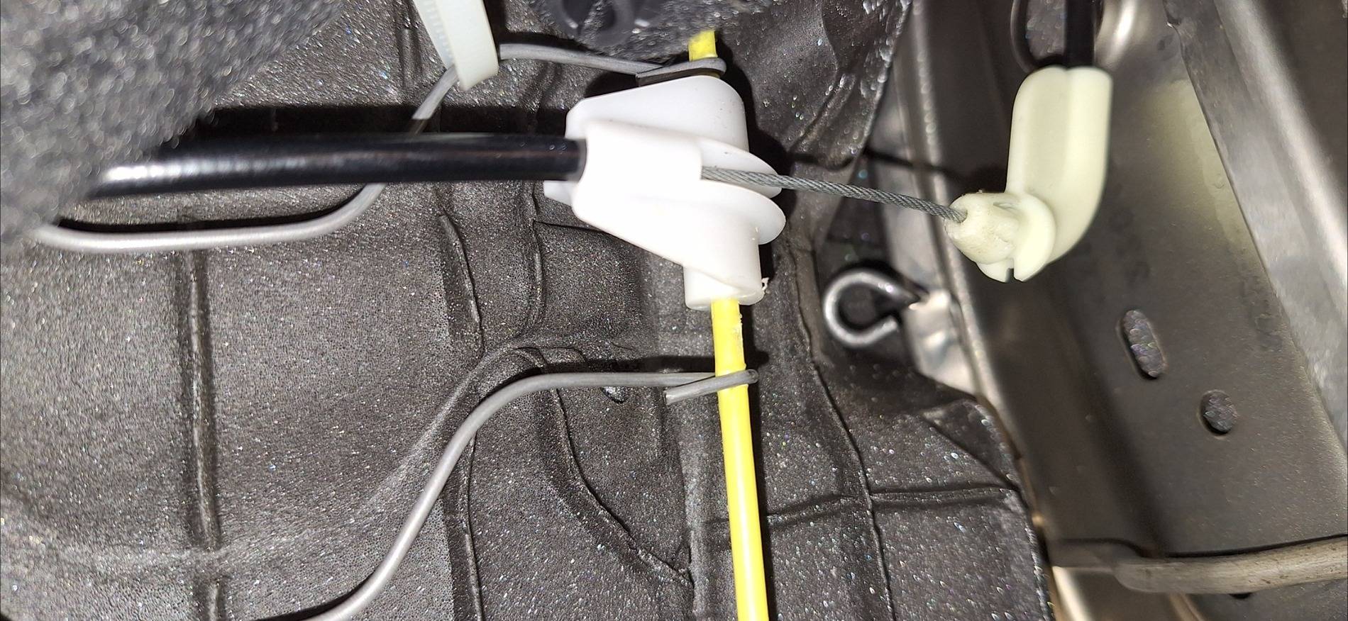

... I've effectively removed what was poking in my back this whole time. This means the lumbar is not operational now. Getting into the back of the seat is a breeze, I worked from the back seat upside down and removed two electrical connectors and then the elastic bands holding the back fabric. With that away a trim pry tool will get two plastic push pins out then the back flap opens right up. Lifting up the flap and looking for the plastic pin that is seated in the metal hoop (see picture). With needle nose pliers, I squeezed the tabs together and pushed it out of the hoop. Once you release this, it releases the tension and you can see the sides of the lumbar retract. I connected the motor again (will it pop a code if disconnected?) and will disconnect the lumbar switch itself. Check it out.
HUGE difference!

Victoryyyyyyyy!!!!!
It's done! And I only had to drop about 175 GD's and MF's along the way.
I'll add some to what DrZed has already posted. HUGE thanks to him for being the first of us to break this ground AND share it with us!!
Some helpful hints:

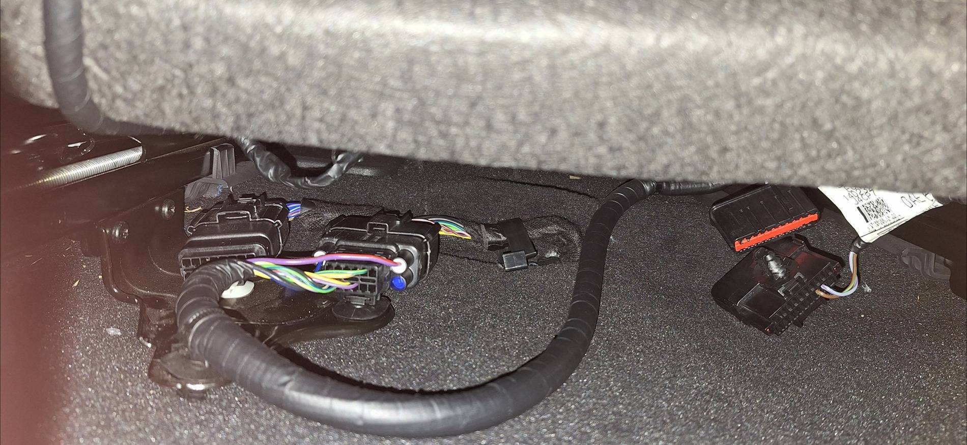

1) Cut the elastic band under the seat that is closest to the door. The electrical connector up above that it's wrapped around is a nightmare to unhook from the bottom of the seat (it doesn't need to be unplugged anyway, and you don't need that first elastic band either.) This will save you an hour of cursing and many cuts on your hand/wrist. The second elastic band, the one closest to the transmission tunnel, is plenty adequate to keep the seats bottom flap up tight once you're finished. You'll see when you get there..
2) Only unplug the connector to the far right that's attached to the bottom of the seat. It's the one closest to the transmission tunnel. (I'll attach a photo of it) No others need to be disconnected or left unplugged afterwards. That one connector controls the lumbar motor and/or the lumbar switch on the side of the seat. I'm not sure if it controls both the motor and the switch, but with it unplugged, the lumbar will no longer work. Perfecto! Once you've unplugged this connector, you'll be able to pull the elastic band off the electrical connector's post that it's wrapped around. Once that's done, you can lift up the flap and you're now into the back of the seat!
3) Don't worry if you mangle the two bottom Christmas tree push pins that attach the inner fabric to the bottom corners of the back of the seat. They will still work just fine when you're finished, and nobody should ever see them again once you lower the flap back down. *knock on wood*
4) Pinching the small plastic fitting on the cable and pushing it through the back of the metal hoop that it's seated in is easiest done with needle nose pliers. Getting it all the way out of the metal hoop is tricky, and you'll be mad, but keep fighting! You're nearly there! Make sure you get that plastic fitting and cable completely free of the metal hoop or it will get pulled right back in when you sit in the seat. (Ask me how I know)

The two connector's on the left that attach to the floor can be left alone. The connector to right that you see unplugged is the only one you need to unplug. It's a bit of a pain to pull that connector off the bottom of the seat, but going at it by laying across the back seat from the passenger side helped me get the right angle. At 37yrs this acrobatic shit is getting to be too much. But oh well..
Here you can see I've got the cable and plastic fitting totally free of the metal hoop. This is what you want it to look like.
Overall, this was a bitch and a half. I'm not going to sit here and blow smoke up anyone's ass about it. However, in the long run, for my sanity and the health of my spine, it had to be done and was well worth the 2.5hrs of struggle. I would absolutely do it again. Just not today. I need 4 ibuprofen now...
