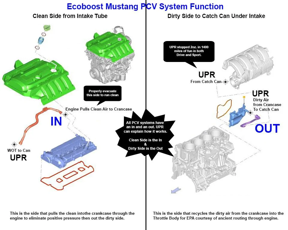

Just a heads up.
If you look at the design of the system, the things you're describing aren't entirely possible. The PCV outlet at the top of the valve covers and the amount of vacuum will be the same with a can installed. The amount of oil/spray it will suck from the lifters will be the same. The oil is going to be there either way, and the can just gives it a place to go.
My PCV system is still stock - I took the turbo inlet off the other day and there was already a bit of oil present after ~1300mi. The amount of blowby I've seen in the manifold of my v8.. wow.
The oil spray is there because the system under boost forces oil to come out both side because their is not way for the system to properly evacuate during WOT and is common. That is the reason for the Wide Open Throttle line to eliminate the side of the system that is supposed to be the in from blowing boost out when it loses vacuum under WOT.
So the theory and function you describe is accurate and normal without giving the PCV system a way to maintain vacuum and not boost under WOT blasts. That is the reason for the Check Valve on the TB to stop boost from entering and has a strong vacuum source during WOT.
I know it's a bit hard to grasp, but this is what we have learned and have extensive experience with Ford Tech's and Engineer's that have also installed and use our system and have seen how good the results are with the UPR Dual Valve Kit.
Snake Oil is something I thought as well when I was first dealing with this type of system a few years back. So I am always here to share the same reservations and I called ( BS ) also and did not think about anything other than sales pitch or profit.
Then I started developing the systems and also found these systems to be far less profitable and than our single catch can system with much more basic internal function. I will not try to pitch some ridiculous notions only things that we experience.
We might offer a clean side separator to for the connection on the valve cover, but currently the system keeps tripping the vacuum pressure sensor on the line and has not showed any buildup with the WOT system installed.
Either way I will always steer our products into the best functioning and never allow the profit to sway our mission. Which is today's business is crazy :crazy: but I want to upfront and earn everyone's trust.
UPR has both the 2015 Ecoboost and the 2015 GT so our testing has been very good. The GT has collected about 2.5oz-3oz in the first 2000+ miles or so with my Fiancee driving it normal and not my son or daughter with the led feet. LOL
Last thing to add is if you let a catch can overfill the only thing it will do is the same as not having one. It won't create any other problem as we have tried it on a 5.0L F150 and a few mustangs. So other than the fact a catch can has to be monitored. It's no different than changing the oil and taking a minute to service your catch can. But that would be like brushing your teeth and not flossing, YUK.

The Single Valve catch have no WOT line.
Why should we believe these things are "catching" oil and not actually just sucking it out of the crankcase, especially at the large quantities advertised?
The data and logic behind it is the fact that the UPR Single Valve Catch Can does not have any additional Vacuum or WOT line and it catches a ton of 2.5oz to 4oz+ depending on the weather and heat the vehicle is subjected to.
Many of the catch cans on the ecoboost started out without WOT lines and caught an enormous amount of oil because they are boosted and force the oil out of the crankcase. Where a traditional 5.0 is not and they push a lot of oil
through the PCV.
Either way the thought of being lumped in with some of the seedy profiteers trying to exploit unsuspecting enthusiasts by selling fake or doctored cures is
nothing I will allow our reputation to get mixed up with.
What you give, you will eventually receive....I have a great family and no time for nonsense so I always build a strong foundation. This type of business would erode it over time. I'm not here to let anyone down.

Hi Joe,
Thanks for the routing diagram. I'm not clear on installation though. Does the "out" side require a plate to be removed from the engine during installation? How about some installation instructions for clarity of the difficulty of installation?

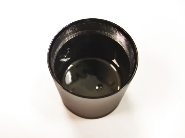

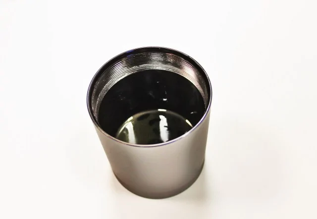

Quite a bit! Check out our PCV catch can after 300 miles of road use and a handful of dyno pulls.
This can (PCV side) has quite a bit of fluid, which appears to be a mix of both fuel and oil. The valve-cover breather can was fairly dry. We are continuing our testing to see if any additional accumulation builds up in either can.

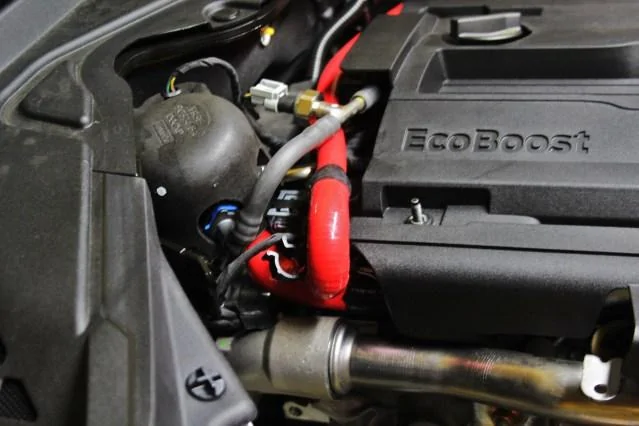

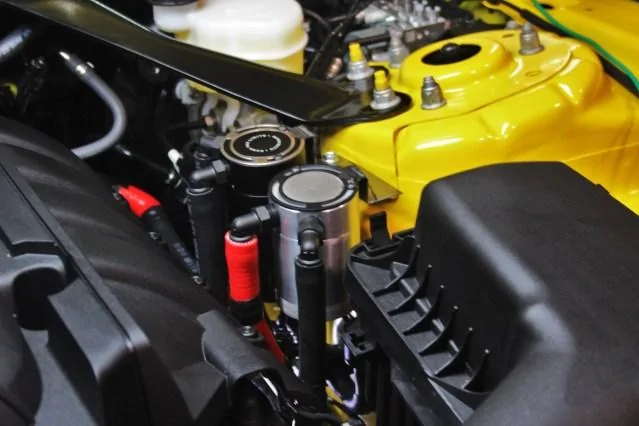

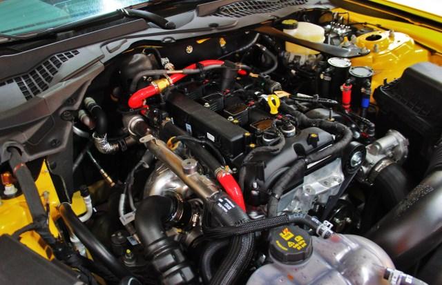

Check out how our prototype lines were constructed!
Mishimoto 2015+ Ford Mustang 2.3L EcoBoost Direct-Fit Baffled Oil Catch Can System, Part 3: Line Routing and Final Prototype
Mishimoto 2015 Mustang EB
Last time, we selected the mounting brackets for our dual can setup. As mentioned earlier in our thread, we would be performing real-world road testing to determine if both lines accumulate byproduct. Our next task was to develop and install some lines for testing.
Line Fabrication

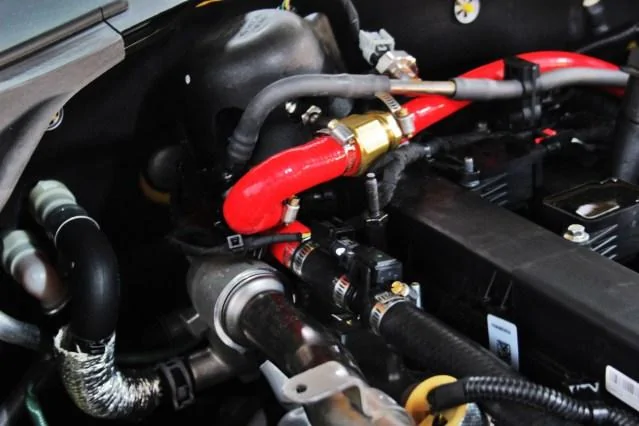

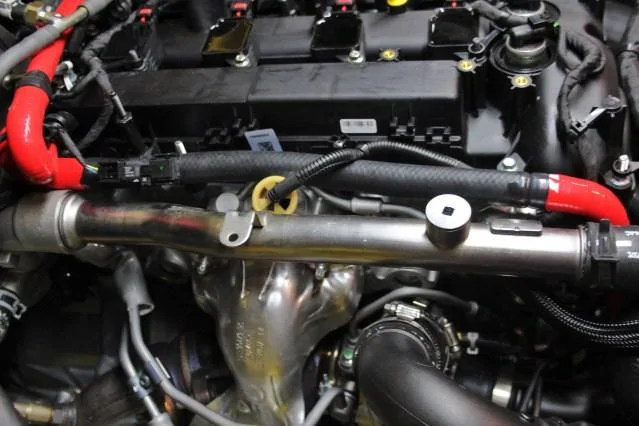

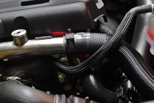

First, we tackled the breather line, which ties in between the valve cover and the turbocharger inlet pipe. Our line routes from the breather port around the rear of the engine to the catch can. The return line follows a similar path back to the inlet pipe. You will notice we have retained the stock pressure sensor.
Breather line mockup
These lines even fit with the stock engine cover!
A few interesting things to note about the hoses. First, the tape securing our hoses together is not electrical tape. Rather, we are using silicone tape to wrap our mockup lines in place. The lines will be secure enough for testing and will retain their shape, allowing us to create a fixture for manufacturing these hoses on a large scale. Second, the brass fittings represent transitions in hose size. These will be replaced by a single piece of hose that gradually changes from one ID to a larger size.

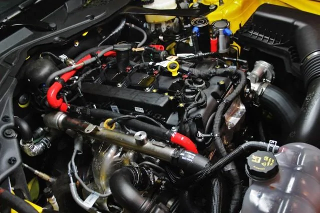

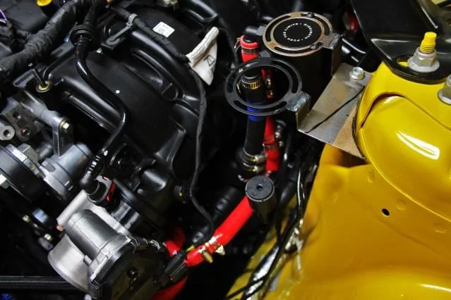

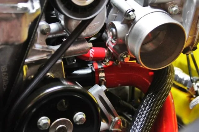

Next, we needed to address the routing of the PCV line. Our can will splice into the stock line that connects to the PCV plate on the block, as well as to a port on the throttle body. First, the hoses are mounted to the can itself.
PCV line hose mockup
The lines lead under the intake manifold.

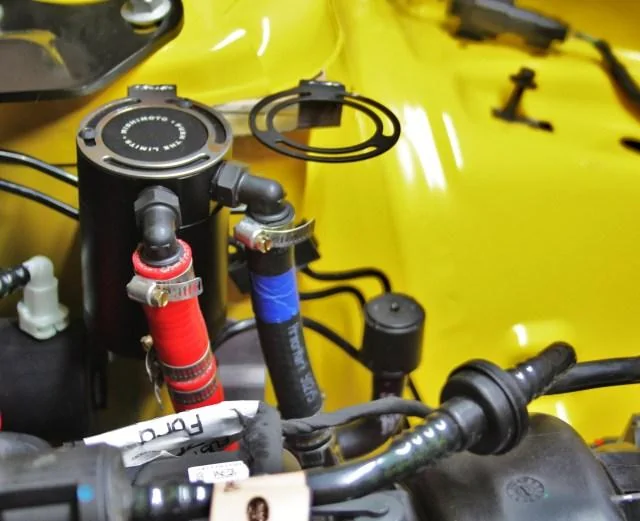

Final Prototype
We now had our full kit mocked into position. Check out a few shots of the final setup.
Full prototype kit installed
Now it was time to put some miles on our Mustang and see what kind of accumulation we could generate in each can. We would be fully testing this setup to ensure that both cans would be necessary for the EcoBoost. Check back with us next time for full details on the test results!
