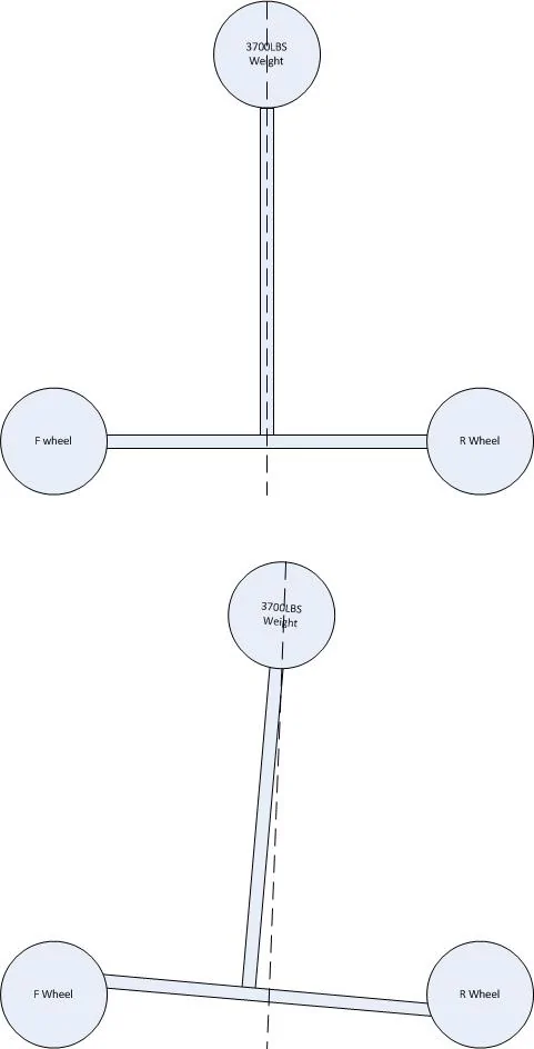

Not sure either. But whenever I think about this stuff, I use an extremely exaggerated example like this.

Not a significant amount, like less than the weight of a bag of groceries (with potato chips).
Makes sense. Swap the 10 foot pole in my diagram for a 1 inch pole and it's negligible even if you lower the rear to the point of being undriveable. Just spit-balling tho...

Within the range that we can adjust? No, there is no fore/aft change of CG position. You must physically change the pieces in the car to do that (like putting the battery in the trunk or something).
