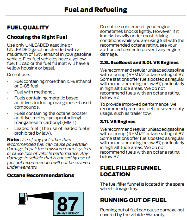

Youd be amazed to see how much a stock untuned coyote knocks without Premium gas. Hooked up my x4 and set it up to watch the knock sensor and all it did was knock. It would be +2 knock constantly on the highway. Put 93 in next tank and the knock sensors would read negative all the time. Dont know about the eco but the coyote will knock without Premium.
Your speed limit is limited from the base tune on the car like others said, has nothing to do with octane.

Premium gas only makes a difference, horsepower wise, on the ecoboost. Running an ecoboost on regular gas makes the car lethargic. The GT gains a whopping 5-7 horsepower running premium gas versus regular gas. So not much of a difference at all.
The only reason I run premium gas(93) is to have a safety net for oil contamination. Otherwise, there is nothing wrong with running regular 'ole 87 octane in your GT.
*Cue the muscle heads to come in and tell me if you run regular octane gas, your car will explode lol. No it won't, a GT runs just fine on regular gas...

Youd be amazed to see how much a stock untuned coyote knocks without Premium gas. .
Wrong..... There is no data to support your claim. If that was the case Ford would require premium gas and not just recommend it. It may knock under heavy loads at altitude or pulling a trailer perhaps.. but for daily use.. not. If it does then you have an engine issue or bad gas.

@bigyzf
Never said I have proof besides what I've viewed with my own car. You can put 87 in your just going to knock alot more frequently especially under load. You can do what you want with your car but to me it seems silly to pay this much for a car only to drive around with engine knock which may or may not cause premature engine wear. Again no proof but makes sense to me at least. I'm dont care about hp gains I care about having repetitive consistent engine knock day in and day out, especially when ringing my car out to 7k.
That's just me and if anyone has a way to datalog the knock sensor and can run 87, take it on the highway, you'll be as surprised as much as I was how much it knocks. It "feels" low on power to some people because its removing timing because your knocking.
My engine is fine and sees -5 on the knock at WOT with e85, as someone else stated your more prone to knock with a lower octane rating and you will.
Guess it comes down to if you care or not.

@bigyzf
If you car is knocking then you have an issue.. albeit most likely because of your tune. A factory stock GT does not knock nor should it running 87 octane.
Your statement should say "you would be surprised how much my tuned coyote engine knocks without premium gas".. Not a factory one. Just saying..
Not trying to bust your balls, but alot of folks will have the impression that all factory coyote engines knock by that unproven statement. You be surprised how gulible folks are.
