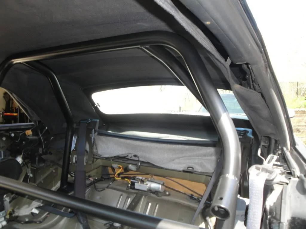

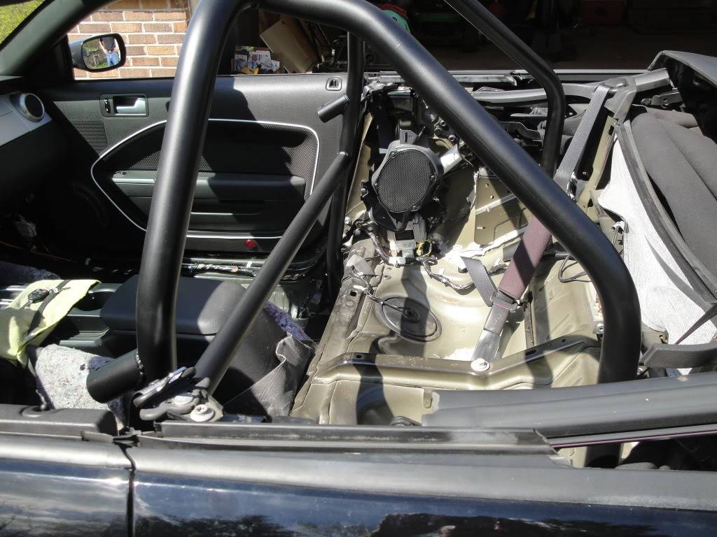

Unfortunately I can't find better pictures of the bulkhead - the back bars of my custom roll bar in my 2006 were attached to that bulkhead. But you can see that the rear seat cushion -- bottom and back -- are removed here. If you look in your trunk you will see that same type of bulkhead as the S197 convertible. It isn't solid and the back cushion simply pushes in to slots to attach.
The bottom cushion also simply uses push pin type attachments to mount to the bottom of the seat area.
