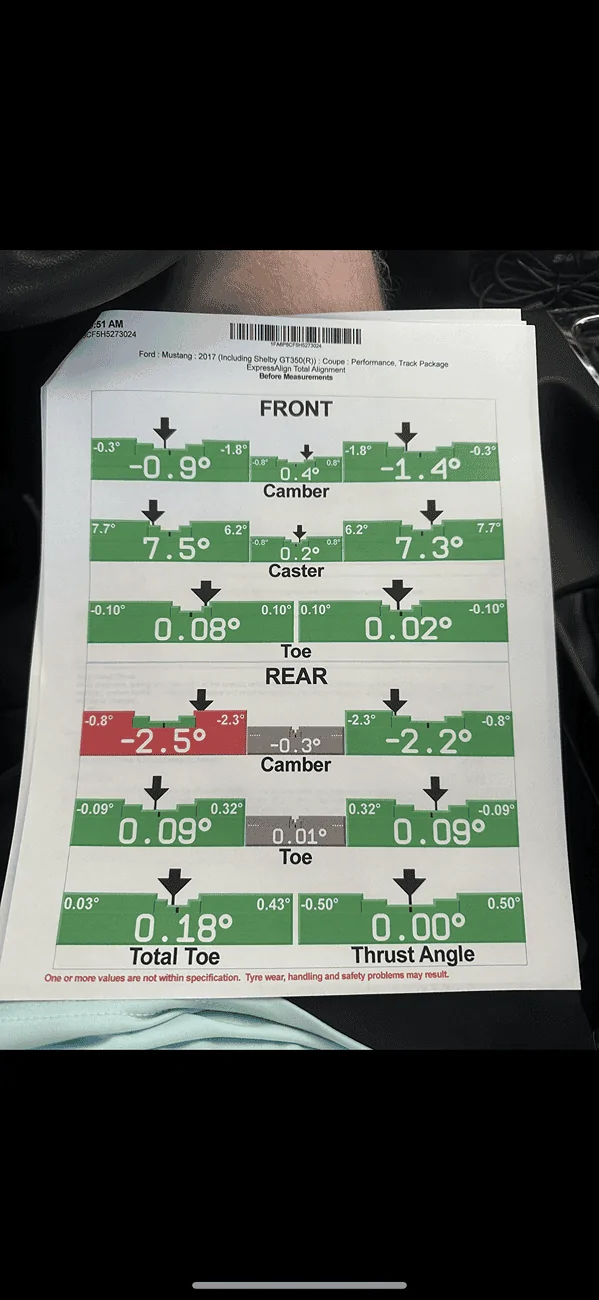

I am starting to wonder if my coilovers are just tired after having 55k miles.
I have continental extreme contact sports up front (275/35r19) and nitto g2 555s over the rear. 305/35r19.
the fronts are like 15 months old; and the rears are 2 months old.
Arizona roads are kind of shit and when I drive over them, it’s pretty rough; especially if going fast/switching lanes.
is there anything in particular that can make the car feel like this? I need a few adjustments in alignment, and I have quite a bit of negative rear camber.
it’s tiring having to hold onto the steering wheel with a death grip.

You're 20k late on a rebuild. And if you're using FA preload defaults you have basically no travel.
FA stiffs everyone a good 1.5" of travel. I have no good answer why the refuse to admit it, and fix it.
Makes sense. I’m about to pull the FA off and replace with steeda stuff. And sell the FA.

275 shouldn't be giving you fits. But if you haven't checked your toe, I'd get on that.
Toe is hardly off in the front. It’s a little off but not enough to make that big of a difference.

That's a lot of rear camber.

I mean at 55k miles yes they're due for a rebuild. Some get a bit more some get a bit less but 55k is not unreasonable for coilovers
Which ones are they and what are the spring rates, and how low do you have them set?

I could be wrong, as I am not completely up on the Mach 1’s, but rear toe should be adjustable. Not to be hypercritical, but your shop should be able to do better on front and rear toe. Which could effect rear camber.
You might school the shop you are using, or seek out one that has a better understanding ( or possibly a desire to do better work and please the customer ) of Mustang suspension.
