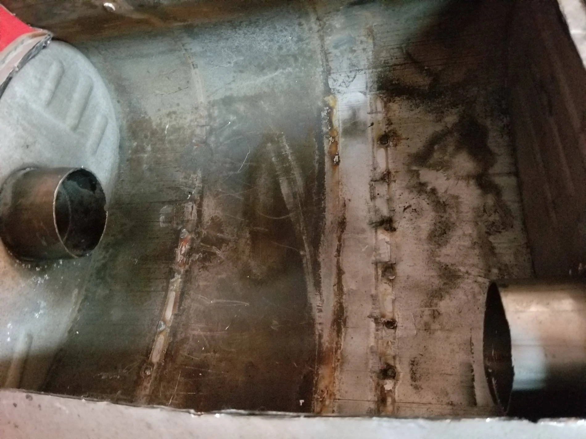

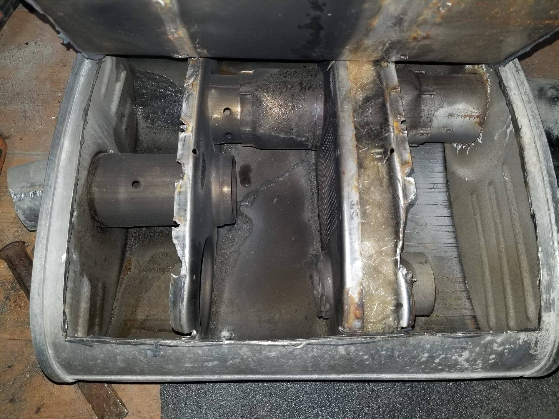

Do it yourself muffler delete with utilizing the stock muffler! Will update as I go along. Basically I thought to myself, why buy muffler deletes for $200-$300 USD when I could do it myself! Also, when the po-po looks, all they'll see is stock muffler, and won't be able to see the tig weld cause I cut the top.. hehe. Couldn't resist starting it up with the factory headers, cats, & H-pipe after I cut the mufflers off. OMFG loud lol.
What's inside you ask?
c_oc=AQlcYpBHiorPYOKEDTZJjEkGlaEvPeFSC-LMk6O3A1cPlkc01caY1WLcyu24OOolw3k&_nc_ht=scontent.fybz2-1.jpg

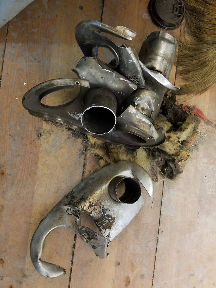

Here's the 5 lbs of garbage in the stock muffler
c_oc=AQn8Z9RK2z0lxQEjHcSASW5_Ql2sBeQglXOxXEO1wGxRuzKSCBMkak9d0djJPPvwG1g&_nc_ht=scontent.fybz2-2.jpg
Here it is gutted. Substantially lighter now. I used a chisel to break the spot welds. Worked well.
c_oc=AQlSOzviDZYPWJoymFgn_lRSjbr6maxa0Uf6DdOZtGbCSSkK-PSzNNUJHcGpxMQSmsM&_nc_ht=scontent.fymy...webp
The cut lines. I used a 4" cutoff wheel on a skillz grinder.
c_oc=AQmXQKFBGIjMWFFNZZ6vQeudWH0CUwN-f20gl2LLg_NnhyTeybW0dNe1zwhGELuAsYc&_nc_ht=scontent.fybz2-2.jpg
So far the cost is $0.00. Off to the parts store for exhaust piping to connect the inlet to the outlet. Hope there's interest in this little DIY! To be continued!

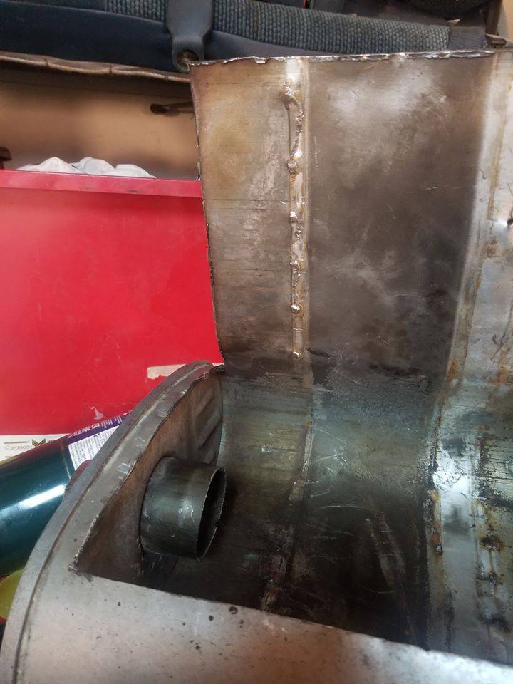

Gutting the P-side muffler was a bit more tuff. Spot welds were 'spot on' the day it was assembled lol. But got er done.
Q's: Do you guys think I should leave it as one large single chamber muffler? Or continue on with attaching exhaust piping on the inside?

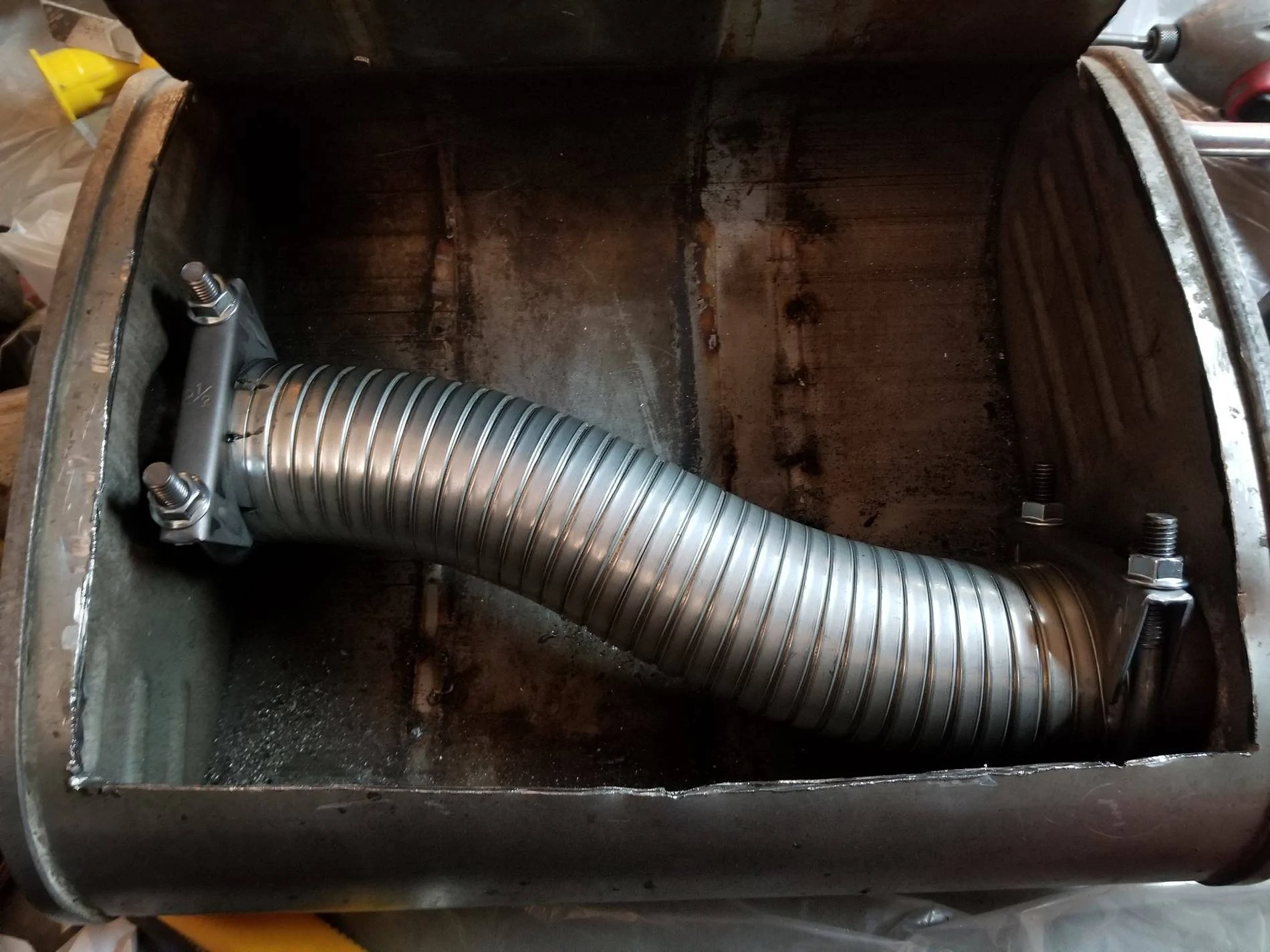

So ended up with this configuration (2.5" slip over). Total cost so far $16.99 CAD for both. Gonna tack weld the nuts so they don't back off, and the clamp to the muffler in a couple spots so the old shebang will be solid. Everything clears the top.
c_oc=AQmvXUuN8uCqCrTT-ZVGalvX5QC0am95lQx16P6oPf52bhNfQGYqW8M-Obf6FgIYnJ8&_nc_ht=scontent.fybz...webp
Mustang_Lou
May 1, 2016
1,843
822
Toronto, Canada
2020 Mustang Bullitt
May drone … I'd test it before welding it back shut again. At the worse with the flap off. At best, tape it on to get a true representation before you weld 'er shut for good.

Clips for sure. It will be louder than the Corsa Touring Axle-Back @ $1,233.99, and I'm guessing as loud as the Borla ATAK 2.5 Inch Axle-Back @ $819.99 & Roush @ $750.00 (I just can't bring myself to drop that kinda coin on a axleback). Gonna rustproof the entire interior as well. Should be less than $50 bucks total all in! Maybe under $150 if you need a competent welder to weld them. Still cheap. Total weight loss per muffler (after installing new piping/clamps is 4.5 lbs per muffler). Plus it looks 100% stock. More to come!
