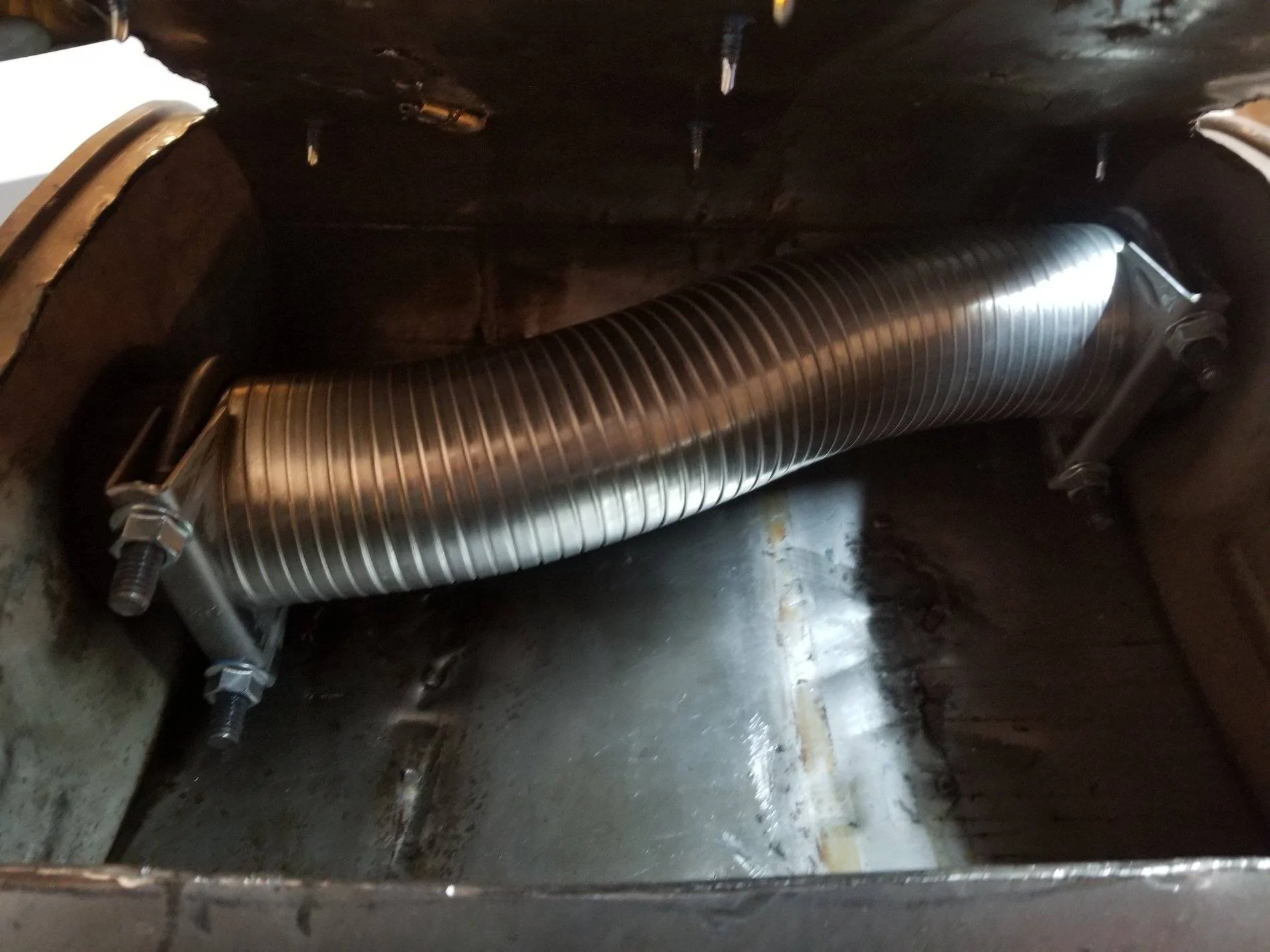

Good call on putting the flex pipe in there. Leaving the muffler open would echo and sound like ass. Kinda like hollowing out cats, it sounds terrible.
Yeah.. I had a sneaky suspicion it would have echoed like crazy. Like every subwoofer box out there.

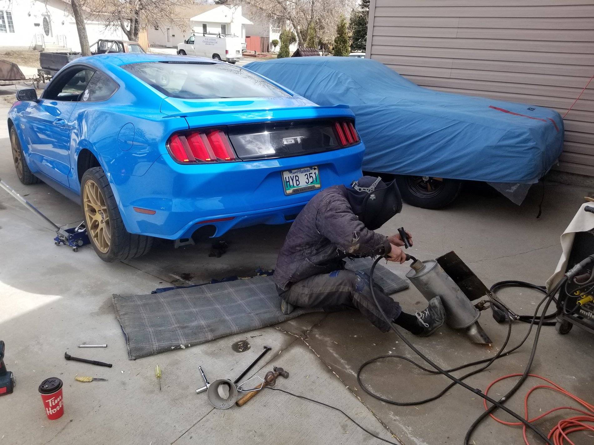

SO I took the advice of a earlier commenter and decided just to secure the lid on the muffler instead of welding it on. Easy access in case something comes loose. Then just chromed taped the seams to keep the nasty out. :thumbsup:

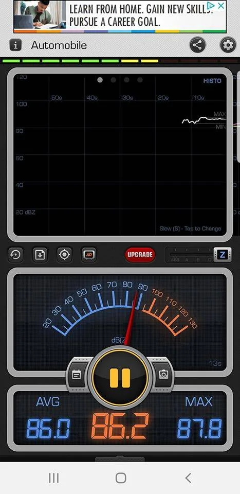

Ok.. so with it plus 12c today, roads basically empty due to the rona, I buttoned everything up, took it for a rip.
COLD START: Loud, but not obnoxiously loud.
WARM IDLE: sounds exactly like a 1965 289cid/306hp Mustang GT350 competition
CRUISING UNDER 3000 rpm: sounds exactly like a 1965 289cid/306hp Mustang GT350 competition
OVER 4000 rpm: sounds exactly like a 1965 289cid/306hp Mustang GT350 competition
WOT: sounds exactly like a 1965 289cid/306hp Mustang GT350 competition but much louder.
Firing orders are close:
SBF 1-5-4-2-6-3-7-8 (early 289/302)
Modular 1-5-4-8-6-3-7-2 (5.0 coyote)
cyl 2&8 cyl 3&7 are swapped.
I like it, I like it a lot! By camera sound sucks. So to get a good idea here ya go:

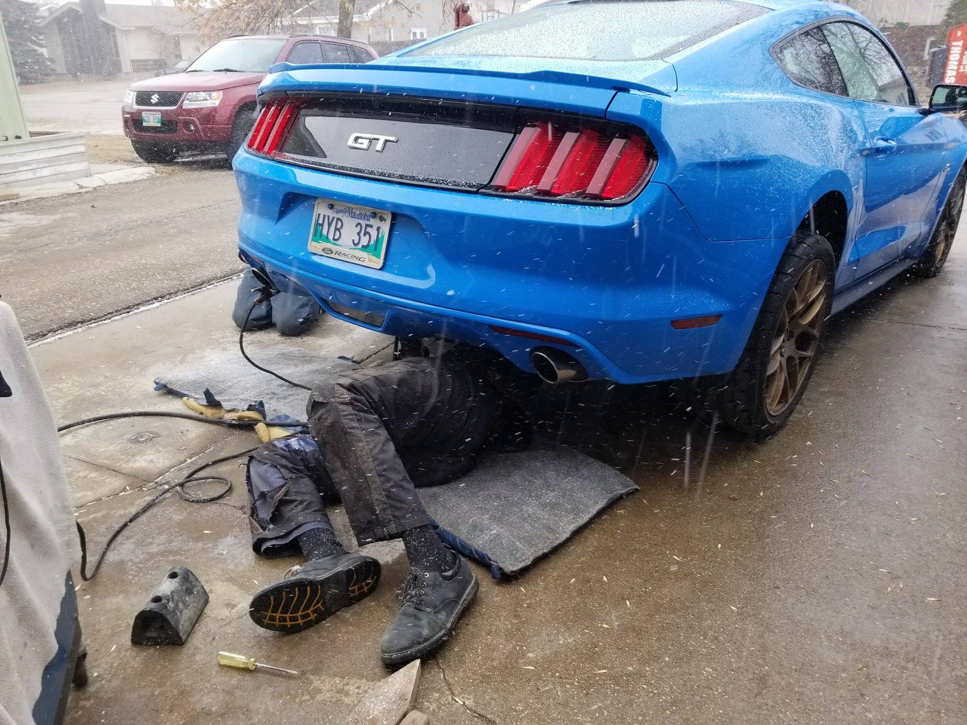

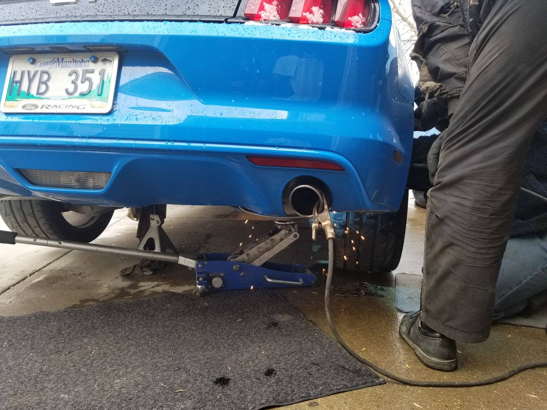

So now that everything works as intended, was time to take everything apart and weld it up all proper like. Inside the muffler, weld the lid back on, weld it back to the axleback. Nice. Sunny day. Then it snowed. On April 20th. You can stop this bullshit anytime now Ma Nature.
