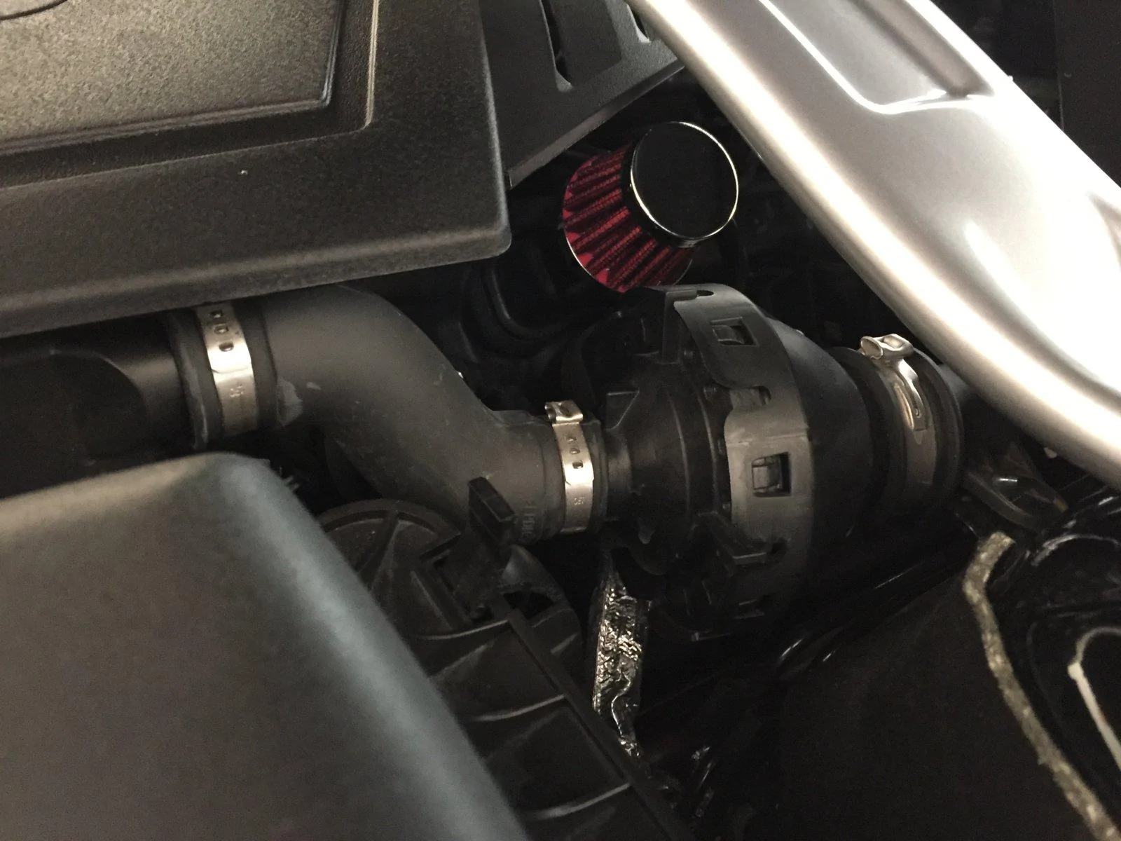

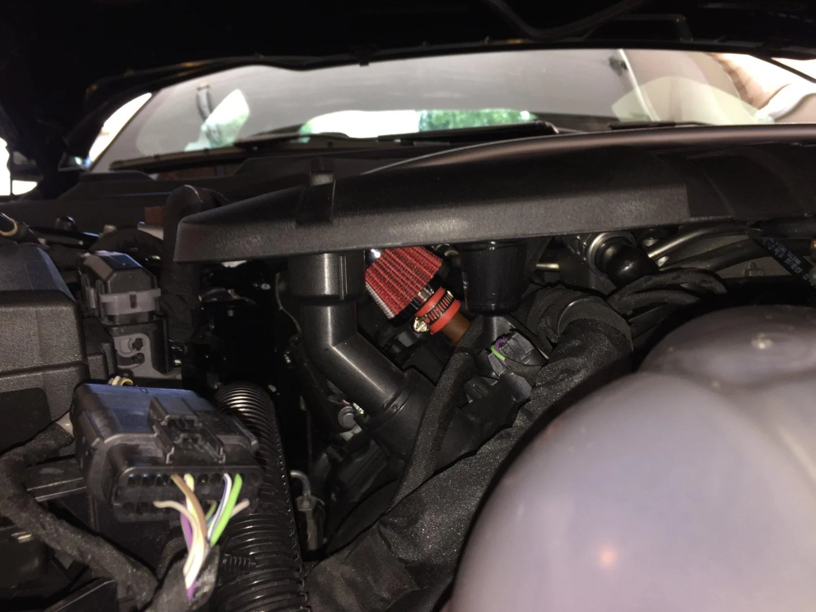

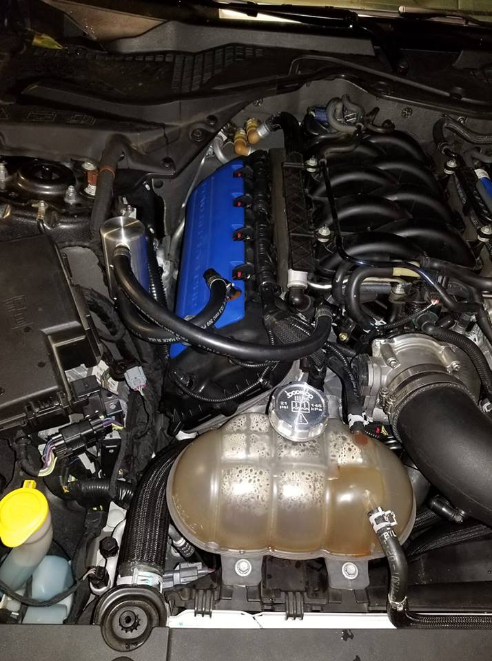

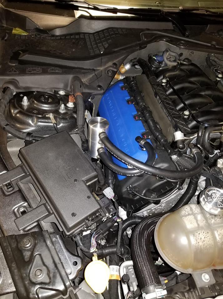

I just installed a Bob's catch can on my new short block. It works. Many people I respect said to go with Bob's.I only run e85. prior to e85 it was chevron or shell. The only source of this oil is from the pcv valve
As soon as I get ford to put a new motor in it I will be investing in a catch can
I have the same one. Performance is great, it's extremely easy and quick to empty, and it's hard-mounted to the body rather than hanging there.I just installed a Bob's catch can on my new short block. It works. Many people I respect said to go with Bob's.

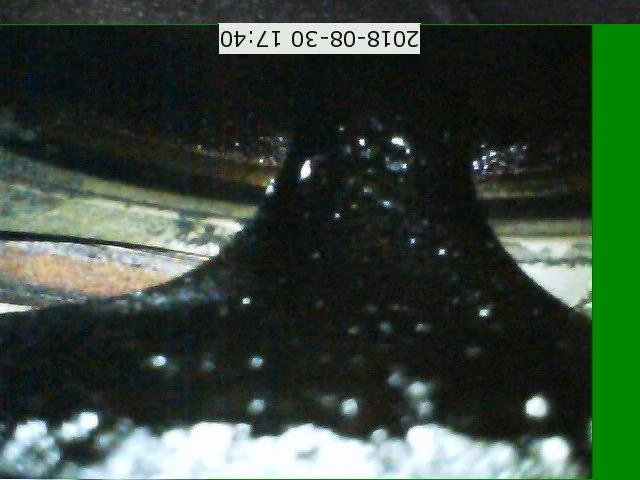

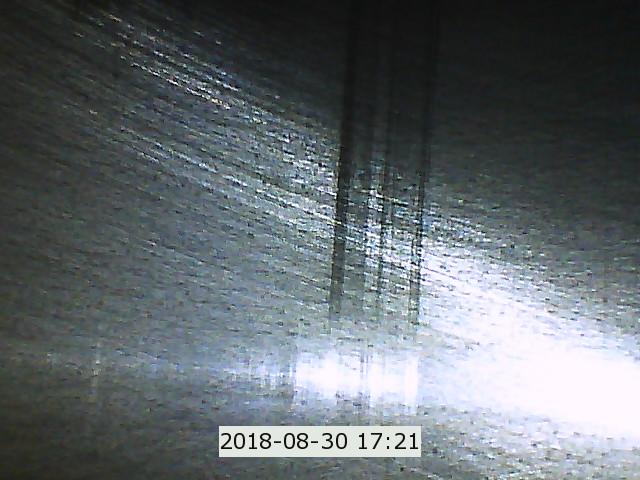

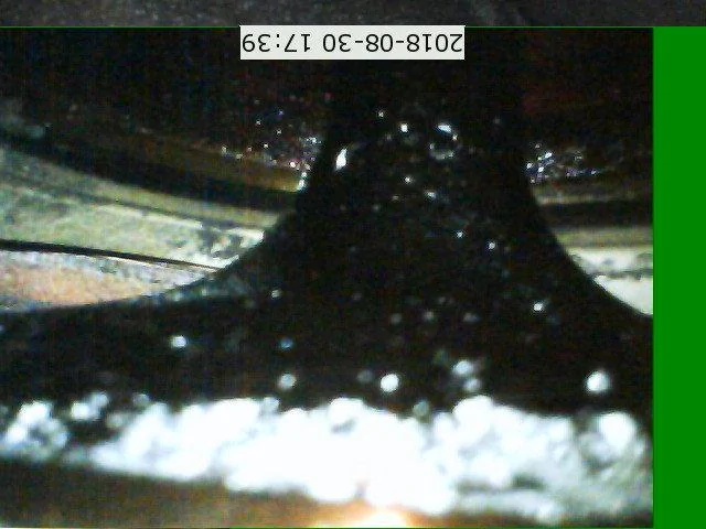

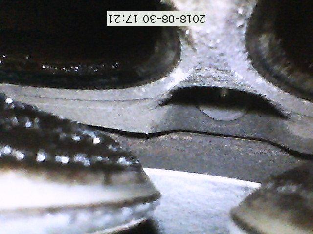

I've always been a big believer in catch cans. but for anyone thats just not sure. I took these pics of my valves today. My car has no catch can and only 7,000 miles
Although I am a fan of catch cans and breathers, the fact that your cylinders look like that is why you have so much excessive oil buildup on the valves. Your cylinders arent sealing properly so it's pushing more oil than usual through the PCV.
Yeah I posted about in the warranty/tsb section. About half of my cylinders look like this
