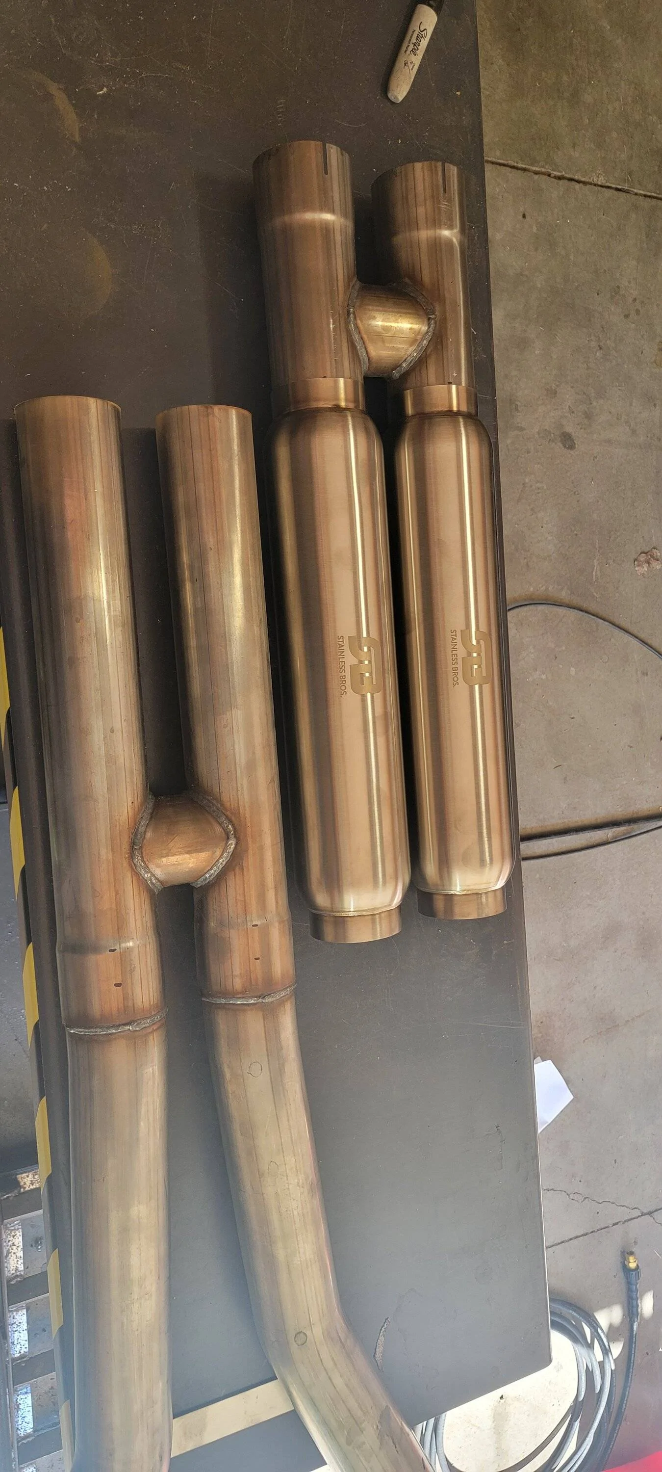

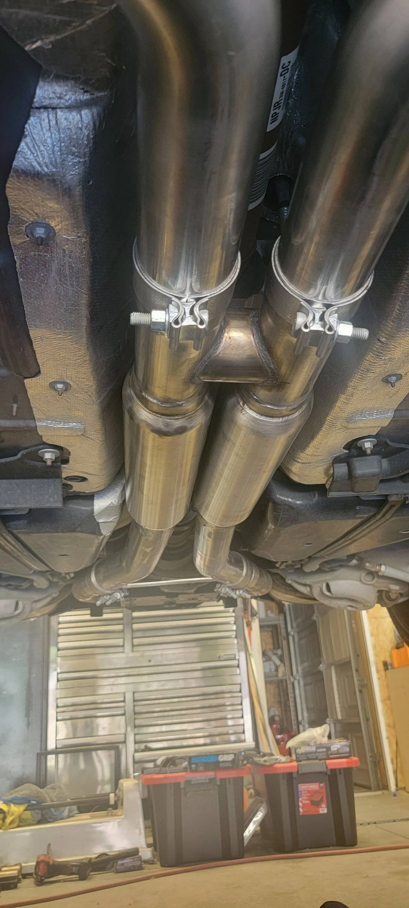

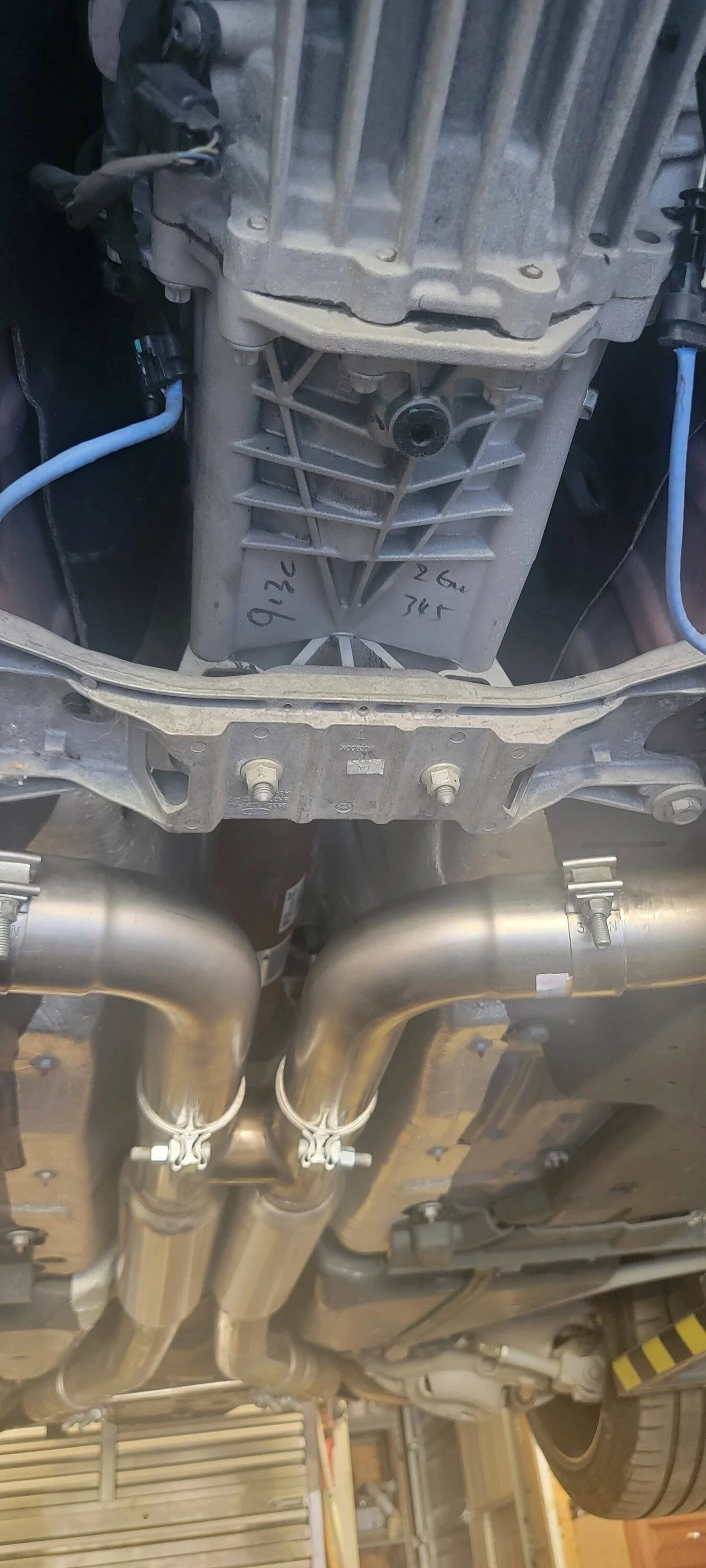

Walking around the car today after a repair i was listening to the exhaust and it has me wondering if i really want to do the axlebacks. It sounds good to me as is.
Catless cooks 3" to the stock active axlebacks. H pipe with 18" bottle resonators

What is a bottle resonator and how does it differ from the factory suitcase ?

Glass pack style resonators. 3" throughout vs the 2.25" of the stock one.

The resonators are used along with a the mufflers. I went from a 2.5" h pipe to the 3" i added the resonators too as well as got the 3" connections to eliminate that 2.25" choke point for the cat back.
As a whole adding them should tone down the exhaust when added to a system. But with me making so many changes at the same time its hard for me to say. That is my car on the original post however in the sound clip.
