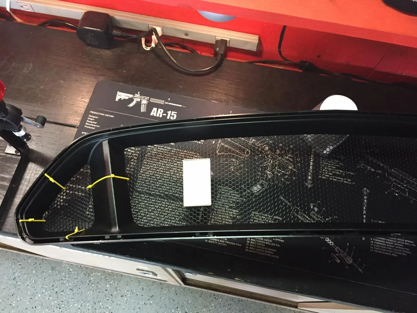

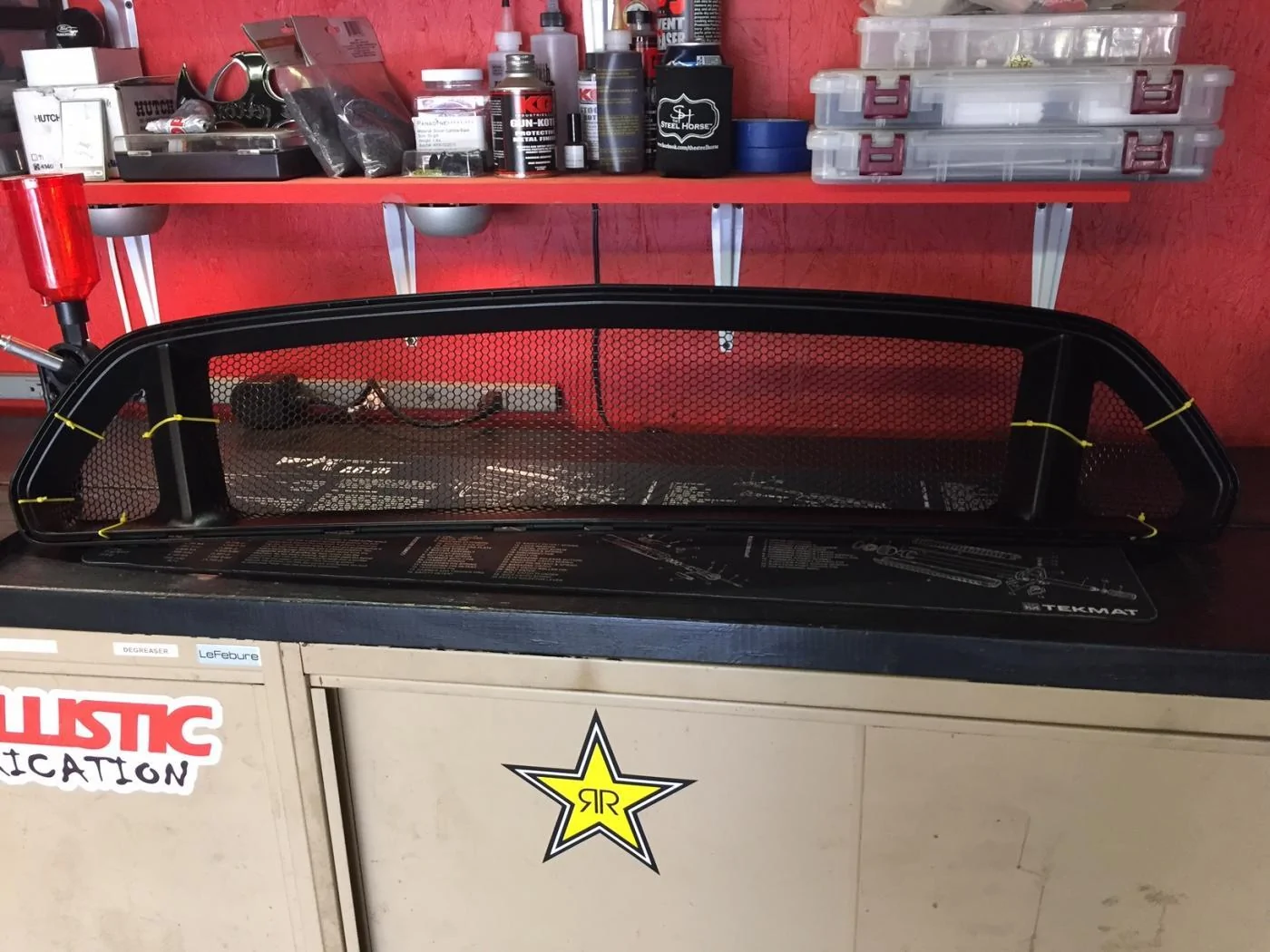

Anyone noticed custom car grilles are now using adhesive tabs/bases which locate the cable ties to mount the wire mesh rather than just the adhesive itself? I've seen two different techniques in their videos, the more primitive method with just the adhesive looks a lot less time consuming but wonder why they changed to the bases?
spiller
Mar 23, 2017
513
125
Adelaide, Australia
Porsche GT3
Cut my upper and lower grilles out today in prep for CCG honeycomb mesh. At first I was a little worried that the cut didn't look perfectly straight but as long as you get it about 85% right you can't tell once the mesh is mounted up against the remaining framed section.
