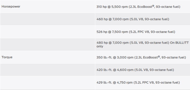

I also believe the tested HP numbers of the V6 are based on 87 octane while the EB is based on 91 octane fuel, for the simple reason that the owners manual recommends using a minimum 87 for the V6, and a minimum 91 for the EB, so it stands to reason they would use the recommended fuel to test the engines. FWIW, the 5.0 coyote owners manual also states to use minimum 87 octane (at least it does in my 2015 GT owners manual), so if someone claims Ford used 91 to achieve the 435HP rating, I'd have to see something more convincing than anecdotal evidence showing that before I believe it.
Ecoboost claims are definitely on 93 and not 91.
M6G post and an Autoblog article that quotes a Ford engineer.
The power figures for all the 18+ vehicles are based on 93 as well (screenshot from the Ford Fleet page):
And the 2015 Mustang brochure also indicates power numbers for both the Eco and GT are based on 93 octane fuel.
