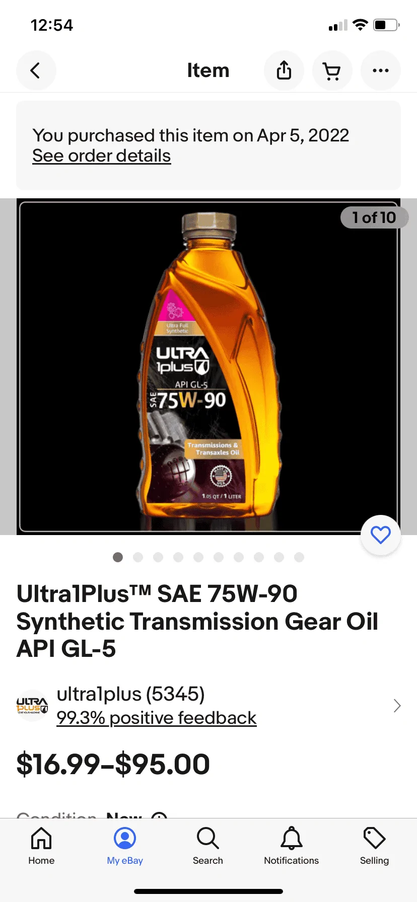

If I can reach it with my pinky through the fill hole, it gets sent.
oh. I use 75-90W no modifier.
This is what’s in my differential.
