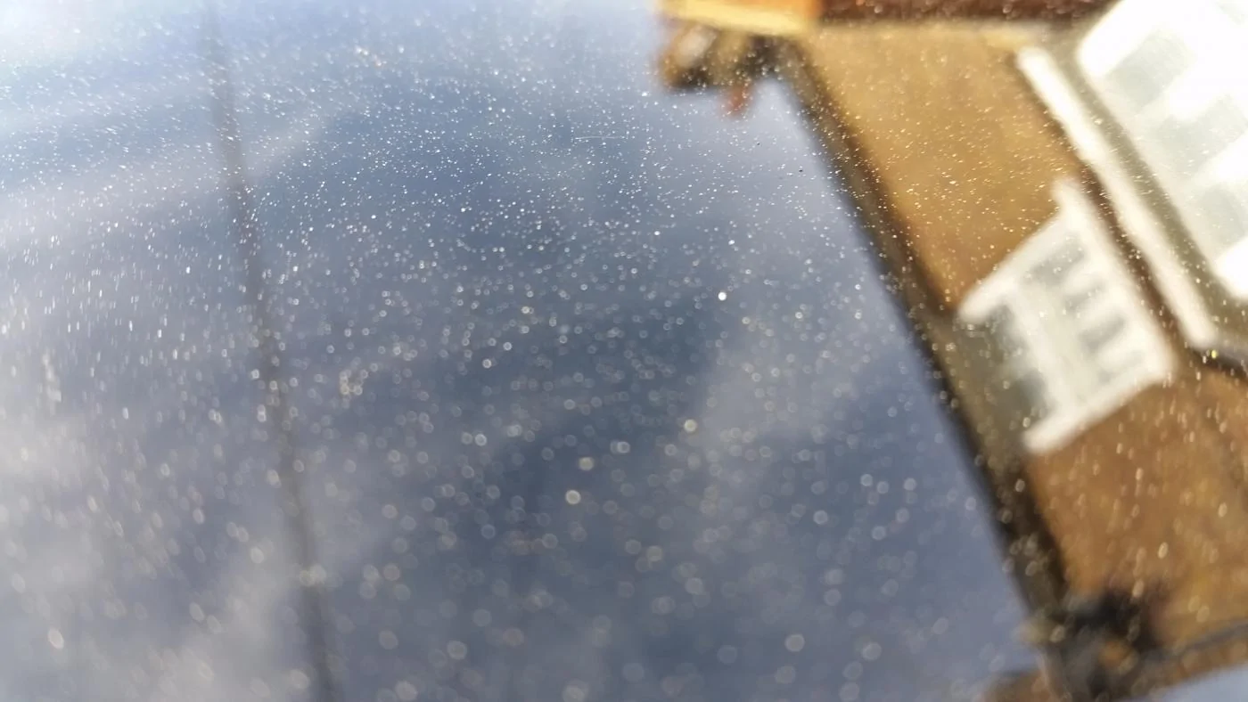

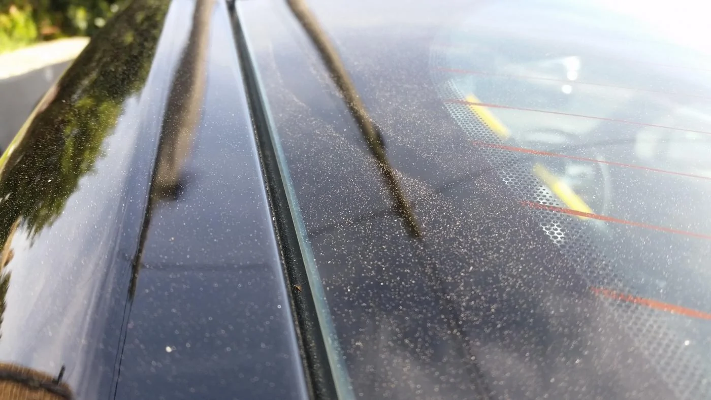

its an RO unit (reverse osmosis ) makes the water really soft by removing all the shit out of it so its pure h2o if you know anyone with a marine fish tank they'll probably have one or any aquatics shop should sell you about 25 litres for about £2.50Water spots, a detailed recommended me a special kind of purifier (same thread where @Jimboy2 introduced you to the leaf blower Larry - on SMUK), that you run your tap/wall water through and it purifies it leaving no water spots. Looked relatively cheap at around 20-80 depending on how big you want the purification tank.
Can't remember if it was called that... My head has a 'DI' something in the name :shrug:! Monday morning my memory is awful sorry lolits an RO unit (reverse osmosis ) makes the water really soft by removing all the shit out of it so its pure h2o if you know anyone with a marine fish tank they'll probably have one or any aquatics shop should sell you about 25 litres for about £2.50
Failing that http://www.osmotics.co.uk/ but bear in mind an RO machine is quite slow so you'd need a storage container than use pressure washer from the storage tank even with a booster pump you'd never get enough RO throughput to be able to feed a pressure washer. They also ain't cheap
You could go the cheap route and use a HMA filter but no where near as good.
Genius ;)! That sounds about right!di = deionised
RODI units are about £140 ish filter kits cost about £25 for the prefilters need changing every 6 months, DI stuff is about £20 for a tub which lasts about 12 months and an RO membrane depending on how much use it gets are about £50 and probably need changing once a year on "standard" usage.
kinda pointless using just DI non ro'd water as it still has a high carbonate hardness which is what leaves the water marks.
Might have to go on a hunt ;)!its a good call osmotics are one of the best places in the UK you can get cheap amazon/ebay specials but they're crappy built and keep popping orings on them. I've had my 150gallons per day osmotics unit for about 10 years now (marine fish keeper ) and its still like brand new just new filters/media whenever needed.
If you want to use it now go buy a 25 litre tub off ebay for like £50 and go to your local aquatics shop get some of their RO/DI
most pressure washers (certainly Karcher ones) can feed from a drum/tank rather than needing mains pressure.I'm a marine fish keeper. Still don't have a RODI filter and I just but my water from Maidenhead Aquatics. But you won't get any sort of pressure using this system.
What you want is a CRspotless system. Not cheap and not looked into if you can get them in the UK but this unit will be enough to clear your water and is designed for car/boat cleaning.
