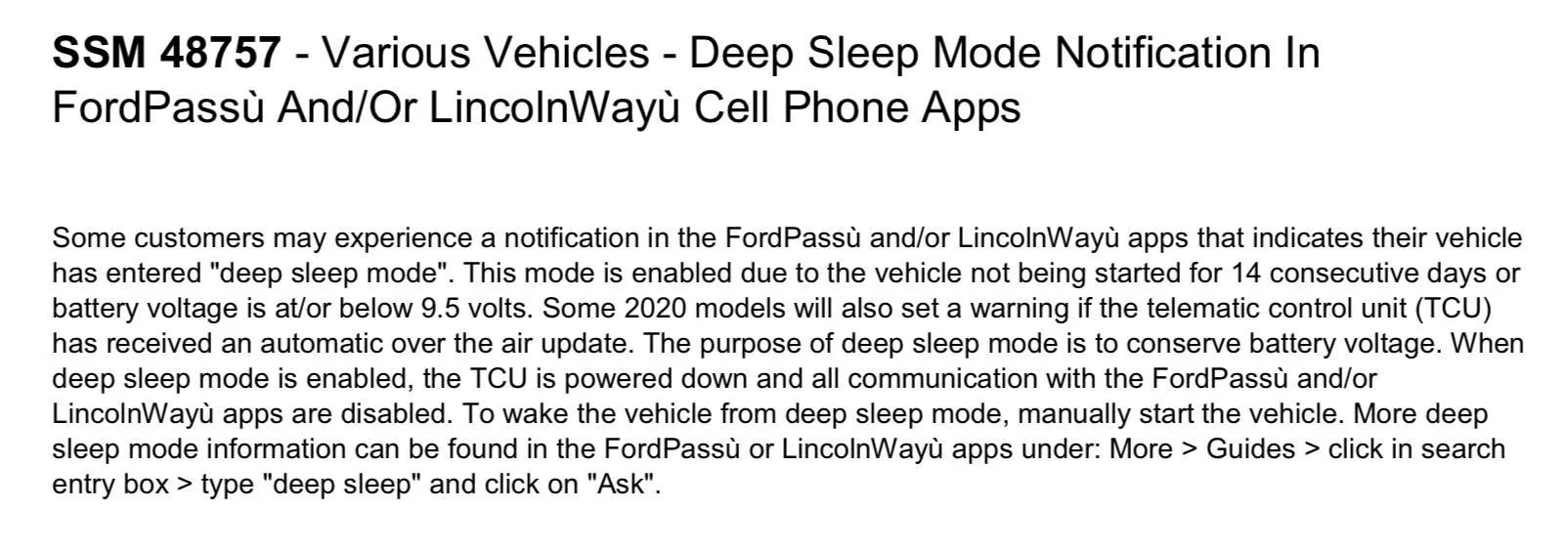

Ford had also released an SSM a while back about the Deep Sleep condition. This was most likely because a lot of newer Ford owners were seeing the message on vehicles not being used during the top of the COVID pandemic.

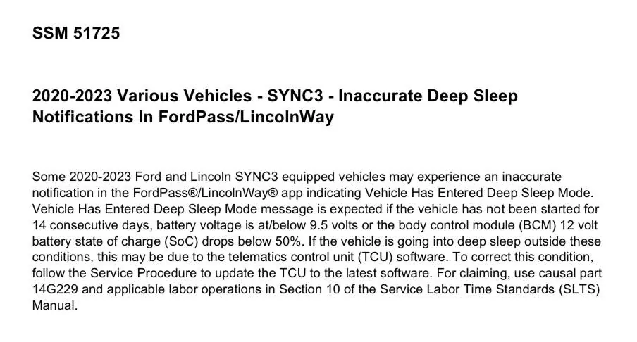

Updated Deep Sleep Mode SSM 51725
Thanks for posting this Phil. I am taking my car in on Tuesday morning and I get this message every time I turn the car off, both on the screen in the car and on my FordPass app. Car is only 1 year old and battery voltage on the dash shows between 14.5 and 15.0 when driving. The chimes in start up and the back up sensors do sound different, very 80’s analog sounding if that makes sense.

Figured I’d update this thread. Dropped my car off to have it checked out for the Deep Sleep Mode notifications I was getting all weekend (it mysteriously stopped yesterday but I still kept my appointment). The SSM that Cobra Jet posted was the fix as they were getting codes from the TCU when they hooked up the car. They did run all the amperage and draw tests as well just to be sure but everything there checked out. I’m going to pick up the car soon, will post a shot of the service invoice if there’s any additional info there that would be helpful to others. Everything is covered under warranty as well
