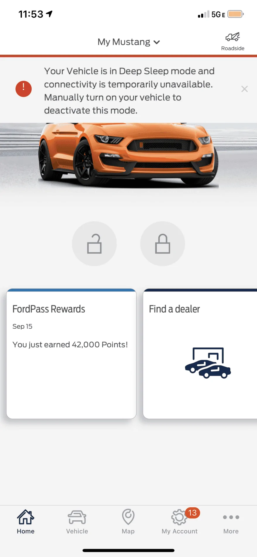

Never thought I would be saying this but my gt350 won’t awake from “deep sleep mode” disconnected the battery, had the battery “charging for about a week” the lights go on and off every few seconds interior speaker sound like a drum beating... terrific ... didn’t try jumping it.... only have 50 miles on it from the drive home, due to construction, didn’t have electric to start the vehicle or keep the battery on a tender so now I’m dealing with this... the app is useless just says start manually.... anyone ever encounter an issue like this?
Did you test the battery with a voltmeter after charging it?

Jumped it she started

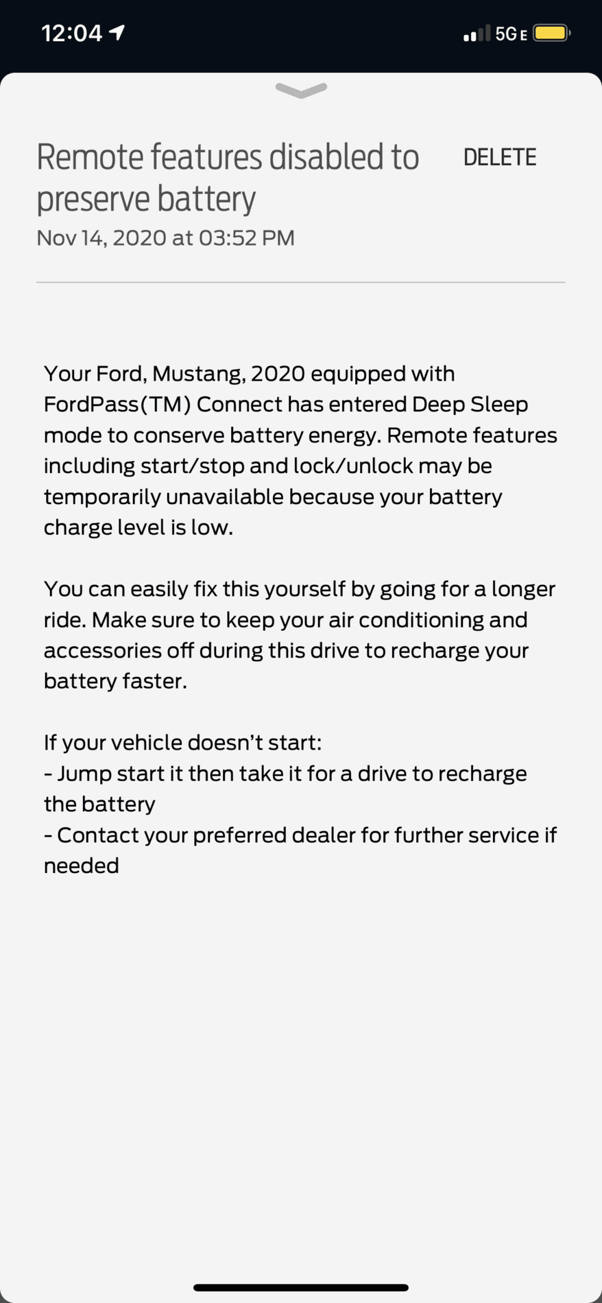

We had a few snow storms last month so my car sat for 2+ weeks. When I finally started it up, it said it was put into some sort of energy saving mode. I can't remember the exact wording but it was the first time I've ever seen a notification like that. It started up without any issues.
