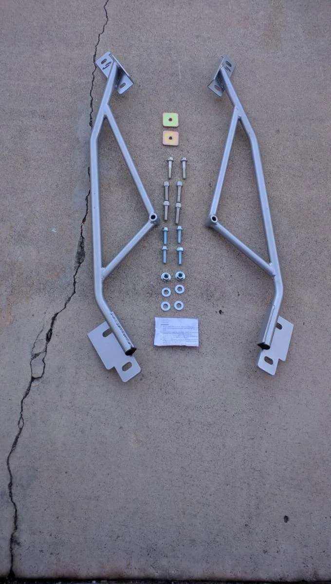

Steeda’s 2 Pt G-Trac brace provides the best structural stiffness, under chassis clearance ,steering response and control in its class. Why, because it fits the furthest back of any front sub frame brace on the market!
Great bang for the investment!
