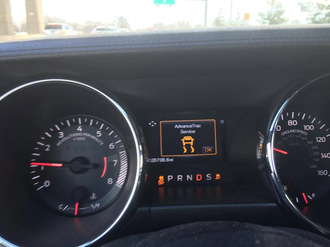

Side question here. It's not quite related, but I had this issue at Daytona, and have never seen it at Sebring, so maybe someone has two cents they can chime in with.
On my last session at Daytona, I had an insteresting issue with AdvancedTrac similar to what is seen here in this post:
https://www.mustang6g.com/forums/th...arning-temporarily-showed-this-morning.79463/
Luckily it was my last session and lap, so I just rolled in to the pits. It seems to disable a number of things including any of the drive modes and Hill Assist. It stayed this way until I started driving out of the infield through the tunnel and away from the track. I had to get on the highway so I refueled and headed out. But by the time I got on the highway, everything was normal again. I had all the drive modes and hill assist again.
I don't think it's a temperature issue, since this day never went over 70F, and I have tracked at Sebring in 90 degree days without this issue.
I think I read on another forum that maybe this has to do with the banked turns or fuel starvation at Daytona, but have not gotten evidence for that.
Anyone else have this issue or have seen something similar? It has not come back since that day,so at the very least I could probably say it's related to my track day.
Had same issue with mine, 2nd and 3rd sessions. Having owned the 2016 GT350 and tracking Daytona in 2017, learned the trick of driving around after session to have "computer" reset itself.
Back in 2017, @Tomster and I had that issue along with others. Being the car was "new" no one knew what to do. Someone at the track drove around the infield and figured it out. We all took his advice that day!!

If you use forscan, you can reset the system instead of driving around. I believe it happened to me twice in three days.

@16Kobra @Tomster Thanks for the info guys. I'll keep an eye on it. I had weird issues sorta like this on my 16 GT PP with the backup camera.

Its normal, its a glitch that occurs at Daytona and there is nothing wrong with your car.
