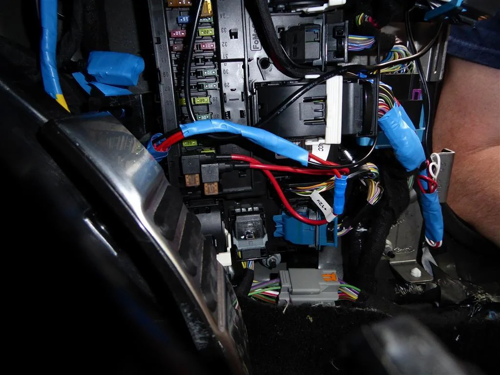

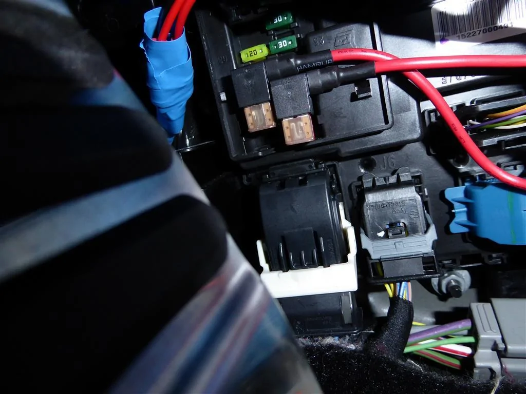

The fuses for the 2015 Mustang passenger compartment fuse box are Micro2 type. They have 2 prongs which are closer together than a mini use and longer than a Micro fuse. Halfords have no knowledge but they can be ordered from a Ford parts dept.

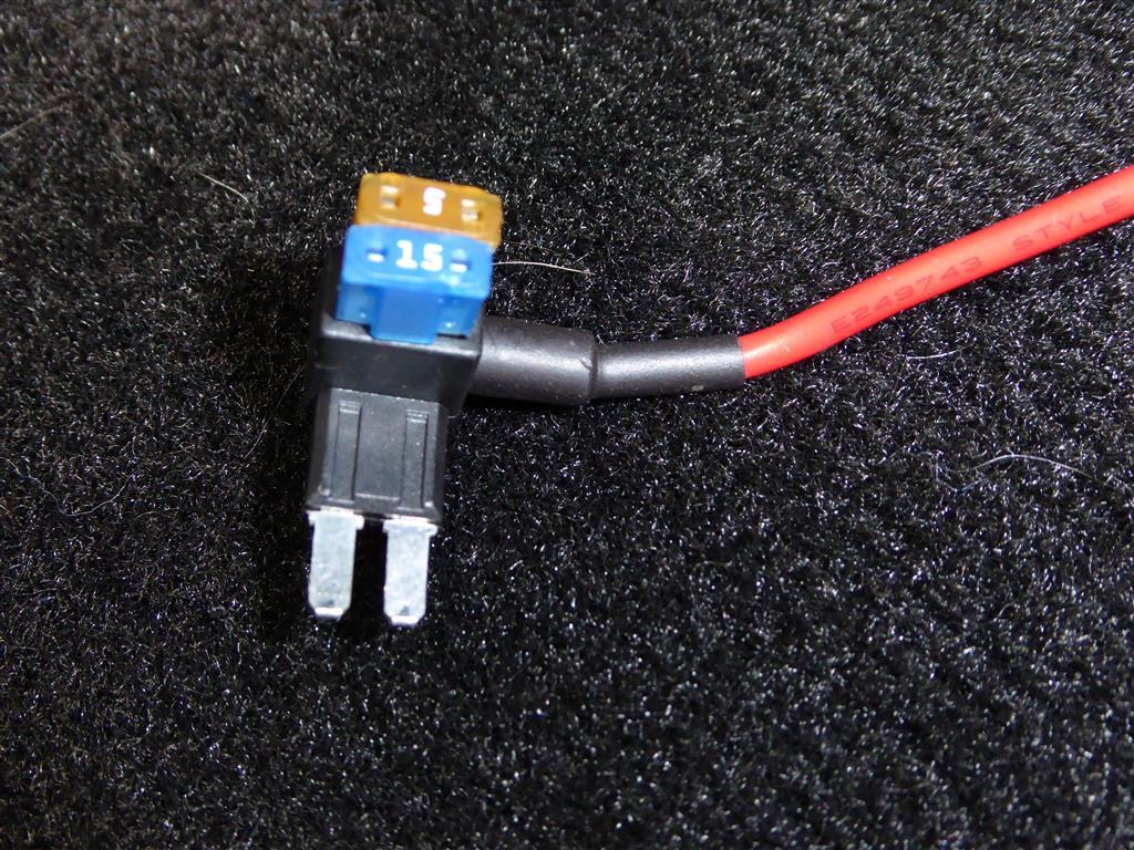

For the fuse taps I ordered Micro2 Blade ATR Fuse Adapter tap Dual Circuit Adapter Holder 12v Micro II from eBay USA but that item is not listed now so I can't link to it.
For supply connections using the 2015 Mustang passenger compartment fuse box (RHD) use Fuse 2 for permanent +12v and Fuse 23 for ignition switched +12v. It is very tight for space and if you use the fuse taps mentioned above then they fit snuggly next to each other when plugged into the fuse locations. One thing to be wary of is fitting the fuse taps the right way otherwise the supply will not be across the fuse and luckily the natural orientation is correct.

The piggy back plastic bit around the blades wouldn't fit so I managed to install it by wiring it directly on the existing fuses (2 and 23). Note that the cable I got was the other way around, yellow was battery and red was ACC. Turned it on and off again twice, it works. Also all other electics (switches and power mirrors work too).
No need of extra fuses and piggy tail separators (unless you want to completely separate the circuit. Worse case scenario, you blow up a fuse and you change it.
P.S. Those 7.5 Micro2 fuses are pain the butt to find here in AU.

Micro 2 is the correct name for these fuses and from the picture they look like the right ones to me. I have this pic of a fuse tap but I didn't take a photo of an actual fuse.
In the review comments for that item there is a complaint that the fuse tap does not fit well in the fuse panel and it is loose. I am using 3 fuse taps on my Mustang and I had to be careful to insert them fully for a good fit otherwise they just fell out. The trailing lead is quite stiff which doesn't help.
Anther tip is to purchase a fuse puller as even pliers will slip when you try to remove the existing fuses from the fuse panel as they are very tight.
