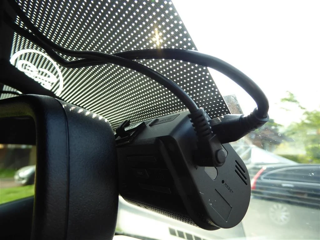

I mounted my Thinkware F750 behind the rear-view mirror and nearer to the driver so that the manual record button is accessible while driving.
The sticky pad is stuck to the painted area so that the light grey pad doesn't show from outside and the camera looks out from under the painted area and that part of the windscreen is covered by the wipers.
The Thinkware F750 is not particularly hidden not no-one looking at the car as ever commented that there is a dashcam installed so it can't be very obvious.

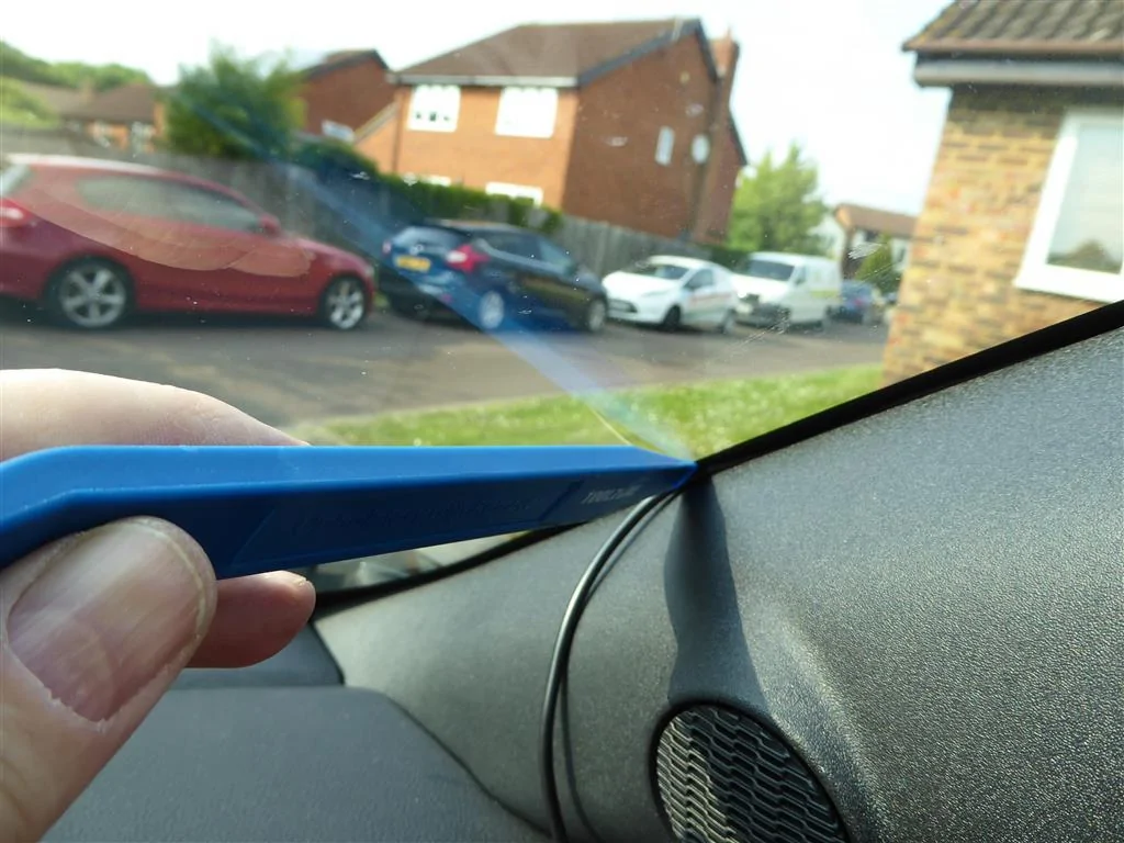

Poke the cable(s) behind the trim around the windscreen. In some places I had some black foam that I used to jam into the gap to keep it all tight and minimise vibrations/rattles.

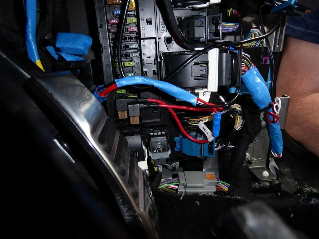

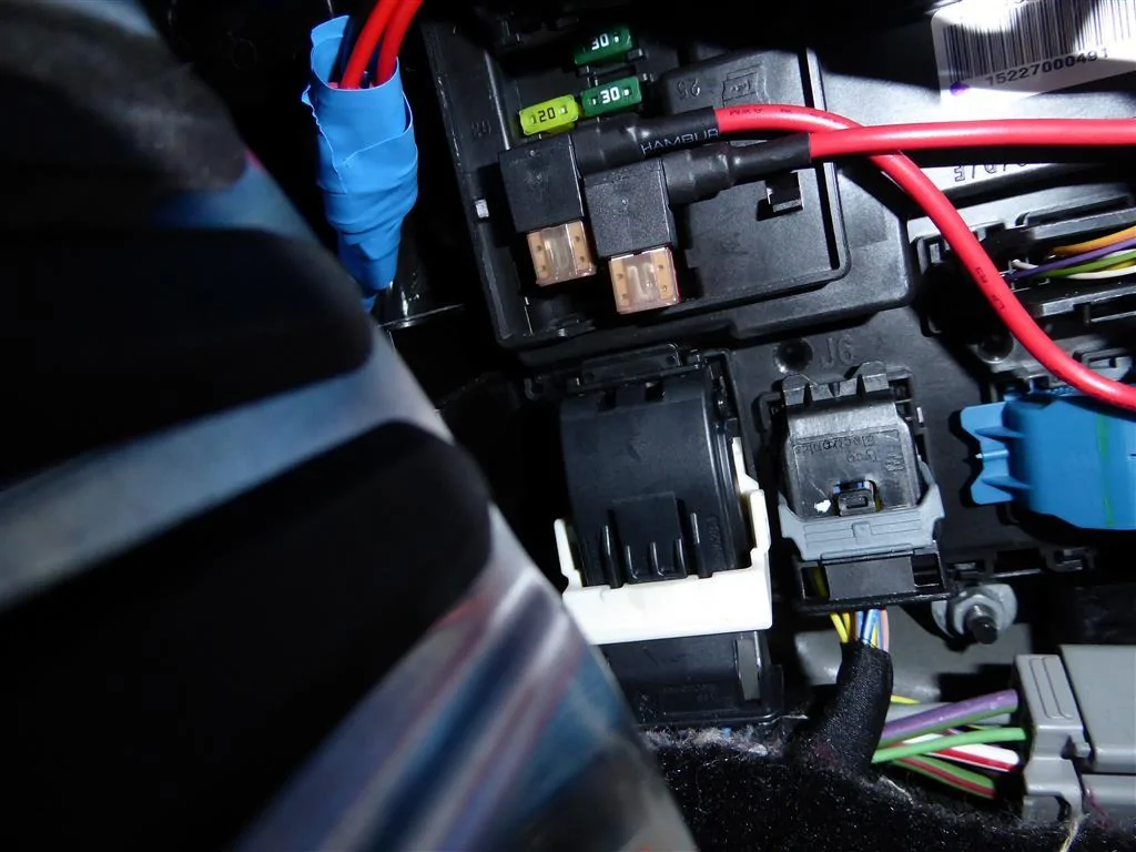

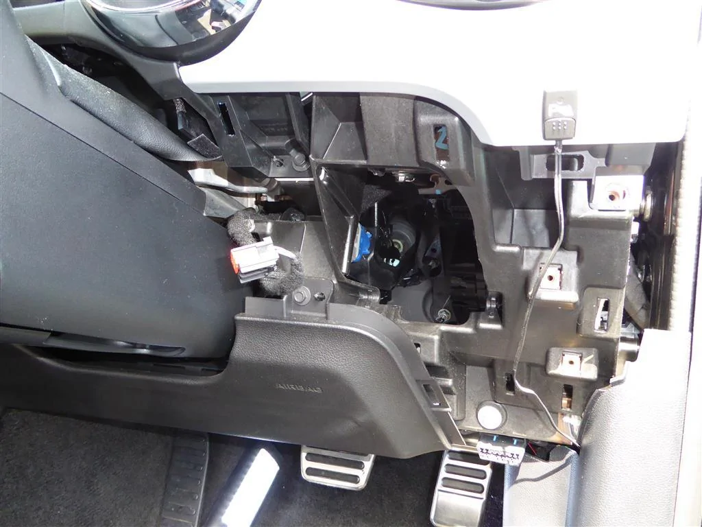

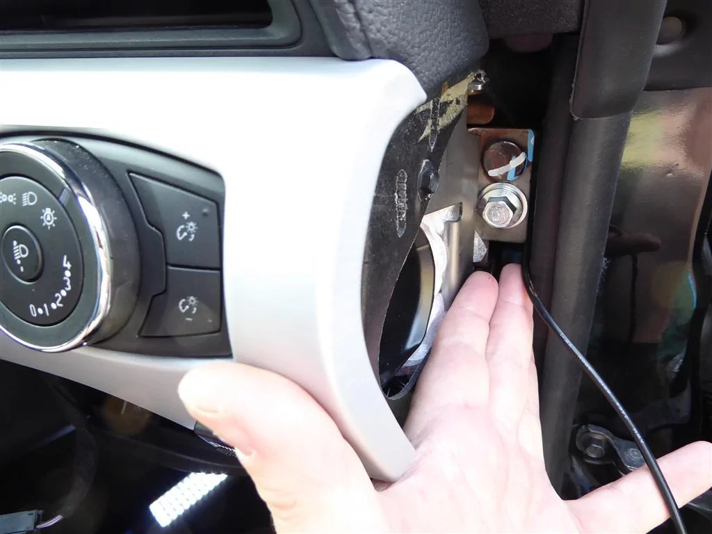

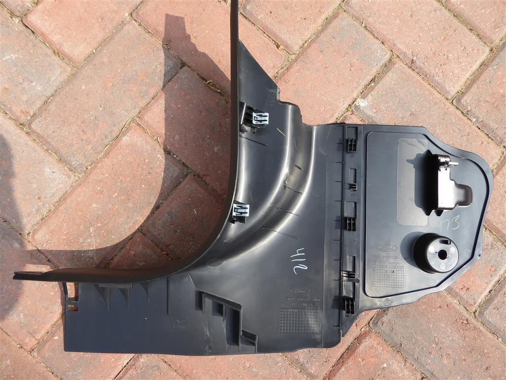

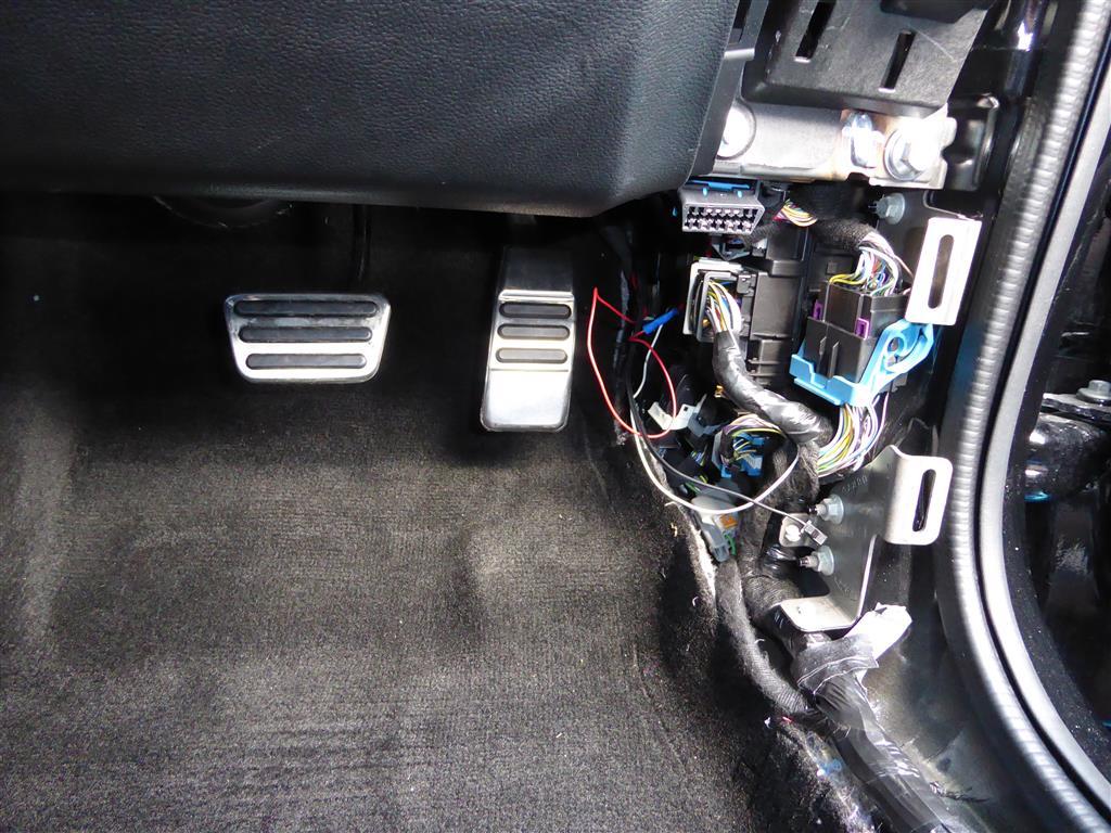

It is tight but do-able to push the cable down between the side of the dashboard and the pillar and I removed trim to route down to the fuse panel. I removed all the side trim next to the drivers foot to make access to the fuse panel easier and the slack cable is pushed behind the dashboard.
Routing the cable to the rear along the roofline is even easer and only took about 2 minutes. There is a lot of slack cable which is pushed behind the rim down the side of the rear window. I do guarantee that you will mount the rear camera upside down on the first attempt :). I put a black sticker over the blue LED on the rear camera.

Other thing is to note on the fuse tap is which fuse protects which output - i.e. which slot does the original fuse go into and which one holds the camera fuse. I tested the ones I bought with a multimeter and the fuse on top is the camera one

Not sure, I put the fuse tap in fuse 23 and the fuse I put in the tap were the blue one that came with it at the bottom and the red one that came out of fuse 23 at the top
FYI the explosion was awesome :D
What exactly is that photo showing. Was it your dashcam?

No I unplugged my dash cam before I started the car incase something like that happened. Its the little black box on the power cable that converts the power.
