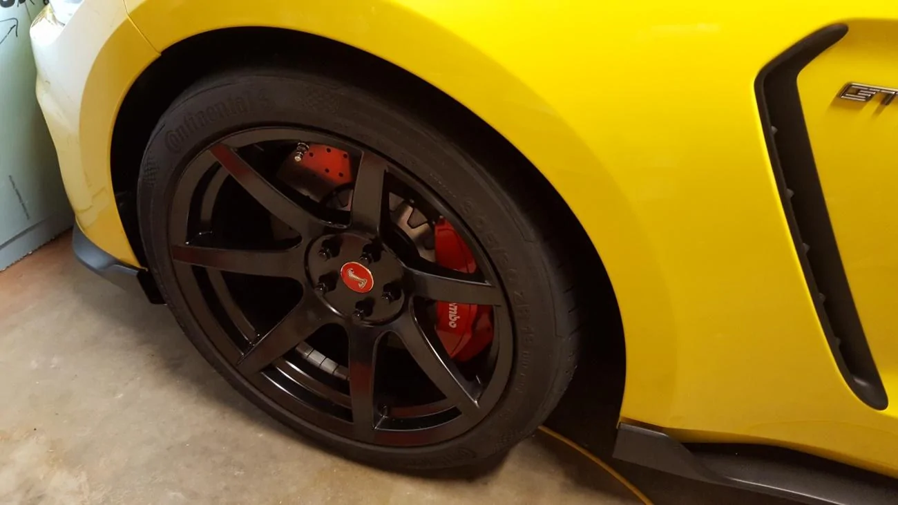

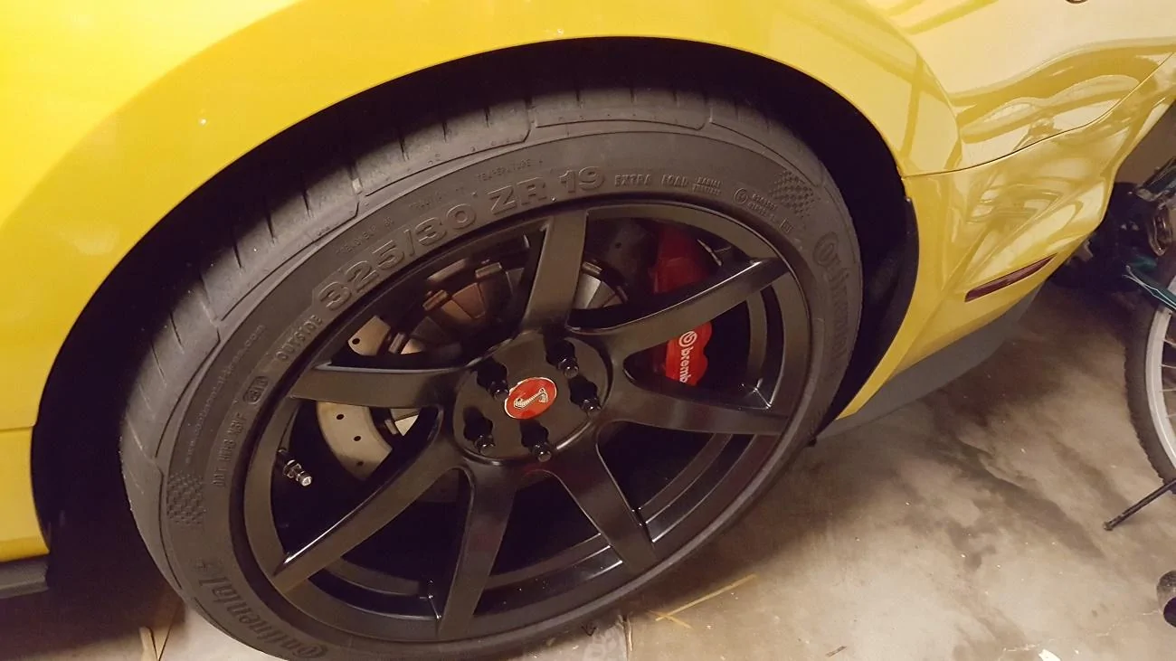

I'm looking for a set of track wheels for my gt350 and think that the 6gr wheels may fit the bill in R spec. What finish do you have in the TY pics and what do I need to do if anything for the lug difference. I have a 2017 LB gt350 and my first Mustang.
The above wheels are in satin black. I tried to get gloss black, but had to send them back due to quality issues. Satin was a second choice.
Lug difference is not a concern since you do not own an R. Even though I tracked these wheels when I had a track pack, I would hesitate depending on your application. The reason is that these are not true forged wheels. They are spun forged and imho, not as good. The other issue is that the clearance between the calipers have very little clearance with the wheel.
With that said, lots of folks track this wheels and have not had any problems. Nearing 170 mph in Daytona last year, I started to consider the weakest link in my system. Doing it again, I would get a set of forgelines.
Good luck

Agree with Tomster!
I went with a Set from Apex. Barrel clearance to the caliper is better than the carbon wheels. They also offer a warranty. They will replace your wheel even if it is damaged by an accident for half price. You just have to pay to ship the wheel back. They will do that 4 times. So essentially each wheel once or if you like to curb the exact same wheel every time. You can send that one back 4 times. :lol:

That's why I'm running 6gr wheels for the street. Imagine curbing one of those at over 4k each.
I've got an extra set of oem center caps, but a popular vote led me to the red snake caps
Nice set up Tom!
Just a quick question as I want to go down much the same road as yourself with respect to after market wheels and tires.
I noticed that your front tires are stock size for an R but noticed that the rears where a little larger (325 vs 315) and wondered whey the change?
Does Continental not stock 315/30/19's and are you still running 11 1/2" wide wheels on the rear?
Also like the Red center caps as they would look nice on my Ruby Red R IMO.
Thanks!
Harry,
I bought that wheel and tire combo for the 16 track pack for track days. I was trying to duplicate the R wheels both in aesthetics as well as weight and they were the best combo at the time. They are R spec in terms of size and dimensions.
The reason for the 325's in the rear is because the 315's were not available. There is a slight difference in size between the two and it was a topic of discussion where the difference was discussed at length. Where the rubber hits the road (or track), I found these tires exceeded my expectations. A very soft R compound tire that had excellent qualities all around. I have an extra set in the garage so I'm set for a while.
For street or track use, there is no appreciable difference between a 325 vs 315. You will probably find the 325 is a bit more common than the 315 (at least thats what I've found looking around). The only real difference (and it may be a deal breaker for a discerning enthusiast like yourself), is that a 325 is not true R spec. For street use, i have no concern or reservation.
Sorry to OP for off topic, I didn't want that question to go unanswered.
Back to the original thread topic.......
