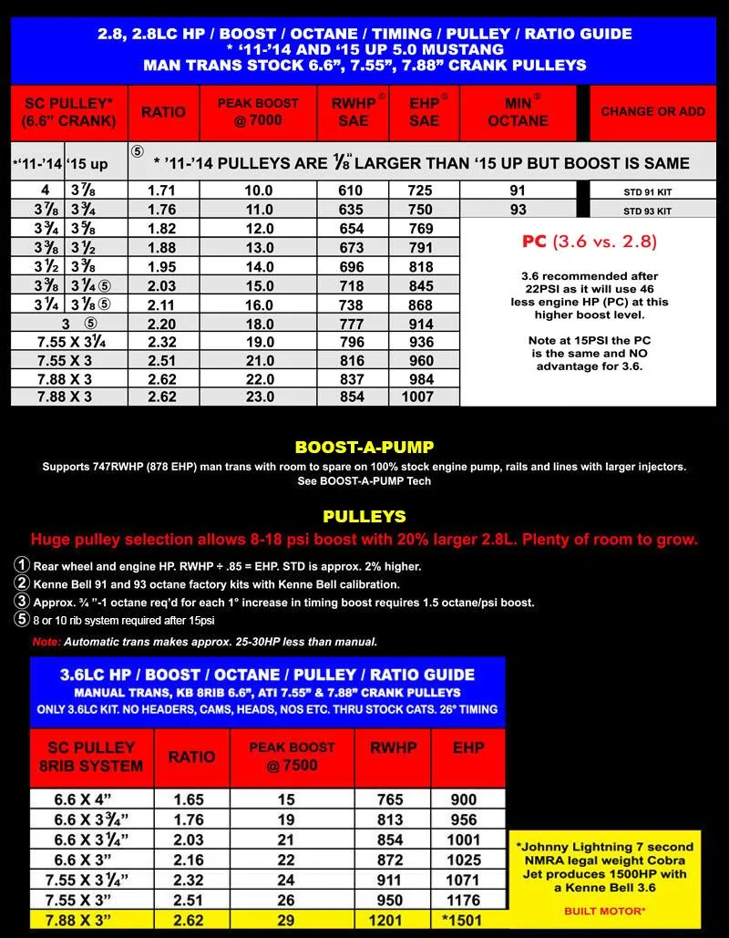

Anyone know what pulley size for approx 14lbs of boost? I need to get another pulley for when I complete my E85 swap and want to purchase it now instead of later. I can use it now with ms109.

Thanks. Well I have a 3.2 LC, at least I think I do. Hard to tell on the outside of the SC. What I'll say is, I was sold a 3.2 but I'm starting to think I have a 2.8 LC.

Yea, only thing I can recommend is to get the serial# off the side and call KB to see what you have. Hopefully they can answer the boost question as well.

Per the chart that came with the kit ,I need to go down to a 3.5 pulley even with the lower to make 16-17 psi.
