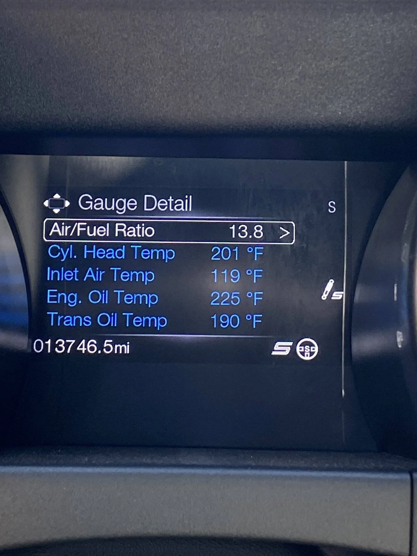

Whoskyle
Jan 30, 2021
AZ
Kyle
2016 Shelby GT350
For reference today, AC on, 109 today
