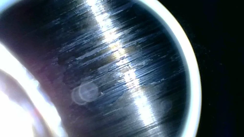

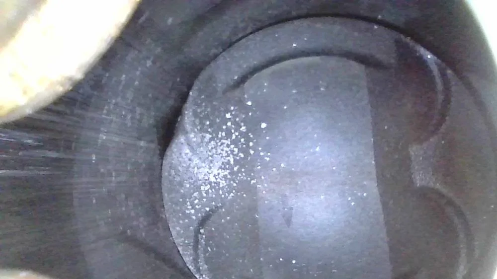

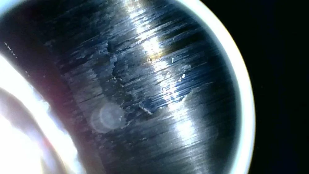

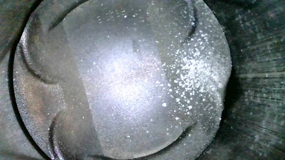

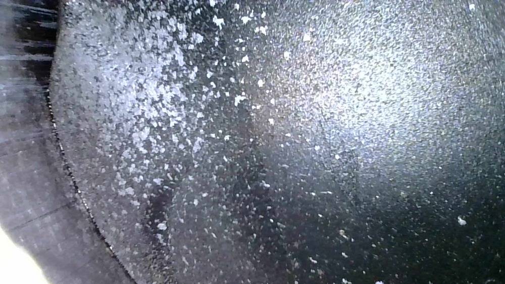

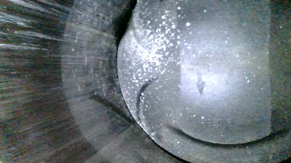

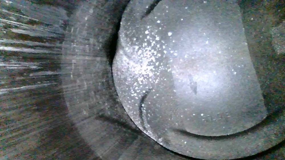

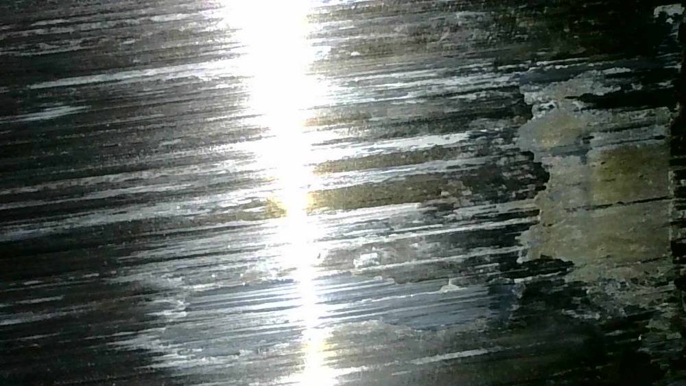

Alright here are the photos pulled off of the camera.

ooooof at the photos.
