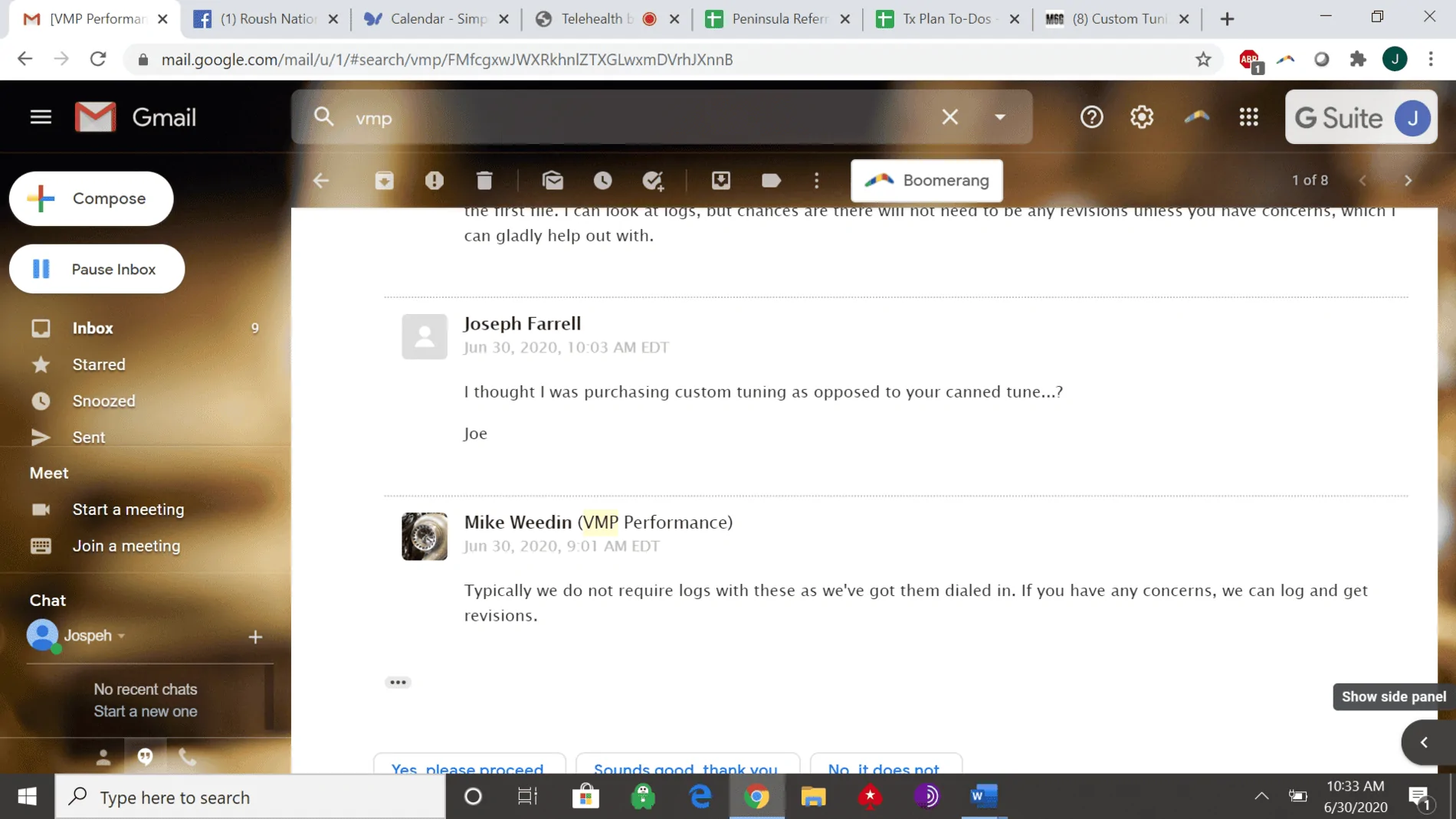

Hey all,
I own a 2015 RS2 with Roush's P2 blower kit, BAP, catback and wheels.
I spent $900 by buying an nGauge from VMP and their custom tune. Seems what I actually bought was a canned tune from VMP as they're not requesting any datalogs or anything, just plug and play.
Is this standard? In the past it's been back and forth with the tuner as they calibrate it based on my car's needs, location and environment, etc etc. ???

Everything is canned until you datalog for them. Most of the time it will run just fine, especially since we're now 5/6 years into the platform so most things have been figured out pretty well for the majority of people. If you notice anything, contact them for help and see what parameters they want on the log.

Is it normal that they tell me I don't need to datalog, just plug and play?

If you are comfortable with logging do a couple 4th gear pulls and send it to them. If it’s good your done and it you need a revision they will send you one. I personally would want my supercharged car logged and reviewed regardless of how many they have tuned. jmo

Here's the thing, these cars have so much flexibility in them that once the setup is vetted it will "work" on 99% of the similar cars. Fueling is handled via the widebands and is basically closed loop at all times with a large range of combustibility via the fuel trims. Gen 2 has 2 knock sensors (gen3 has 4) so the knock sensors have a good range of timing adjustment and can adjust very quickly. Lastly, the stock tune on these cars is pretty damn good from the factory. You don't need to mess with much to have a good running car.
Now, with that said you should always do at least one or two data logs just to make sure nothing is messed up. Not saying you will get a revision, but for piece of mind it is something everyone should do after loading a tune.

Agree, with such a basic setup (even supercharged) and the vast array of sensors in the ECU there's little that they actually need to change. Back in the day before closed loop WOT and widebands stock, you *HAD* to datalog to make sure that fueling is on-point. But now you don't really have to worry about that, as as long as you have the right combo of parts and they are in working order then you will always have the correct fueling.
Same with knock and part throttle fueling, with the 2/4 knock senors and calibrated MAF you don't have to worry about having issues there.

Agreed, and with this particular setup the OP has it is most likely the Roush cal being used which is more or less OEM.
