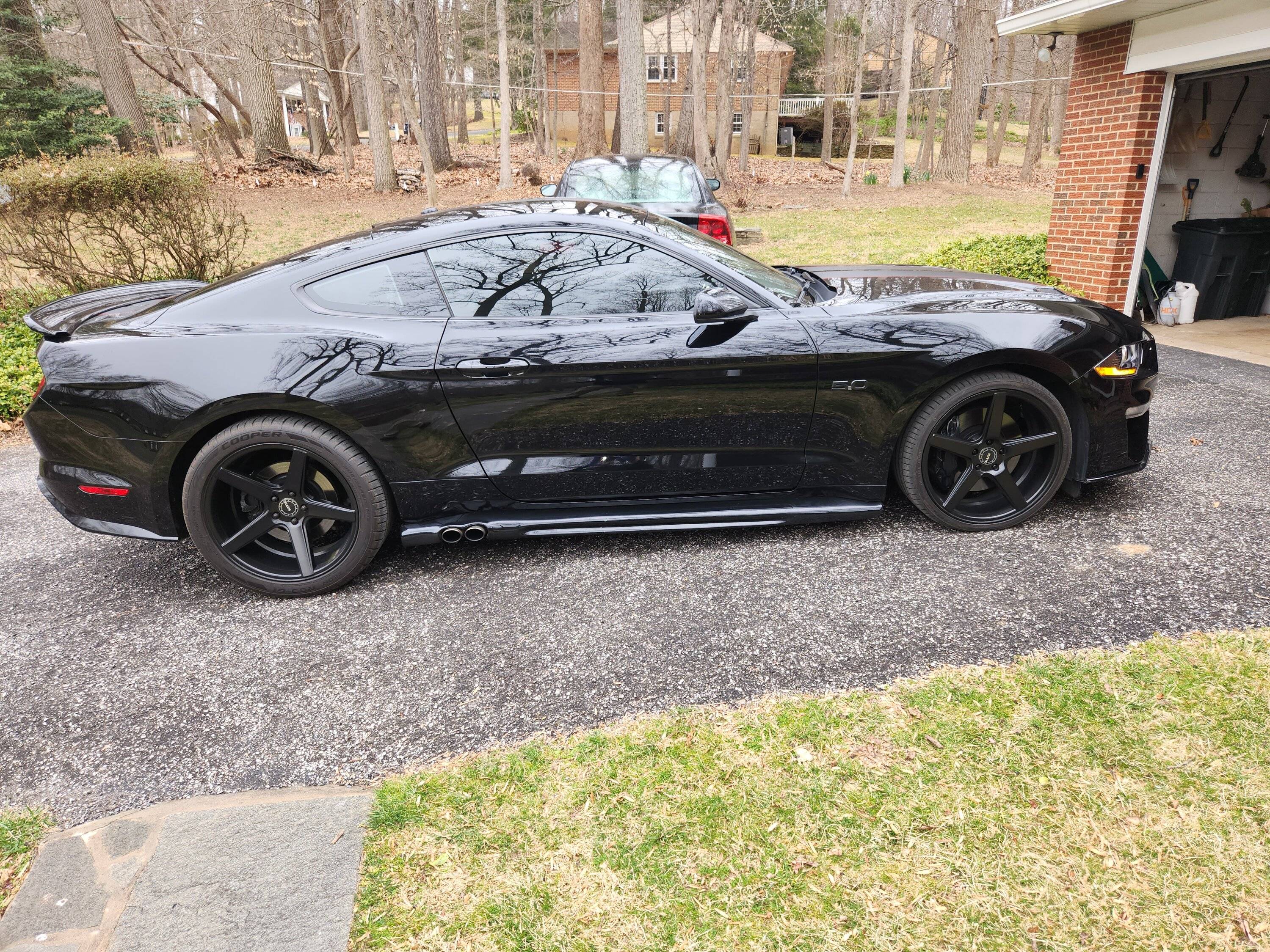

Mine was a Sherrod conversion and came with this. It WAS factory exhaust, into a magnaflow resonator, to a 90 degree bend with those tips, and the custom fiberglass side skirts. I had to have the Corsa mid pipes raduised in order to make them line up when I added the long tubes.
