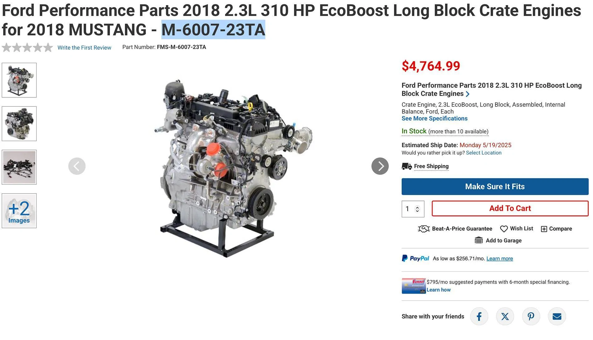

HI All,
I wanted to know if this crate motor can fit in to the a 2015 Ecoboost PP manual? Has anyone seen this modified to fit in to a 15-17 Car?
M-6007-23TA

You need to call ford performance about the fitment since I believe you also need to buy the FP control pack kit for this to work in any 15-23 mustang. I don't believe it is a plug and play install without FP control pack. Read the FP info on the crate engine very closely.

Correct on the standard and HPP numbers but the FP crate engine is using analog TB and separate control pack engine harness. There is a member on the mustangecoboost.net forum that was looking at going with the FP crate engine until he called FP and was told it was not a plug and play swap into his mustang without control pack kit.
Ford Performance offers the high tech, 2018 Mustang 2.3L EcoBoost turbocharged engine as a crate engine kit. With turbocharging, direct injection and twin independent variable cam timing (Ti-VCT), this kind of performance comes standard with a dose of adrenaline. The swap possibilities are almost endless; from early street rods, kit cars, most generations of Mustang, to just about any other vehicle build. The Ford Performance Control Pack helps make for an easy plug and play installation (available separately).
  • 2.3L EcoBoost engine as used in the 2018 Mustang
  • 310 hp @ 5,500 rpm, 350 lb.-ft. torque @ 3,000 rpm (with 93 octane fuel)
  • Designed for traditional rear drive installations
Engine kit includes:
  • Engine
  • Production turbocharger
  • Starter and mounting hardware
  • Alternator and mounting hardware
  • Engine harness (not installed, must be used with Ford Performance Control Pack)
  • Throttle body (analog type - not installed, required for Ford Performance Control Pack)
  • Engine kit uses Ford Performance M-6017-23T Control Pack (not included)
  • Click HERE for exterior engine dimensions
Plus, it's for off road use only.
