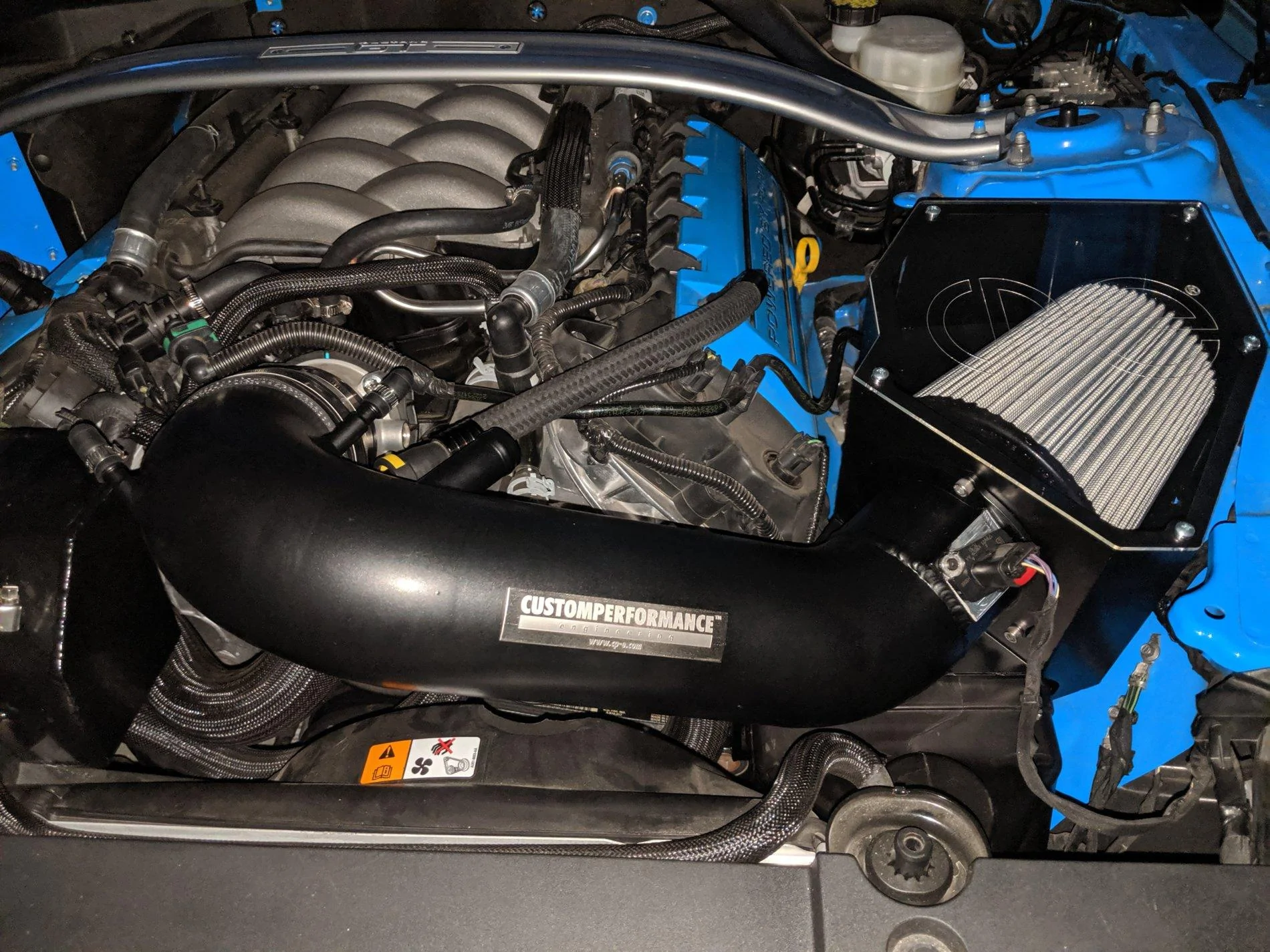

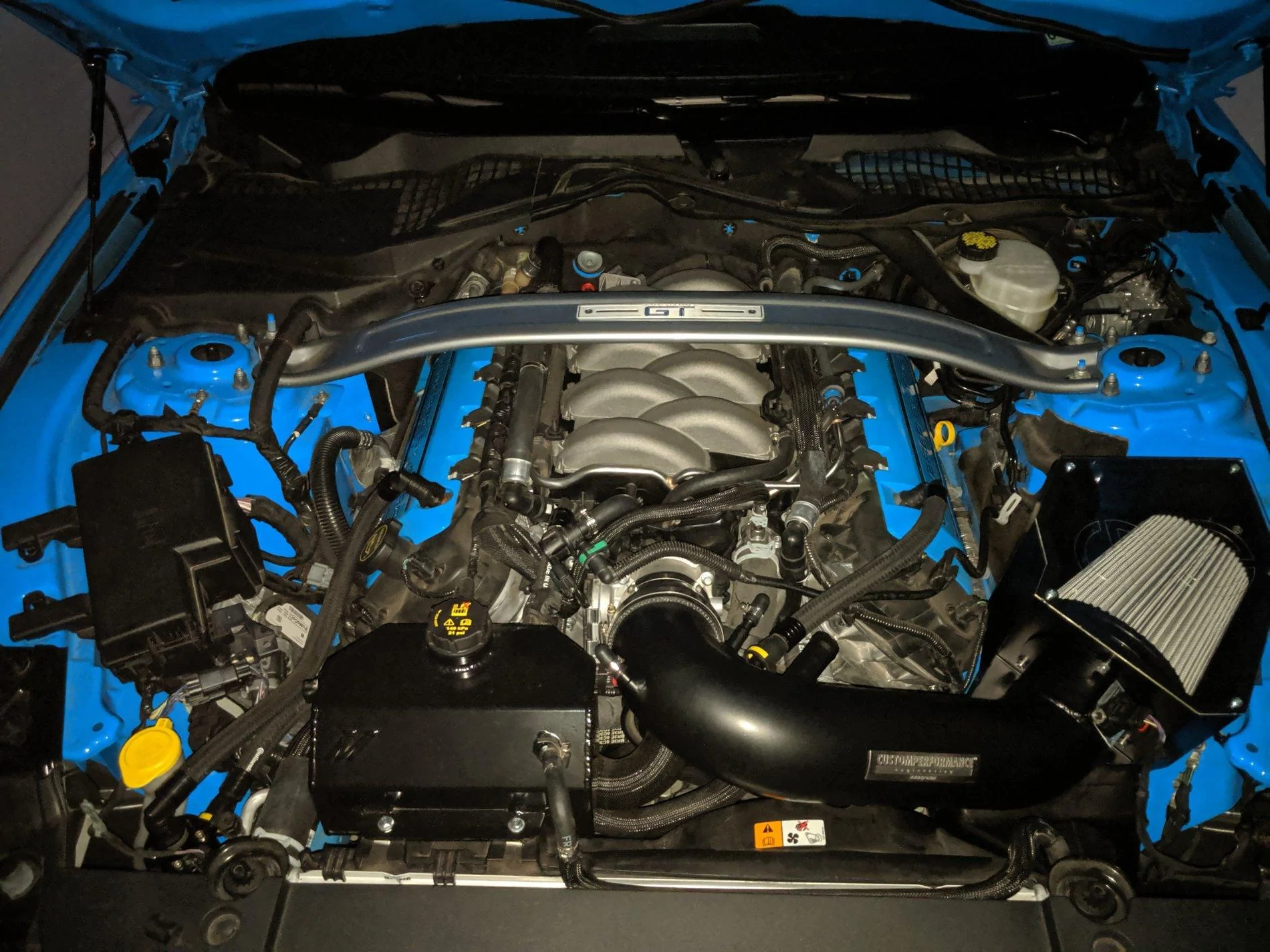

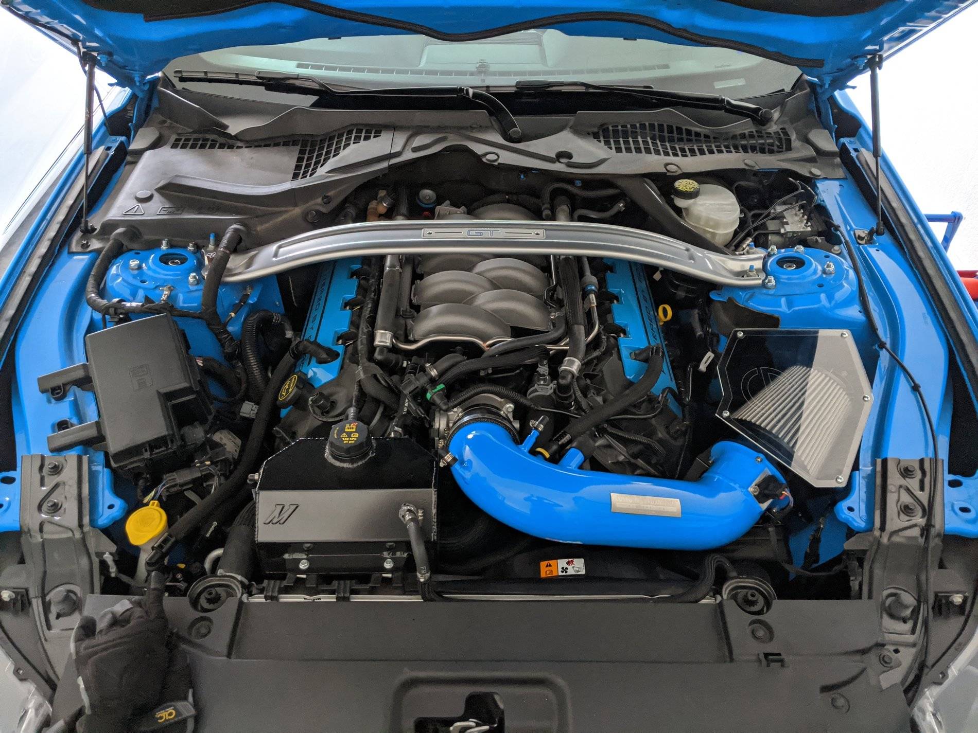

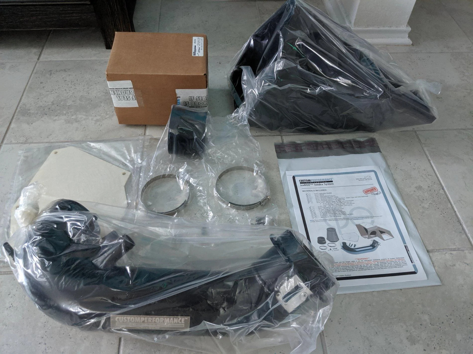

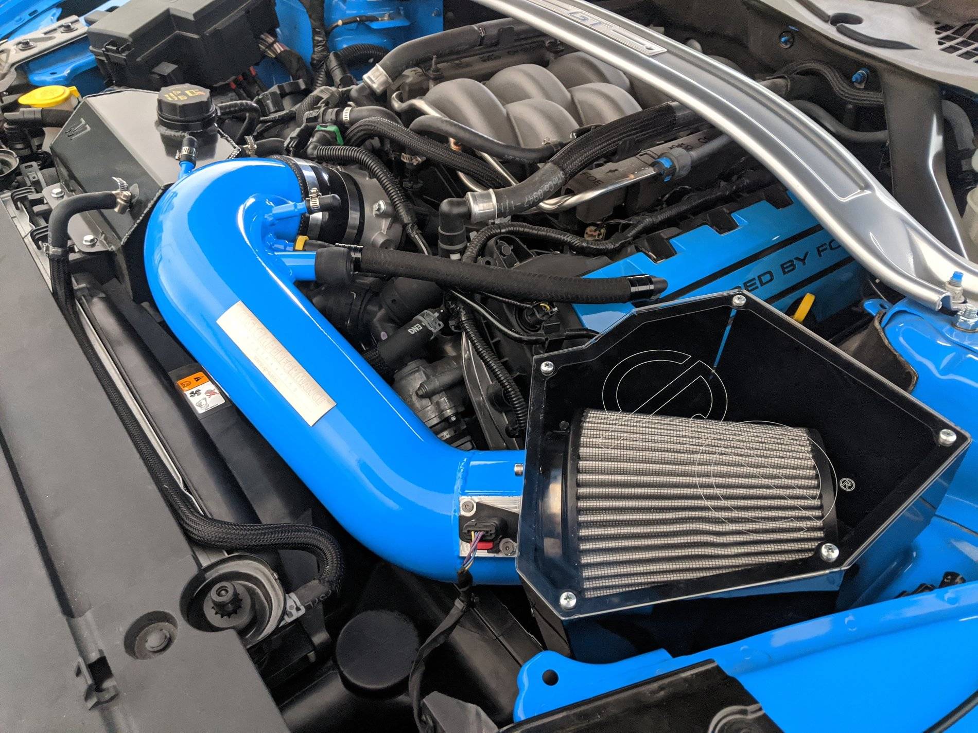

Well, I decided to try something really different and went for an option I have not seen people try yet. I just installed the CP-E Icebox with a dry flow filter that I got on Father's Day weekend (Thanks @LethalPerformance for the great deal!) for my car and I have to say, it was super easy to install compared to others. The intake was packed well and in a pretty large box. The stainless steel box is well constructed, but has a couple minor gaps on the edges of it which are only a few mm wide on the back of the air box. Guess we'll see if that affects IAT's. Instructions were okay, but not super specific. The video Bill did at CJ Pony Parts was better overall for visuals.
Fitment: Excellent. It's designed to work for 2015-2019's and mine fit just fine to my 2018 manifold. You'll just have to cap off ports you don't use on your own.
Pros:
- Closed box.
- Dry filter option.
- Aluminum MAF housing, tubing, and stainless steel air box.
- 110 mm MAF tube.
- MAF curve provided by CP-E.
- Looks incredible.
Cons:
- Very small gaps in the air box.
- No sound tube delete plug.
- Have to plug a vacuum line for 2017+ models.
More to come as I am waiting on a tune revision from Lund for Flex Fuel and E85. This is a tune required intake. I really hope for a stable MAF, but I believe it will be fine.

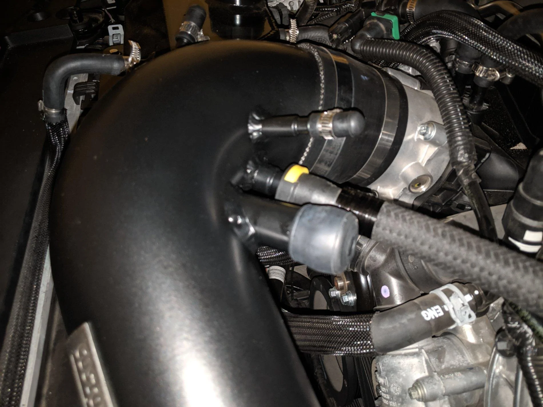

The vacuum line connections look terrible. Aluminum is a bad choice for maf housings (unless it's for forced induction). I'd 100% take the stock 18 air box over this. Good luck OP
I wish there was only one plug for the intake with everything else deleted. They just kept one design to work for 15-19.

Update: I got my revised Flex / E85R tunes. Granted I have 93 octane in the tank, here's what I got so far from a short drive.
1. Intake temps are 3-5 degrees above ambient. The stainless steel box and aluminum MAF do not cause temps to rise fast.
2. My alch learn flag went to 1 after about 10 minutes total. I struggled with this on my last tune with the 18' JLT.
3. No stalling. I tried to replicate the issue how I did before and I had no rpm dips.
4. Smoothness. Pulls up to 7800 feel great. So far no driveability issues.
Now how much of this could have been the tune being better? Highly possible. Either way, this intake is working for me and I am liking it so far. Once I get E85 in the tank and get a few WOT pulls logged to check, my next plan is to head to the dyno.

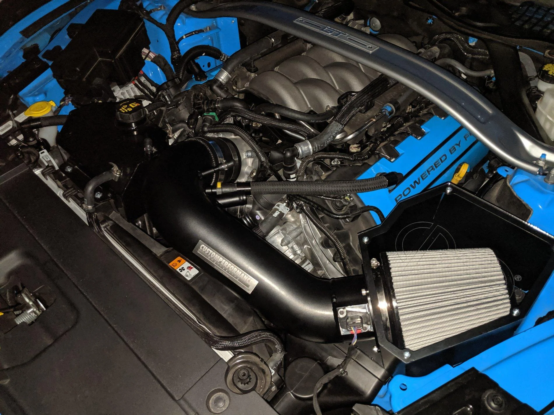

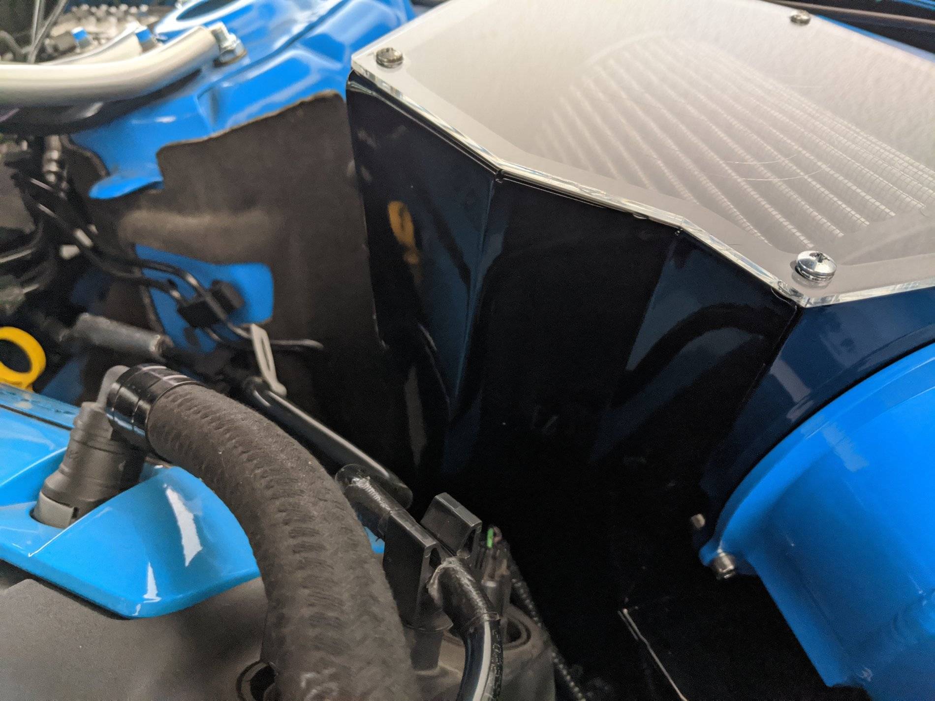

Powder coated grabber blue and the air box gloss black. I had to glue the badge back on. Really great job by Enigma Coatings in Leander, TX. They heat coated my headers too. They are the place to go in central Texas.
I decided to customize this one because it's the best one I have tested to date. I do have the stock 18 setup which is also great too but that little extra bit up top is nice with this one.
