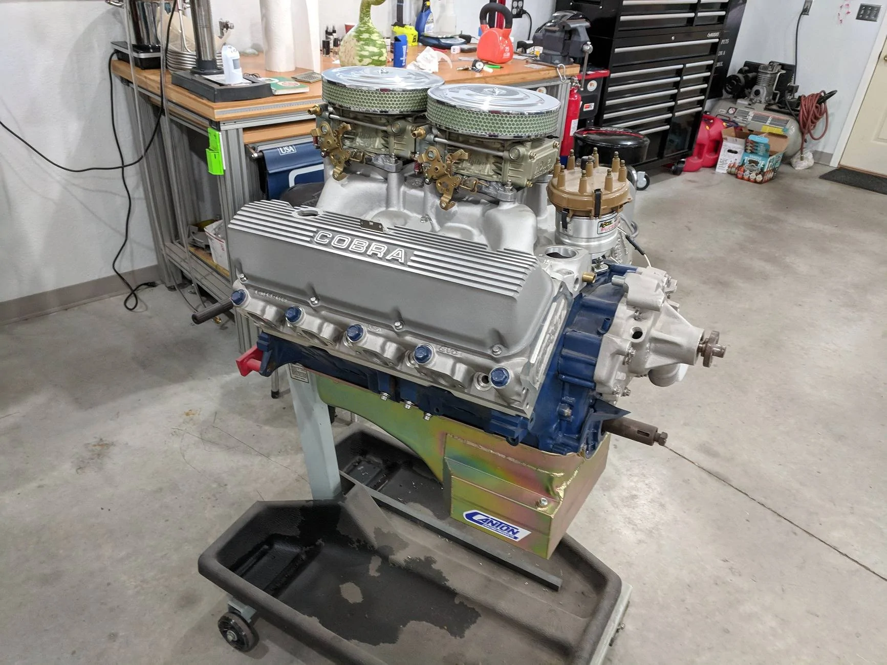

This was supposed to be going into my brother's FF Cobra replica until he decided to go Coyote. Coward.
