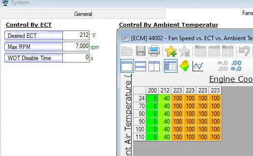

It's funny/strange the fans will not engage on their own, but will once the A/C button is pushed. And then stay on for a time after turning the button off. Like you need to jump-start the fans. While that activity is weird, it does show the physical and electrical connections from the Powertrain Control Module (PCM) to the fans are OK. That the fans are OK.
So the fans will come on when the button is pressed, as they should. But won't come on by themselves. And the temp gauge is giving you a reading, so the Cylinder Head Temp (CHT) sensor is working.
I cannot offer ideas as to how to get the fans to work on their own. But as they are related to the A/C system and we know it has problems, I feel the A/C needs to be fixed first. Remove that faulty area and get it working right, then see how the fans act.
I also lean to the A/C from a cost perspective. While you can at least get the fans working, the inoperable A/C could be due to a leak. If there is a leak, the longer the internals of the A/C system are exposed to outside elements, the greater the risk of internal rot and damage. And maybe along the way, the fans will begin working correctly or the tech will see tells leading them to that problem.
I'm attaching a pic of temps (in F) when the fans would normally come on.
ádh mór :please:

Don't just "top off" the refrigerant. Have it evacuated and put into a vacuum to test for a leak. It does sound like you have a leak and the first generation of S550 were prone to evaporator leaks, something the dash has to come out to repair.
Still, that should not prevent the fans from coming on. You gave head temps but not coolant temps. I would expect cooling fan operation to be linked to coolant temps not cylinder head temps.

@ORRadtech I'm only going based off of what I can see on my dashboard. I know the Coolant temperature is the needle on the bottom left which never moves further than the half mark even if the Cylinder Head Temp is higher than usual.
I read another forum about Coolant Temp vs Cylinder Head Temp which would mean that the most accurate way to read temperature whilst driving or sitting in traffic if I'm not wrong. However they did say that there is a Radiator Coolant temp which I'm guessing could be read through plugging in obd?
