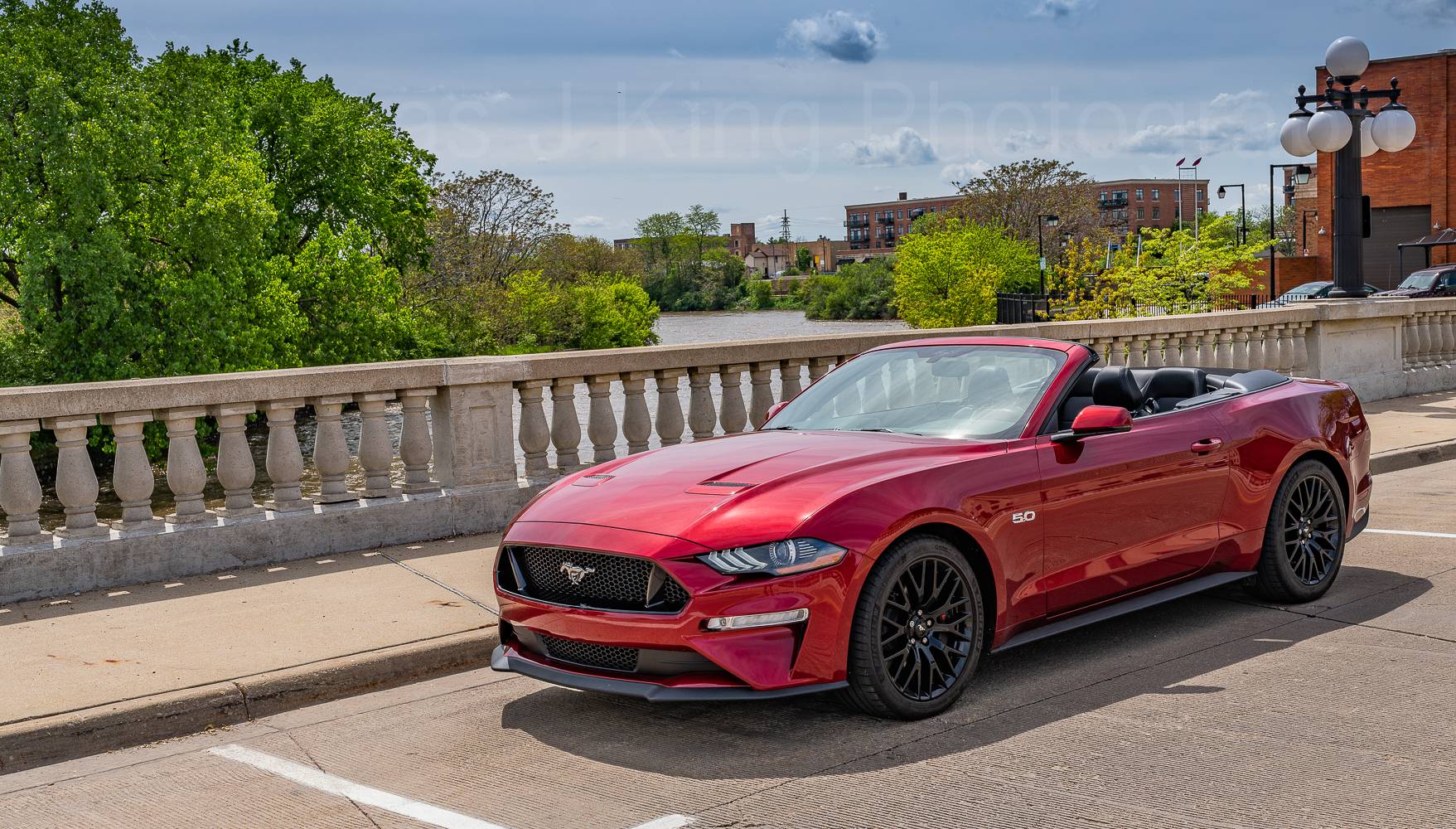

Beautiful photo, but is your top cover not snapped down? Looks un-flush with the folded top and trim plastic. Mine really have to be pushed down firmly, or the foam underneath won't squish together.
That is as far down as mine will go. They are not flush but I haven't had an issue.

I read somewhere on this forum about changing them for 2019, which mine is, because of issues involving the plastic rubbing on the fabric.
On page 3 of the Mustang Convertible section look for this section. It is pretty informative.
Check your roof for damage; new tonneau caps required

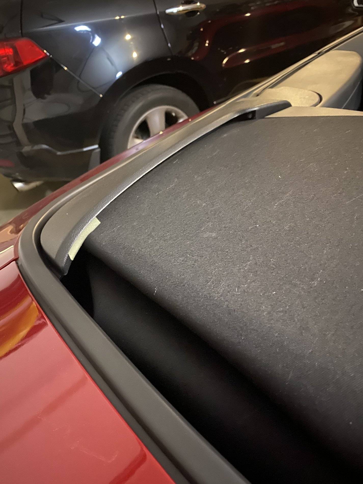

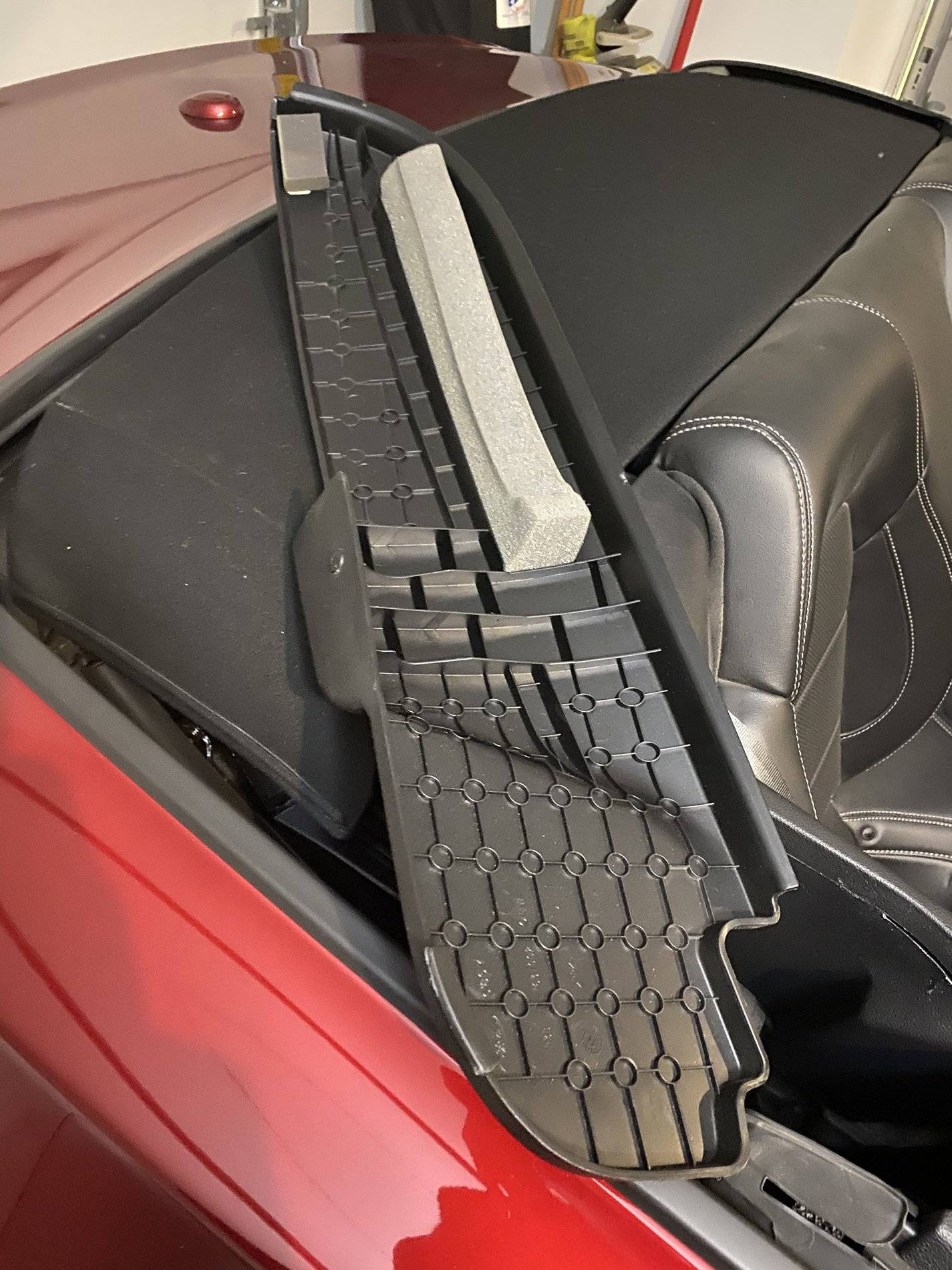

Yeah, the caps on my 2020 don't lie as flat as the ones on my '16 - I put them on for the first time this morning and noticed that.
There may be a happy medium to be found by trimming the foam padding down a little bit without going all the way to exposing the hard plastic that rubbed against the canvas.
