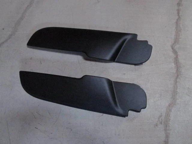

Got these cover panels
from Fleabay. Did not come with any instructions. Trying to figure out how this gets installed. Just now noticed listed for up to 2021. Mine is 2022. Maybe there was a change? Anyway, was just trying to make a smoother look and hide that gap when top is down. Any help is appreciated. I sure someone will tell me to throw them away.

Donā€˜t know of there was a change; but on my ā€˜19, they fit over the gap exposing the mechanics perfectly. Just lay it over and snap in the tabs. If I get a chance I’ll over it up and take a pic… but did find this one if that helps.

No change. I install mine by placing the small tab to the inside in the slot and twisting the outside edge underneath. You may want to check to make sure that you purchased late covers, the early ones have some edges that will damage the top material.

Hello, they will fit your 2022, first production of these covers gave Ford a lot of trouble with convertible owners. They did not have any or enough foam on the bottom of the cover and rubbed on the top while driving, creating fraying, worn material and chaffing in that area of the top, early on, some owners were able to get Ford to replace the convertible top under warranty, that, however became costly for Ford.
Second production from Ford ( same cover ) added extra foam on the bottom in that area that was causing the problem. Still some owners complained that the fix was not perfect and still causing some discoloration from friction on the top. In 2022, I believe Ford made this an option and the covers did not automatically come with the car so as to avoid complaints.

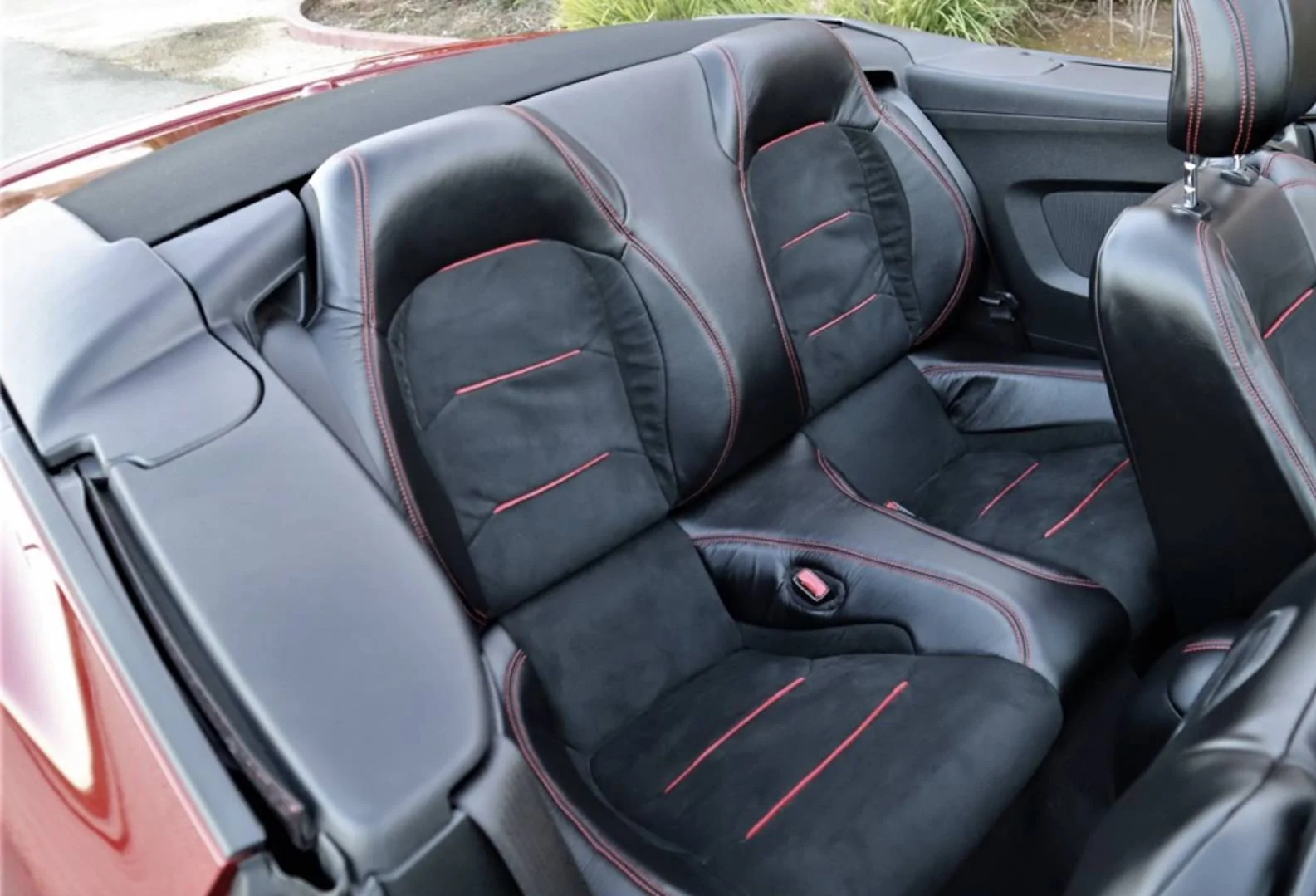

Here is a picture installed with the second generation covers.

Thanks for all the replies and pix. Finally got it figured out.

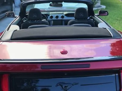

Boot? That's not a boot.
This is a boot.
https://www.ebay.com/itm/Mustang-Convertible-Top-Boot-Padded-with-Snaps-1967-Black-TMI/181640171092
Took forever to put those things on. A dozen or more snaps, and if it wasn't warm outside, all the more fun trying to stretch it over the top well.
Even my last Terminator had one of those. I laughed when I found those side panels in the trunk when I bought the car. Then again, these tops fold so the outside of the top material faces up. You really did need to use the boot on the older ones if you wanted to keep the inside of the top from sun damage.
