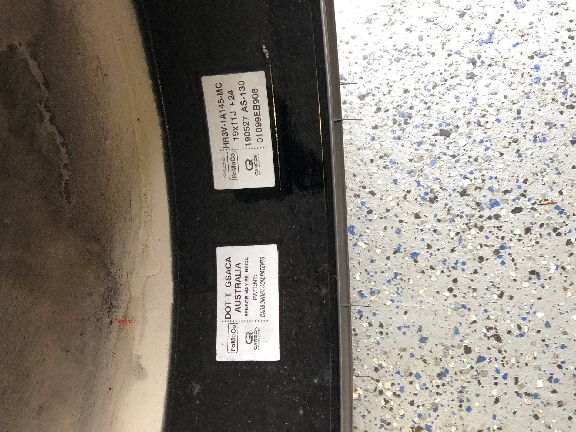

The front carbon fiber wheels are coated on the inside rims to protect them from heat generated by the brakes. Easy to spot and feel. It is a rough coating.
Here's a picture of a front CF wheel, the ceramic coating is white unless they have a lot of miles. They will also has a white label inside each wheel.

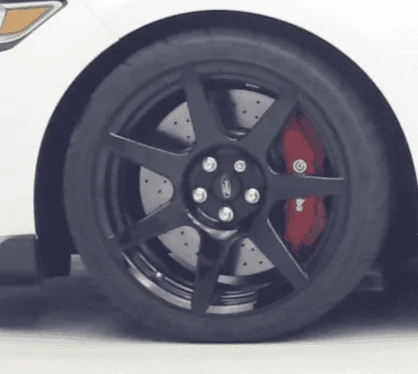

This is the best picture I have at the moment. No, I haven't seen the car in person yet but I also haven't put any money down on it yet either. Thanks for the picture of the inside of the wheel, it's good to know about that to check. Any other things in particular I should be looking out for when I check the car out in person?

From a vague photo that wheel looks correct. However before handing over the funds, you really need to have someone look the car over and check all the details

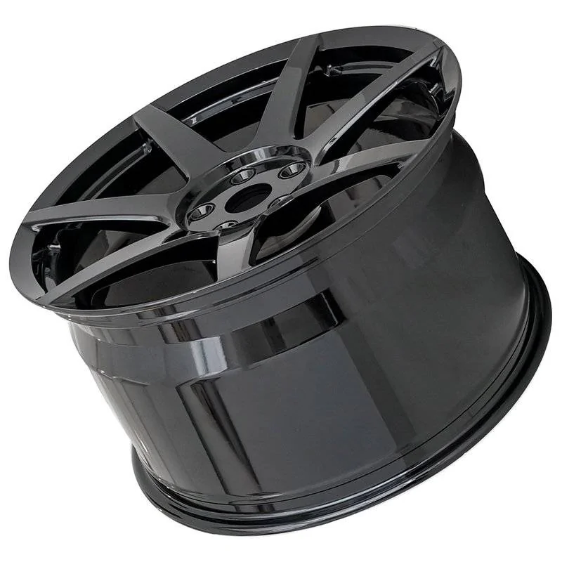

that certainly looks like the OEM CF wheel. it shows the OEM lugs with the locking lug. AFAIK there is only 1 replica wheel that retains the OEM lugs and that is the VIBE replica wheel. however, the VIBE front wheel will lack the white thermal coating on the inner barrel, it will lack the carbon revolution white labels on the inner barrel, and it will lack the "protruding" lug adapters of the OEM R wheel. see the difference in the lug mounts below...
VIBE REPLICA, which lacks the lug "bumps", see it is totally flat where the acorn lugs mount...

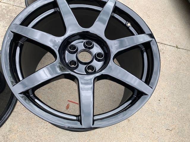

OEM R WHEEL, HAS THE LUG BUMPS...THIS IS THE FACTORY CF WHEEL...
anyway, high chance you are getting the original CF wheels. that would be pretty low-life to sell you an R without the OEM wheels.

IMHO, this pics look like 6GR wheels which are aluminum and the clearance between the rim barrel and the rotor and something like 2.5 MM i would not buy those unless they show the inner barrel the information stated above. AND just out of curiosity, where are these lists FS and how much is the seller asking?

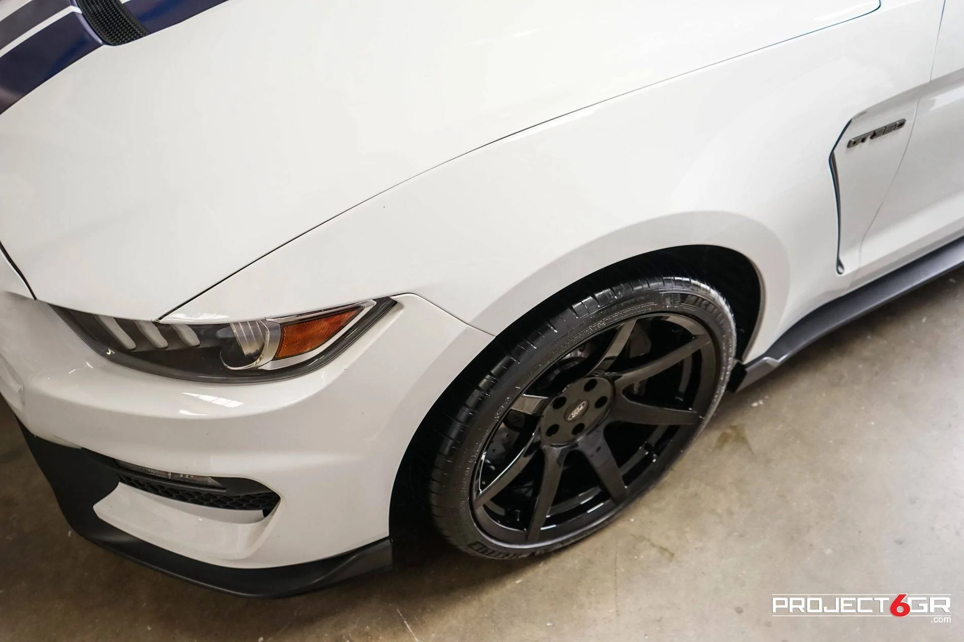

No, it does not look like the 6GR wheel. The transition from spokes to hub is flatter in the 6G and the lug nuts are recessed becuase the hub pad is a different depth. This looks like the OEM wheel from the pics. 6GR below for comparison.

With the stock lug nuts sitting on the face of the wheel like that, it is most certainly not a 6GR (like @oldbmwfan said).

Based on the picture that you have posted and aside from the CF wheels that are in question it is my opinion that the tires on this vehicle are certainly not Cup 2 tires and looks to have some replacement tires sitting on either CF wheels or something close to that.
