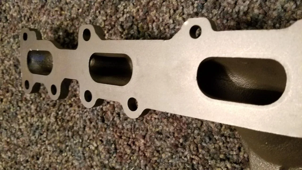

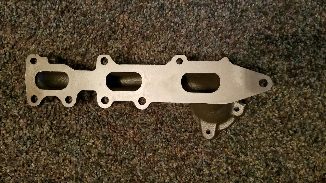

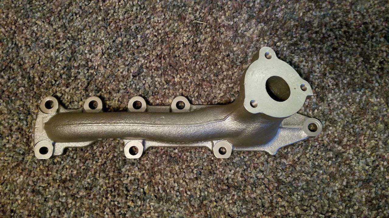

GP headers came back today and said they could do it. EB manifolds also arrived today. Terrible design and is easy to see how they can be so much of a restriction. I am hoping by the end of the month I can send them off to GP to get the custom set made. Currently I am working on upgrading/refurbishing my suspension.
