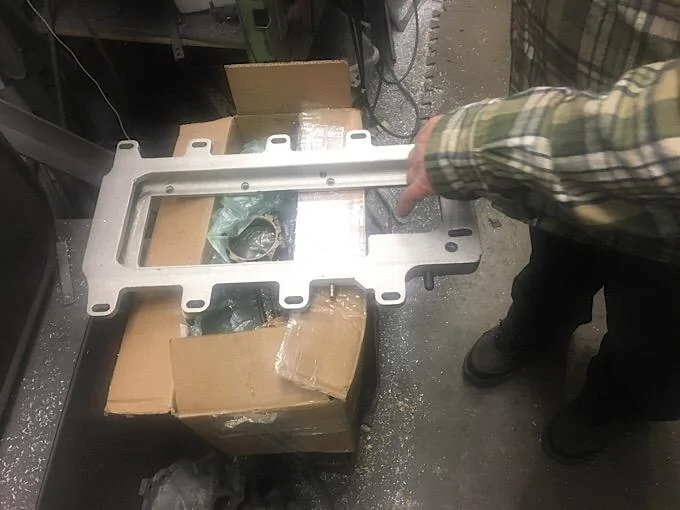

I was thinking about that too - the clearance - but he knows I own a 2017. Video is about 5 minutes long. He shows how he modifies the fuel rail bump out. Then a small plate for the larger one that the supercharger bolts on to. He has elongated holes for this so you can position the supercharger a bit. He shows me one intercooler and puts on the various hardware to run the belt (a common one you can get over the counter). It’s all there so it is real.

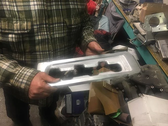

I’ll throw some photos here and the video should be up tomorrow:
No idea how I missed this on the weekend... :facepalm:
The lower plate.
Upper plate.
